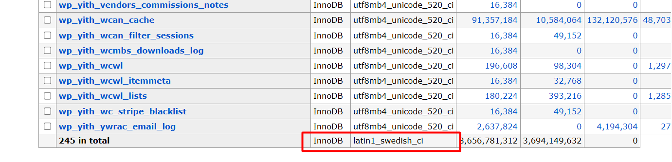

Oh, I think I may have found a clue here (check the image attached).
Can you ask your hosting about this? The tables have the correct collation but it seems that there is still a reference to the swedish collation somewhere in the database configuration. Can you ask them to change that into the other one you're already using? maybe that's what's causing the issue.

yvesB-21
yes i see that too, i am currently in talks with the support to have this sorted aswell!

yvesB-21
cloudways team have changed it to the correct one
