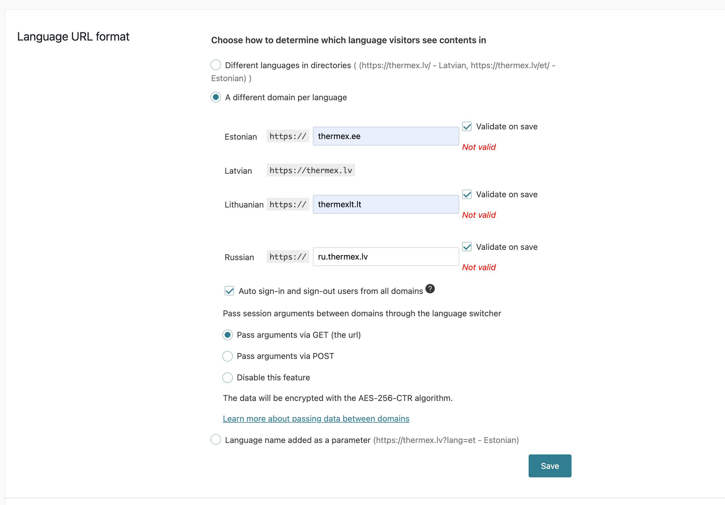

You are trying to configure different domains for each language on your site using WPML, but encounter a 'not valid' error when saving the settings. The domains include thermex.ee for Estonian, thermexlt.lt for Lithuanian, and ru.thermex.lv for Russian, all pointing to the same IP as the main site.
1. Check if the error is a false positive by unchecking the validate checkbox and saving the settings. If your site functions correctly afterwards, the error may not be significant.

August 4, 2025 at 3:39 pm #17294079
vadimP
I'm trying to make my languages work on different domains. Main site is thermex.lv. Other domains are: thermex.ee for Estonian, thermexlt.lt for Lithuanian, ru.thermex.lv for Russian. I've set up my DNS to point to the same IP as thermex.lv. Previously, ee and lt domains were pointed to the same hosting and had their own sites.
When I tried saving those settings, I get a red error 'not valid' for each language.
Do I need to change any hosting settings?
August 5, 2025 at 7:45 am #17295182
George Botsev
Hello!
The issue can be a false positive.
You can try and verify this by unchecking the validate checkbox and saving and if your site works just fine - it is probably that.
In addition, if you have static constants for WP_SITEURL or WP_HOME in your wp-config.php - this can also be the reason for the validation to not pass when you have different domain per language setup.
August 5, 2025 at 8:50 am #17295494
vadimP
Hello George,
Yes, unchecking Validate box has helped to save settings, when changing language on the site now - redirect to another domain works.
However I'm getting "There has been a critical error on this website." error and I have a suspicion that this error I see is from the old website that was hosted on this space.
Just to clarify - on the server thermex.ee still has old website files and database.
What is the correct way of setting up the server for scenario where I already had old website running at thermex.ee?

August 6, 2025 at 10:17 am #17299047
Dražen
Thank you for getting back to us.
It seems there may be an issue with how your domain-per-language setup is configured.
There should not be separate websites running on the additional domains. When WPML is disabled, you should still be able to access each domain, and they should all correctly display the same main website (from the root folder).
If this isn’t happening, it's likely due to a misconfiguration in your DNS settings.
WPML’s role in this setup is simply to switch languages and serve the appropriate language content on each domain. However, even without WPML, all domains should resolve correctly and display the default language version of your site.
Once your domain configuration is working as expected, feel free to re-enable WPML. If you then encounter any issues, don’t hesitate to reach out — we’ll be happy to assist.
Hope this helps!
Dražen
August 6, 2025 at 10:35 am #17299133
vadimP
Understood, so basically I need to make sure there are no other accounts on the server that are serving thermex.ee and thermexlt.lt website
August 6, 2025 at 11:05 am #17299215
Dražen
yes, and that those domain show same website / content as default domain, and that all URLs open when WPML is disabled as explained here:
- https://wpml.org/documentation/getting-started-guide/language-setup/language-url-options/how-to-use-wpml-with-different-domains-per-language/#:~:text=you%20detailed%20instructions.-,Testing%20if%20the%20domains%20are%20set%20properly,-It%E2%80%99s%20easy%20to
Drazen
August 6, 2025 at 11:34 am #17299273
vadimP
I deleted those domains from hosting account and created aliases for the main domain. Now all works as expected in terms of language switching.
