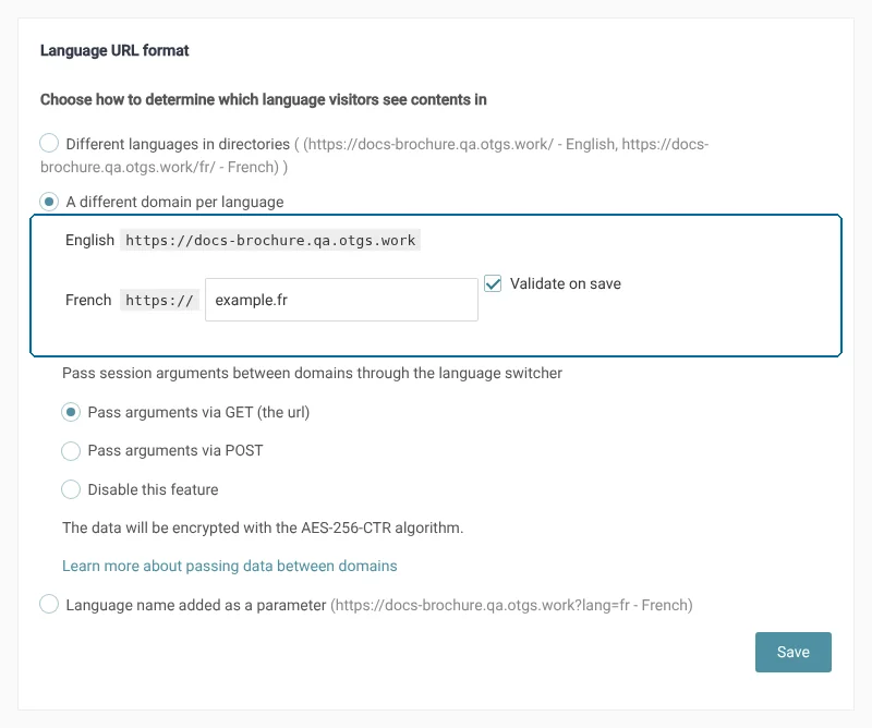

3. Set up the Option in WPML

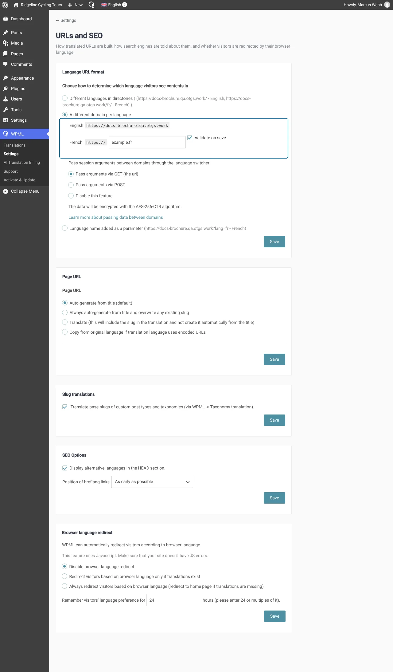

Once the hosting company has pointed the German domain to the WordPress installation, you need to return to your site and from the admin, go to WPMLSettingsURLs and SEO.
In the Language URL format card, select A different domain per language.
Typing in the domain name for a secondary language
Type in the domain name “example.de” in the box and click Save.
WPML validates the new domain, checking that everything connects. If something is not set correctly, there will be a notice about it on the screen.

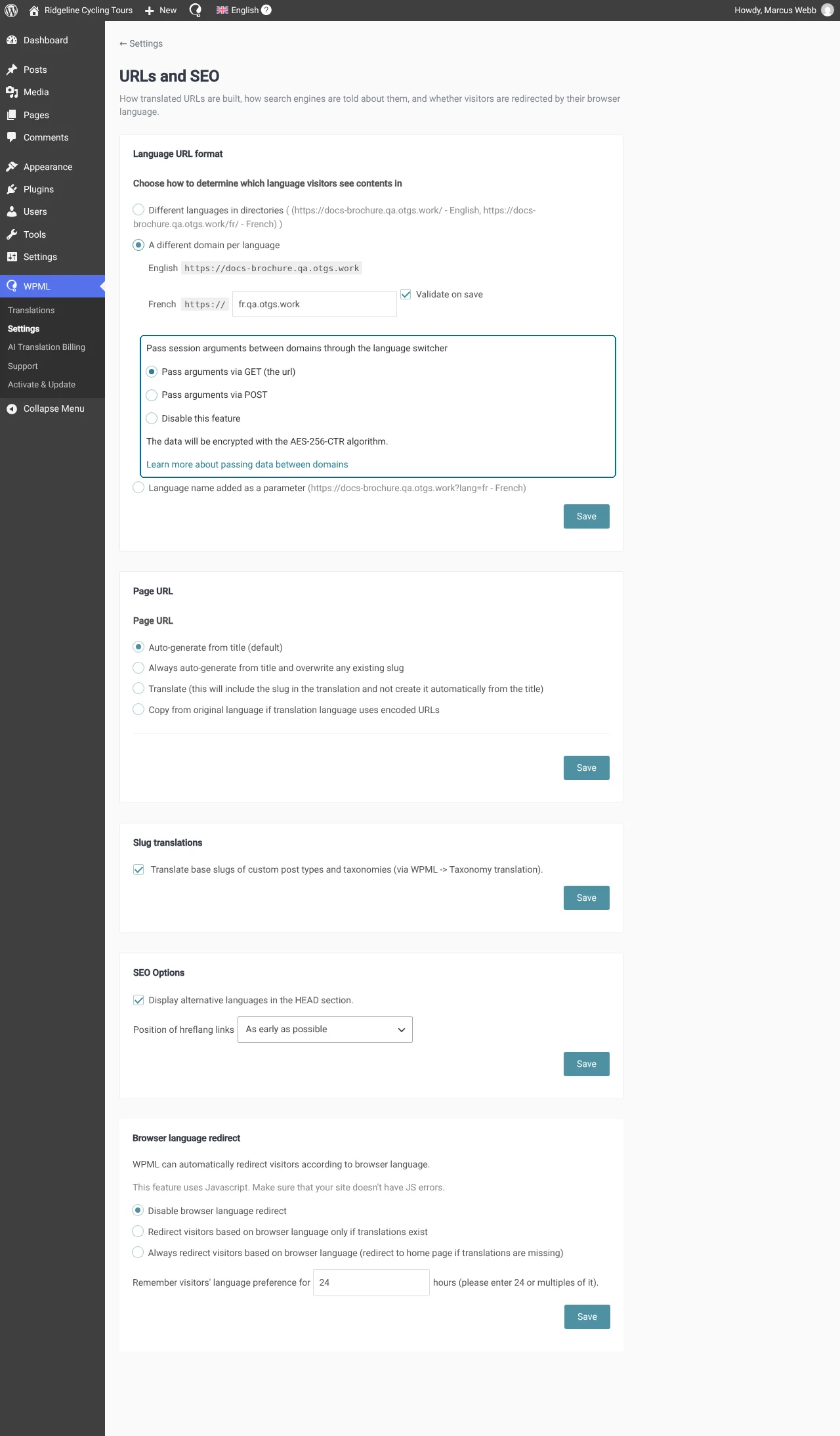

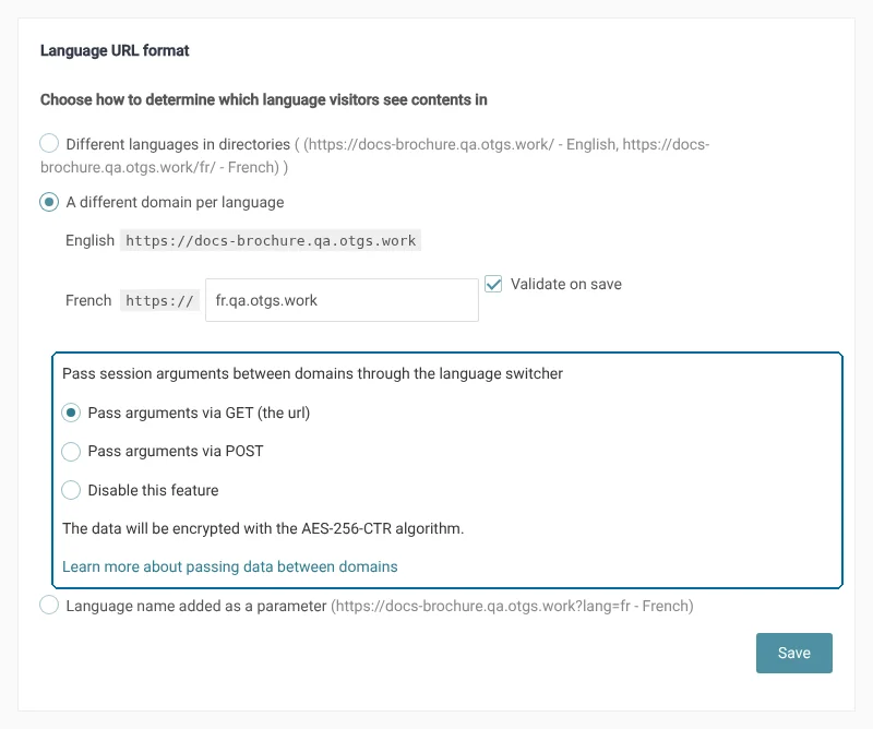

On this screen, you can also enable login sessions to carry over to other domains. If you intend on using a page builder like Elementor to edit default and secondary content, you need to enable this feature. Otherwise, you’ll get logged out when you switch between domains.
