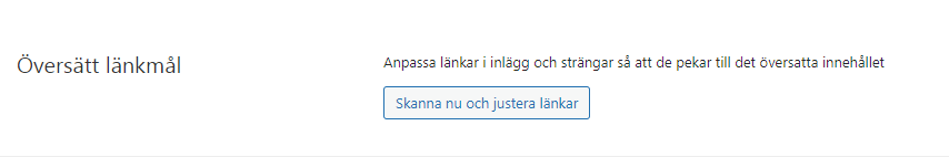

In order to make all links point to the correct translated page I ran the dedicated function for this purpose under "Settings". After doing this I saw that all the corrected links became absolute URL's. This won't work when I go live with the site from the staging to the production site.
Can you advice me how to make all links relative?

WPML will be able to translate only absolute links, that's a normal behavior. If you want to use relative links you will have to translate them manually.
From what I understand, the reason for using relative links is a migration from staging to production right? In that case you can "search and replace" domains either by doing a query in the database or by using a plugin such as "Better Search and Replace".
Please note that it's just a recommandation, this is not one of our plugin. Make a full backup of your database before.

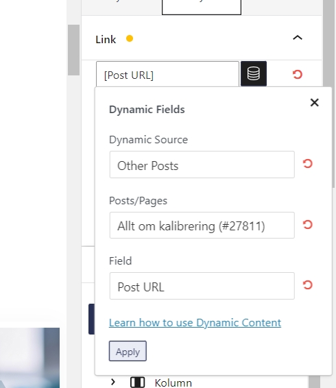

Would you be willing to provide me with WordPress and FTP credentials so I could investigate the issue directly?
I need to check how the original page is set to understand how to get this resolved. So in a nutshell, on a button (such as on my screenshot) the URL is missing the parent slug? Is this the only example or the website is affected in various locations?

I modified one of these links to be dynamic and resaved it and then resaved translation (to see if that would be an issue), but it seems to have fixed all of the URLs so it would not be about this.

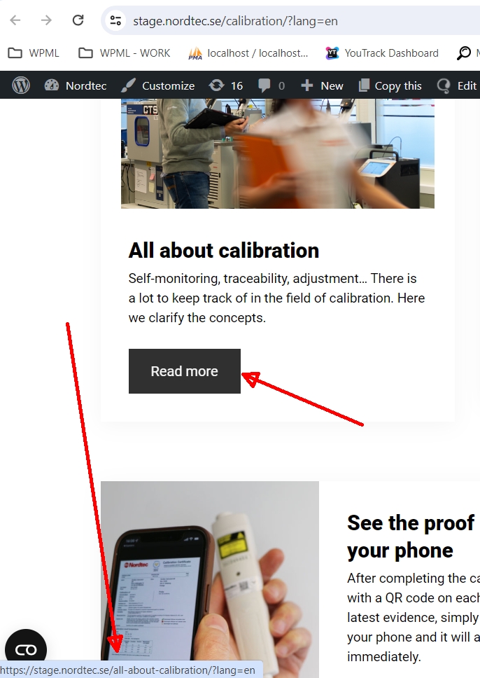

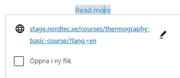

One more thing with links... On this page:
... the "Read more" link (place the mouse on the images to see the link), leads to the Swedish page.
But if you open the page in Edit mode and look at the link, it leads to the English version. I have tried the trick to save and resave, with no luck this time.
December 20, 2023 at 8:39 am #15098915
tommyJ-4
Now suddenly the links shows in English after I removed a shortcode on that page and resaved. So all good.
