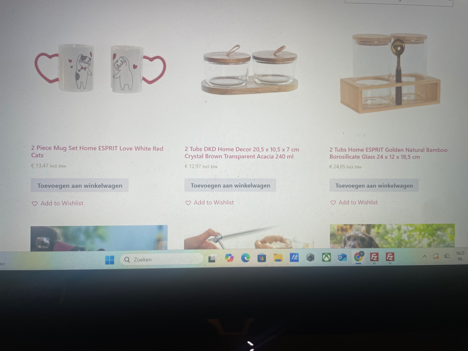

1. “Add to Wishlist” does NOT translate into Dutch
All other languages translate correctly (French, German, Italian, Spanish), except Dutch.
The string is translated inside WPML, the source is correct, but WPML does not output the Dutch translation on the frontend.
As you can see in the screenshot:
The Dutch translation exists ✔️
All other languages work ✔️
Dutch always falls back to English ❌
This is not a hardcoded string — it comes from the TI WooCommerce Wishlist plugin and should be fully translatable.
So something is wrong on WPML’s side with the Dutch language mapping.
Please check why WPML is ignoring the Dutch translation for this string and fix it.

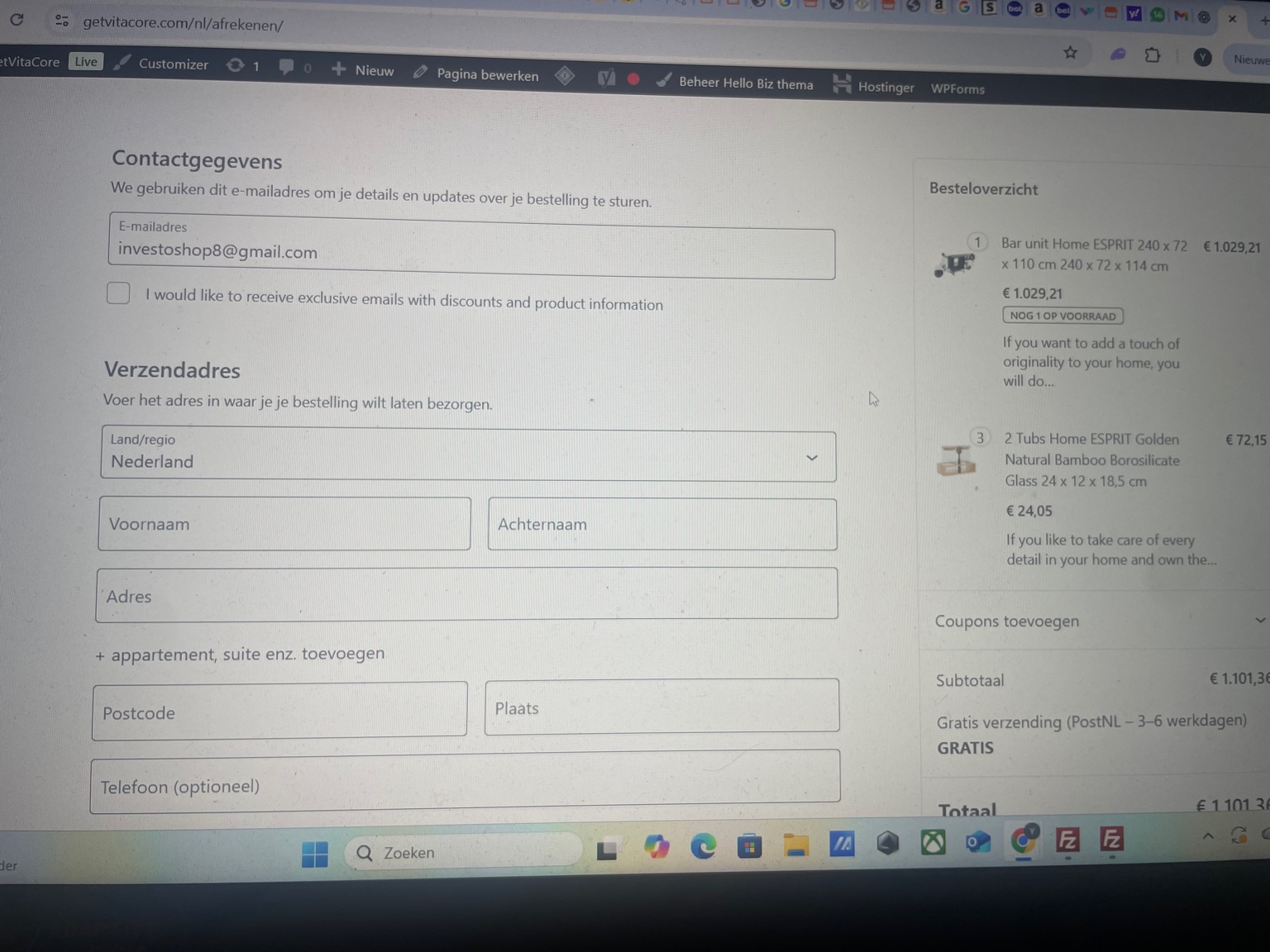

2. This MailPoet checkbox sentence does NOT translate:
“I would like to receive exclusive emails with discounts and product information.”
This text shows on the checkout page and stays English in all cases.
It is translated inside MailPoet AND registered in WPML, but WPML still does not output the Dutch version.
Again:
The translation exists ✔️
WPML does NOT display the Dutch version ❌
This is NOT hardcoded — it is generated by MailPoet and should be detected by WPML ✔️

1. This is happening because the string is set as Dutch, even though it's an English string.
To Resolve:
WPML->String Translation-> Search for the string.
Locate the string and select it
Click on "change language of selected strings"
Change the assigned language from Dutch to English since the string is an English string.
NOTE: I have performed these steps and it works as expected now.

2. For the string coming from "MailPoet checkbox", I will need to further inspect and update you as soon as I have some feedback.

Everything is working great now except for one last string:
This string stays in English on all checkout pages, even though it is translated in WPML.
Could you please check why this specific string is not being applied on the front-end?
Thank you very much!

Unfortunately the issue with that string is more complex than expected, after a conversation with our compatibility team and reviewing past threads as well as MailPoet's support I can confirm that their plugin is not compatible with WPML.
Warning about this directly in MailPoet's site:
Related Thread:
https://wpml.org/forums/topic/i-would-like-to-receive-exclusive-emails-with-discounts-and-product-information/
Our own notice:
https://wpml.org/plugin/mailpoet-3-new/
