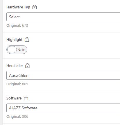

In any language which is not the default one, the translated terms are not displayed / loaded in the backend. It works on the frontend for some reason but the issue is, i cant edit anything in the translated post, because these fields then are empty / null and either it wont let me save the post cuz they are mandatory or they are null and then remove the term for some reason and some other fields are depended on the term chosen in some fields.
I attached an image for a backend post for a translation.
Software is a taxonomy / terms that is NOT translated, as these names are unique and wont change in any language.
Hersteller ( Brand ) is translated as these will be displayed on the homepage with their own site + text etc and these terms have themselves custom fields too
Hardware Typ is translated and only has 2 terms – Mouse or Mousepad, they are used for the permalink structure.
All of these fields dont have a hirachy – but i have other fields that do and there is the exact same issue as soon as they are translated
As you can see it shows the original term id, but wont add the translated term to the acf field, and when saving the post, those terms wont be added to the post, even though the original term id seems still to be linked.

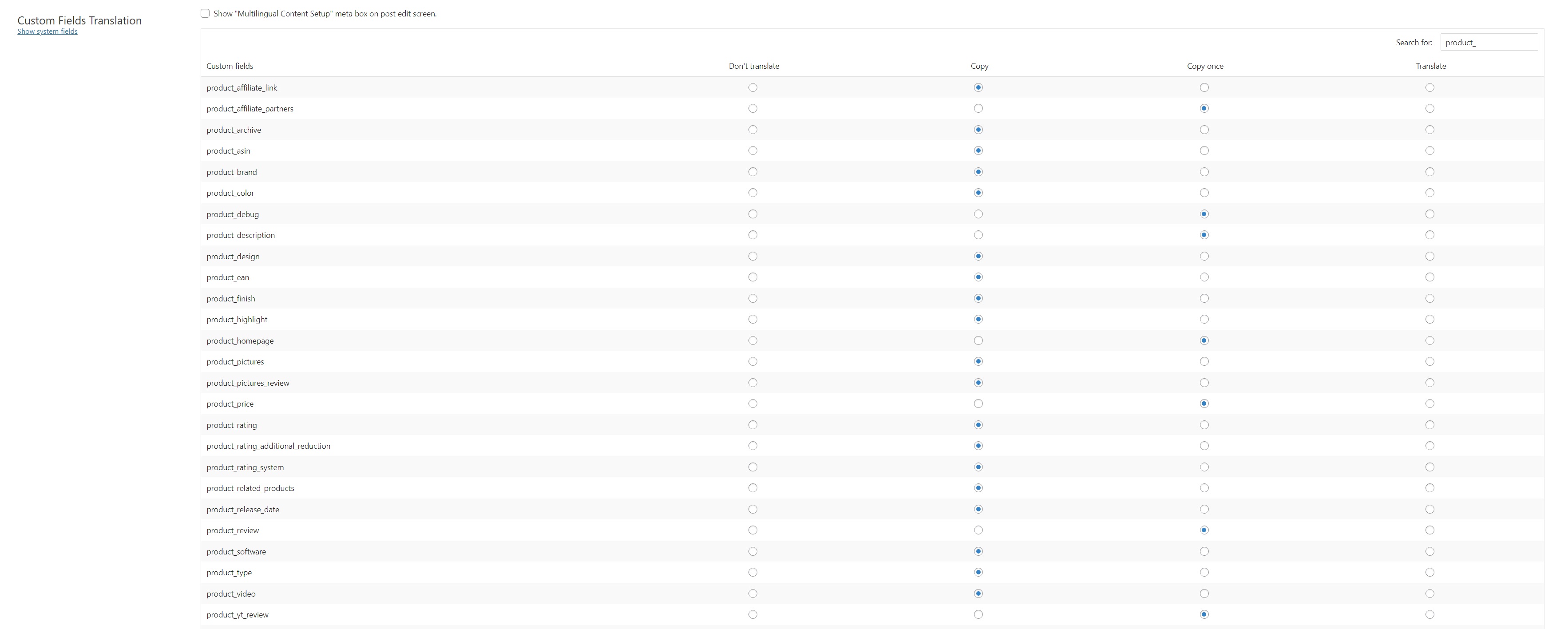

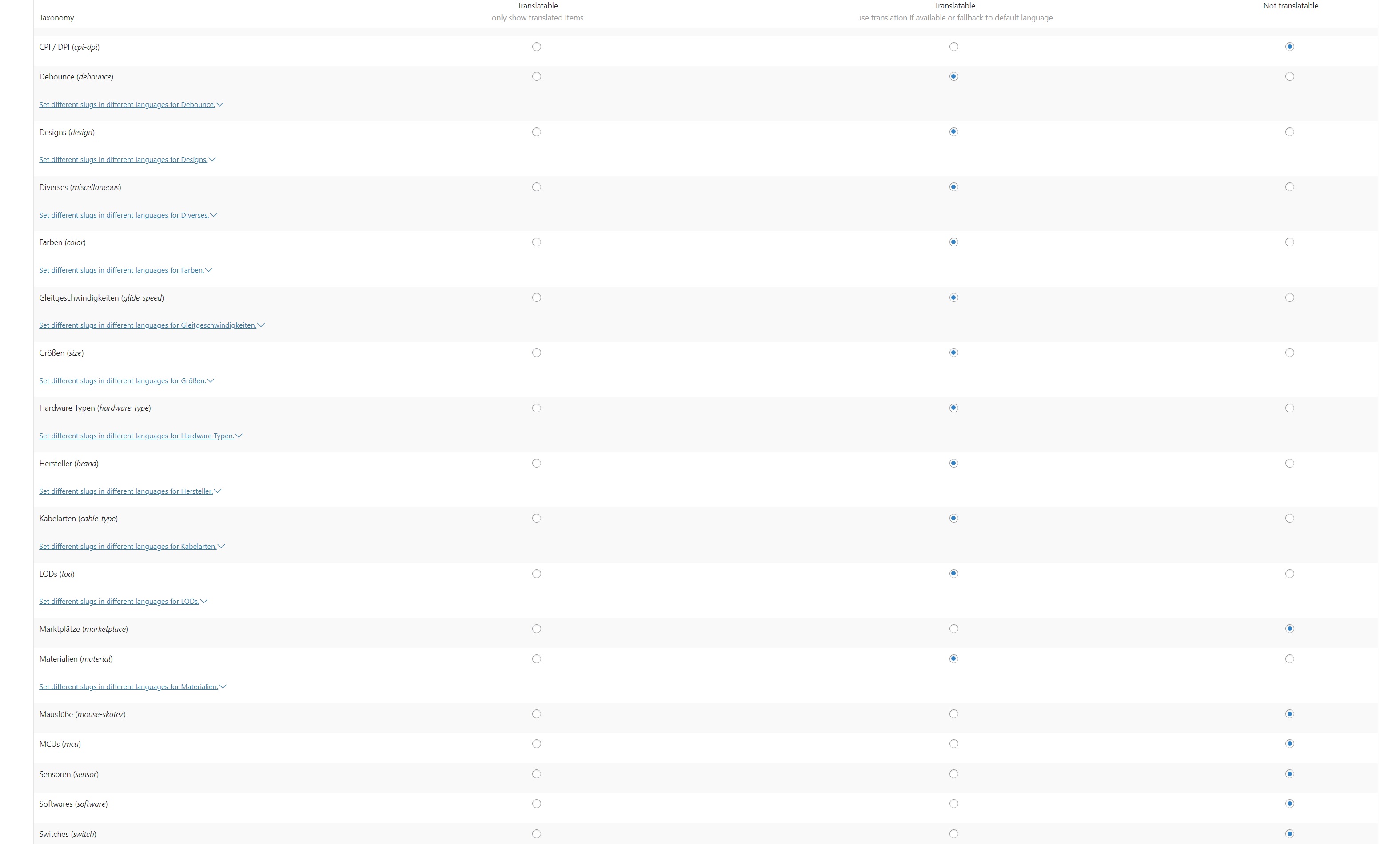

And here are 2 screenshots for the wpml / acf settings

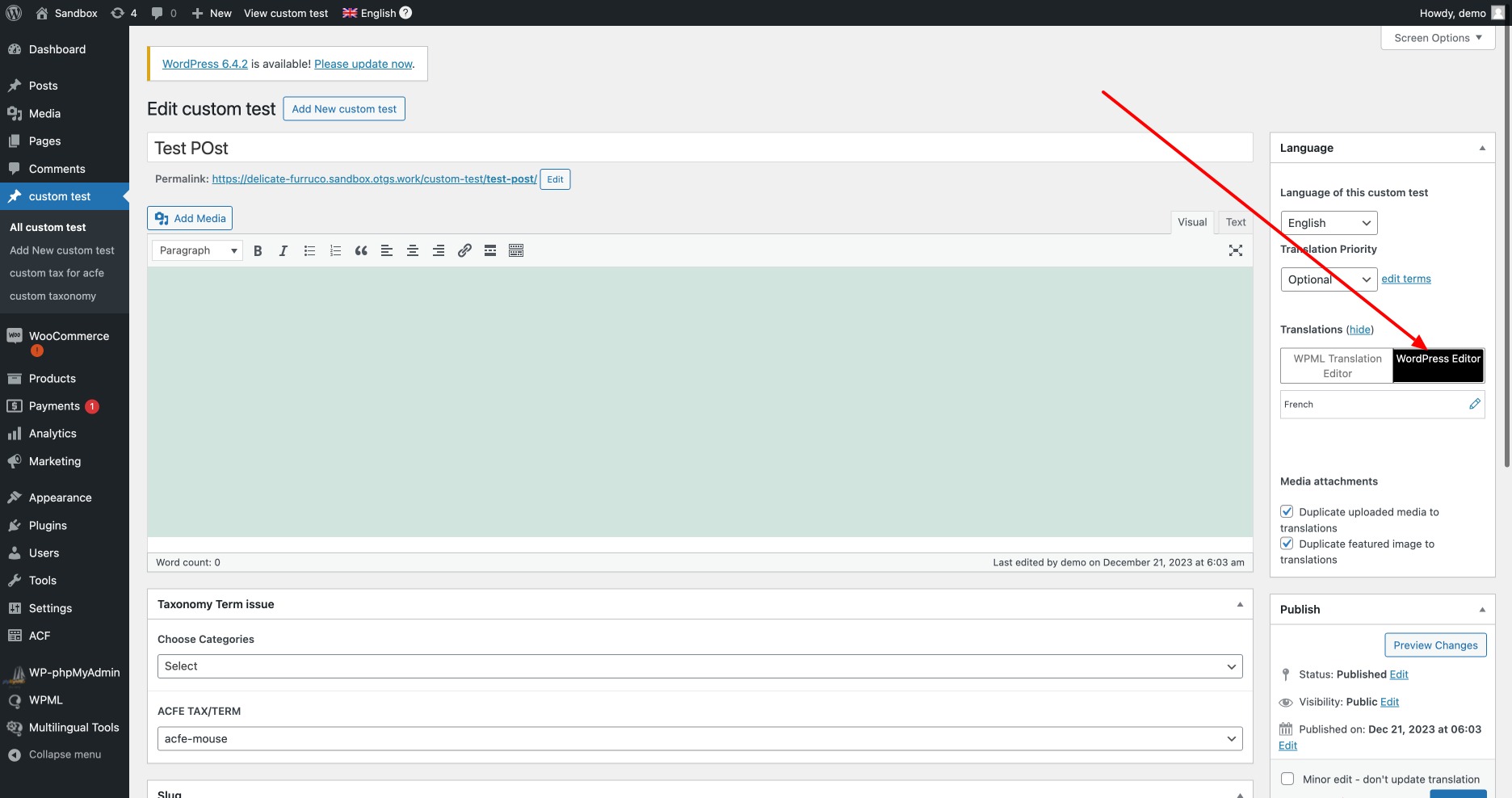

I have created a test site here with ACF pro and WPML: hidden link
I created a test ACF field for taxonomies and when I try to check the secondary post editor, the taxonomies are selected properly. You can check it yourself by using the test site.
Being so, do you have a test site, if yes, Have you tried disabling all non-WPML plugins, switching to one of the default themes, and checking whether the issue still persists or not?

If you enable the WPML editor in the translations preferences the fields are being copied, can you please? check and confirm.
You can use the test environment.
