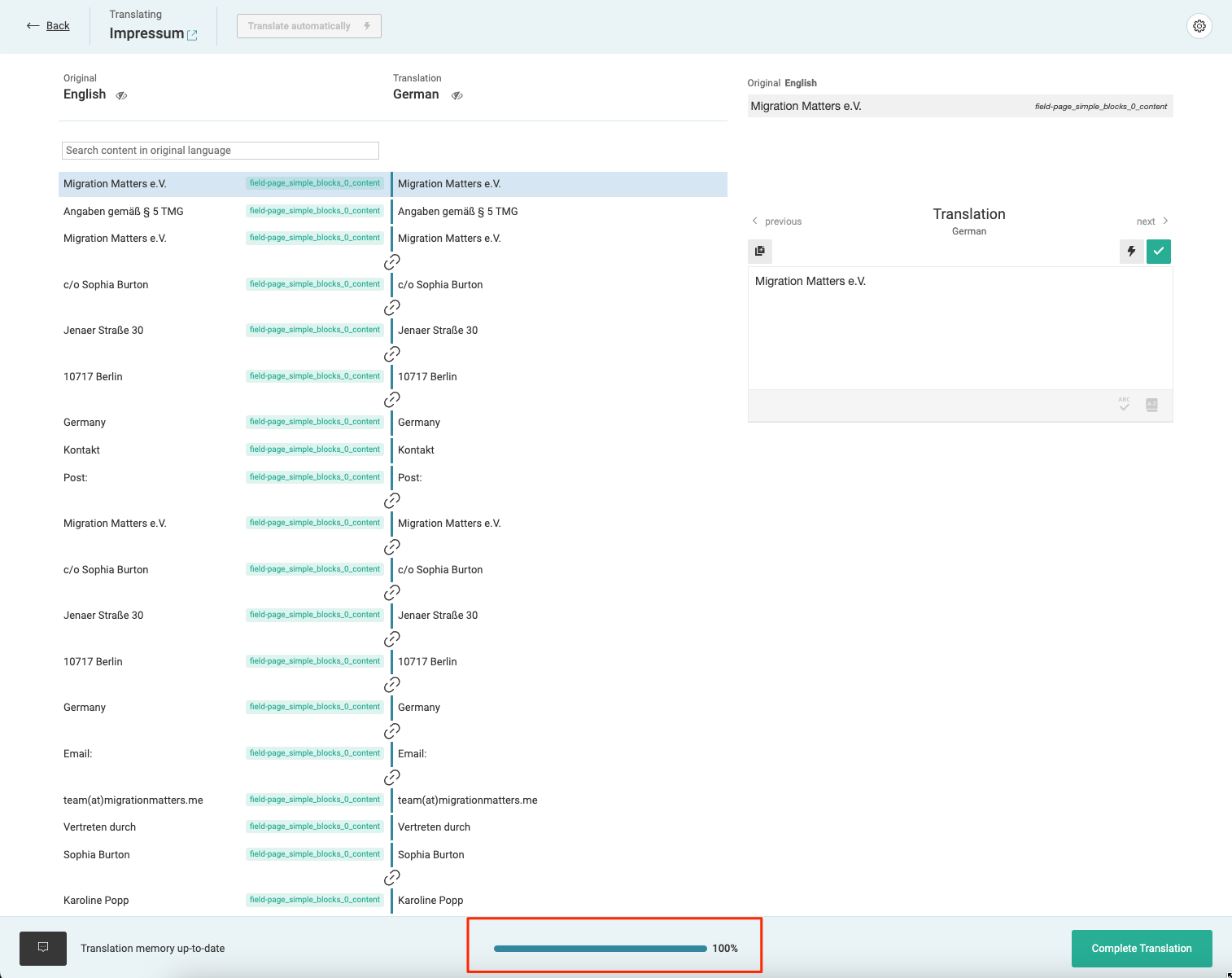

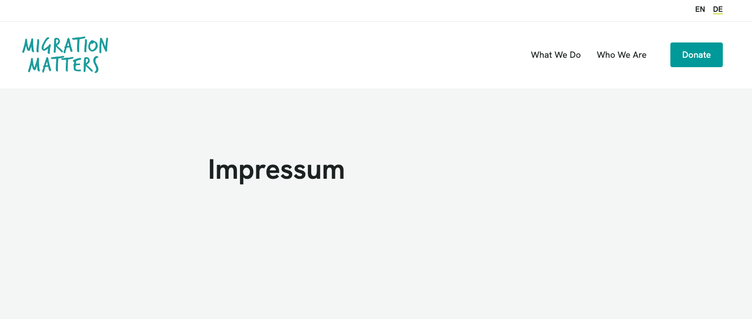

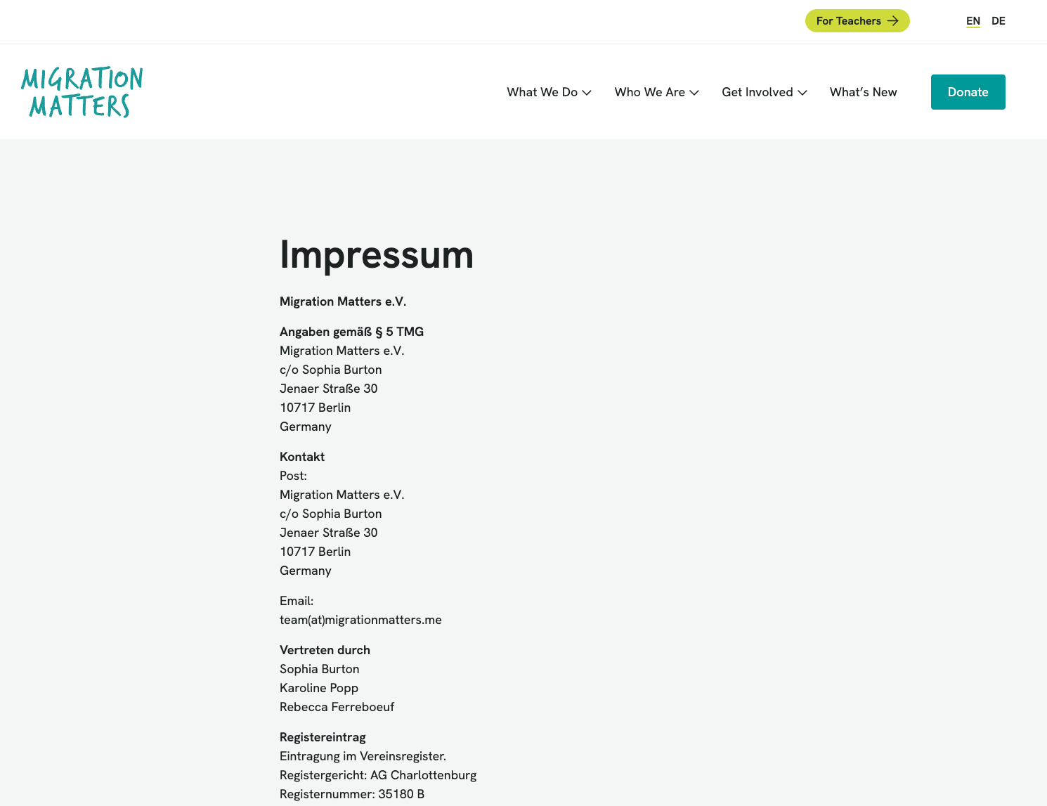

sophiaB-2
I've included some images of the completed translation and then the English page and the empty German page for comparison. My site is password protected, but I can give you access in a private reply.

I believe I have this resolved, though we are in development so I haven't had a chance to test translations on all content types/templates. If I run into additional issues, I'll submit a new request.
These are flexible content fields created using ACF written in PHP using the acf_add_local_field_group function.
I found the known issue post here: https://wpml.org/errata/advanced-custom-fields-local-fields-translation-preference-issue-for-php-registered-system-fields/ but the only workaround listed was using JSON, which isn't an option for me.
Instead I found the workaround suggested in this support request: https://wpml.org/forums/topic/repeaters-flexible-content-generated-with-acf_add_local_field-and-wpml/
