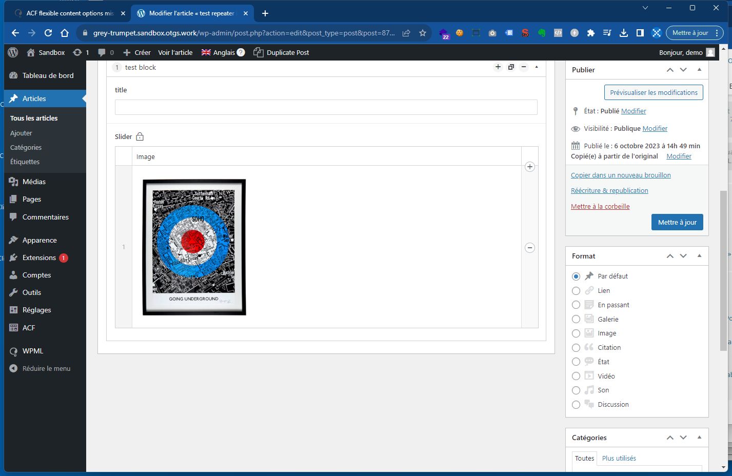

On primary language, i can edit a image in a repeater

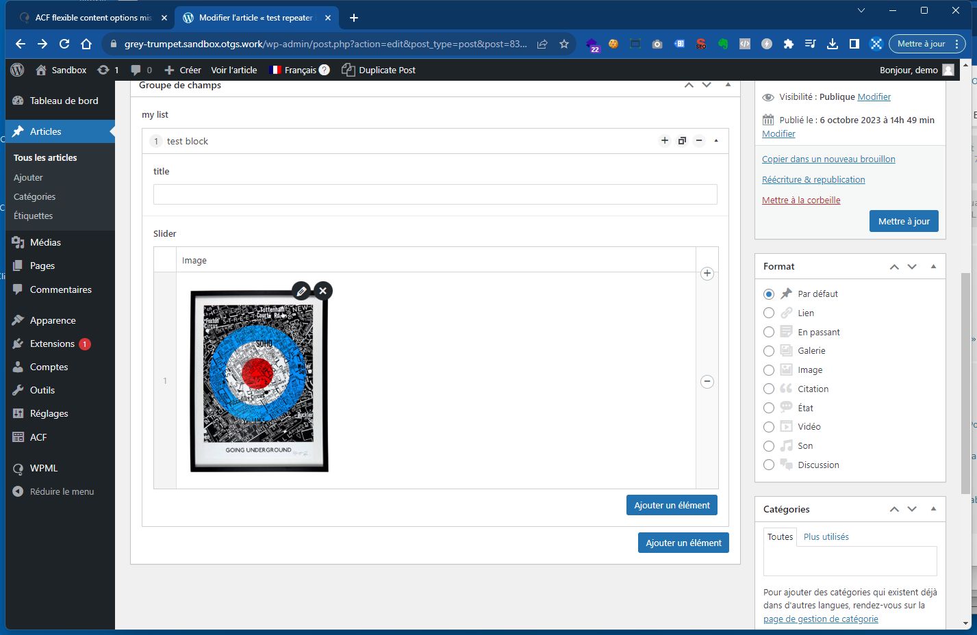

On translated language page, edition is not possible with option "translate" on image field

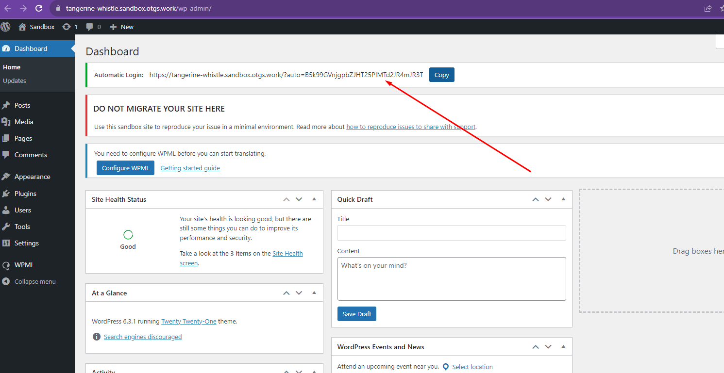

Could you share the login link in the dashboard shown in the attached screenshot?

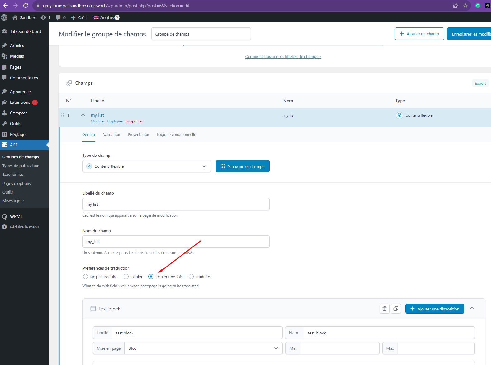

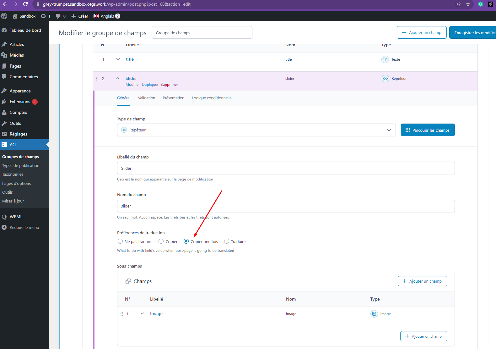

Thanks for your reply.
I've configured both the options here as shown in the attached screenshot to 'copy once' and it's now translatable. Could you check?
