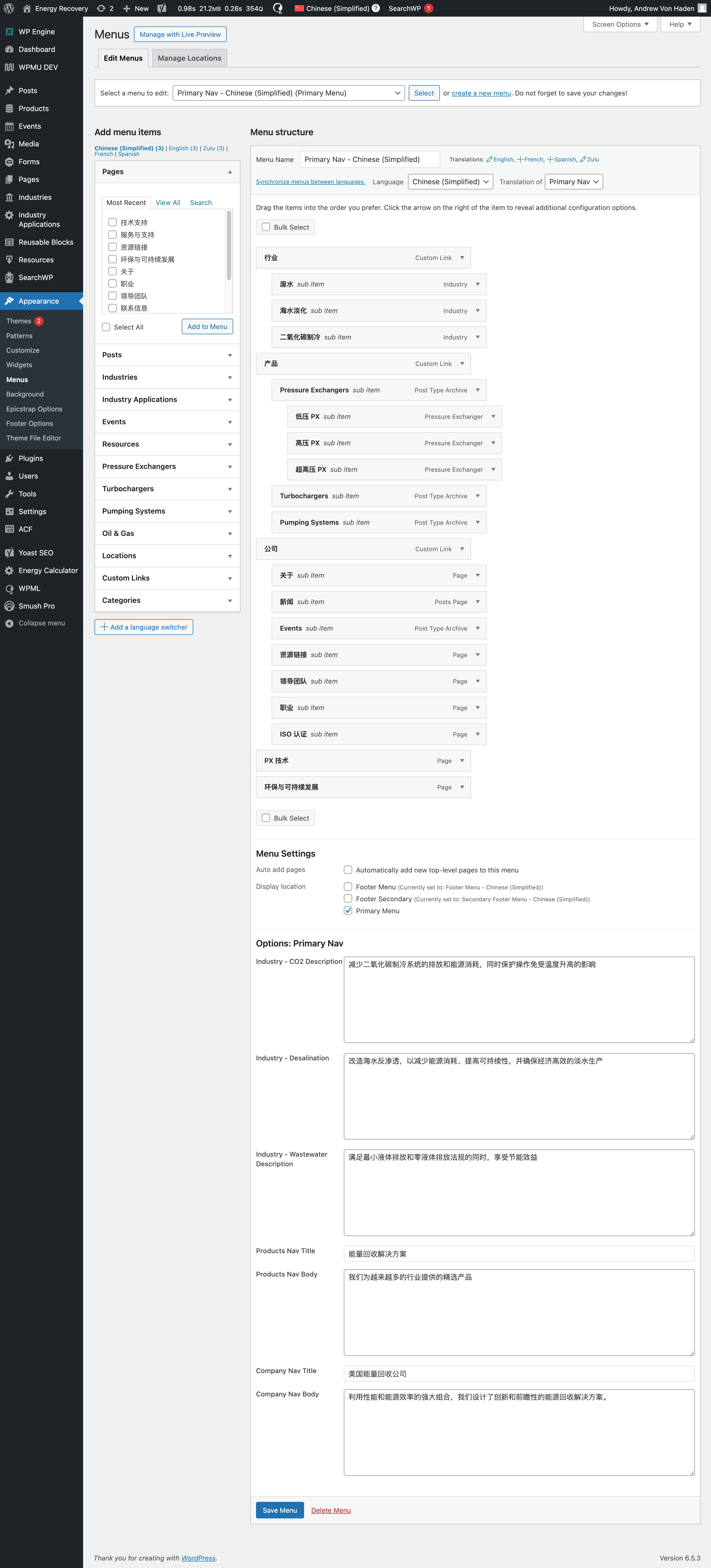

May 28, 2024 at 8:41 pm #15680941
Andrew Von Haden

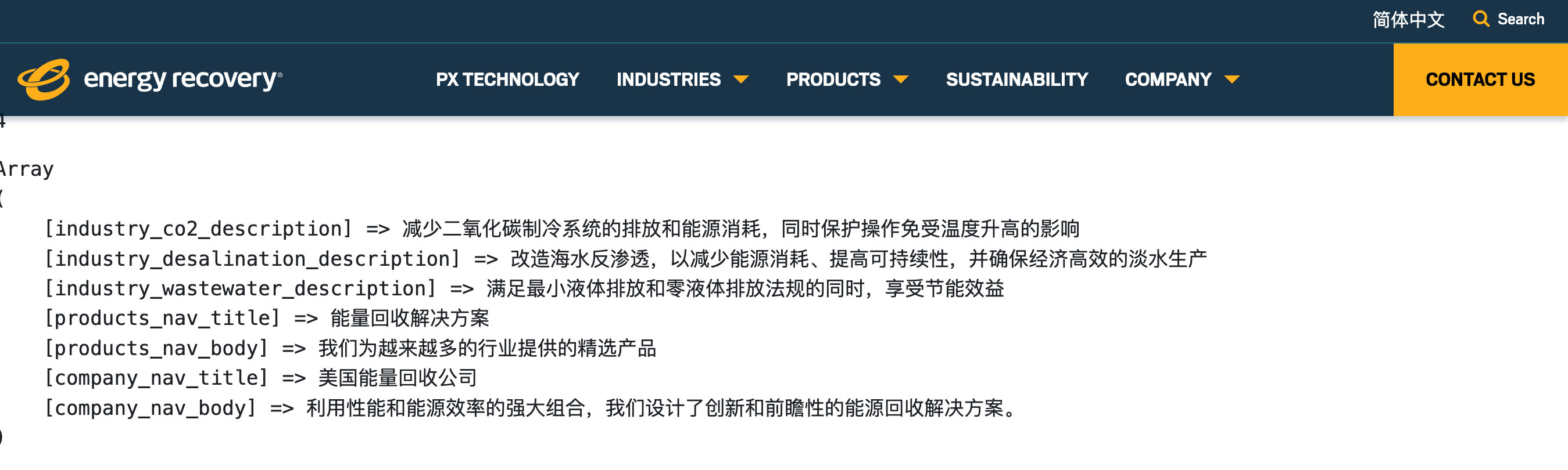

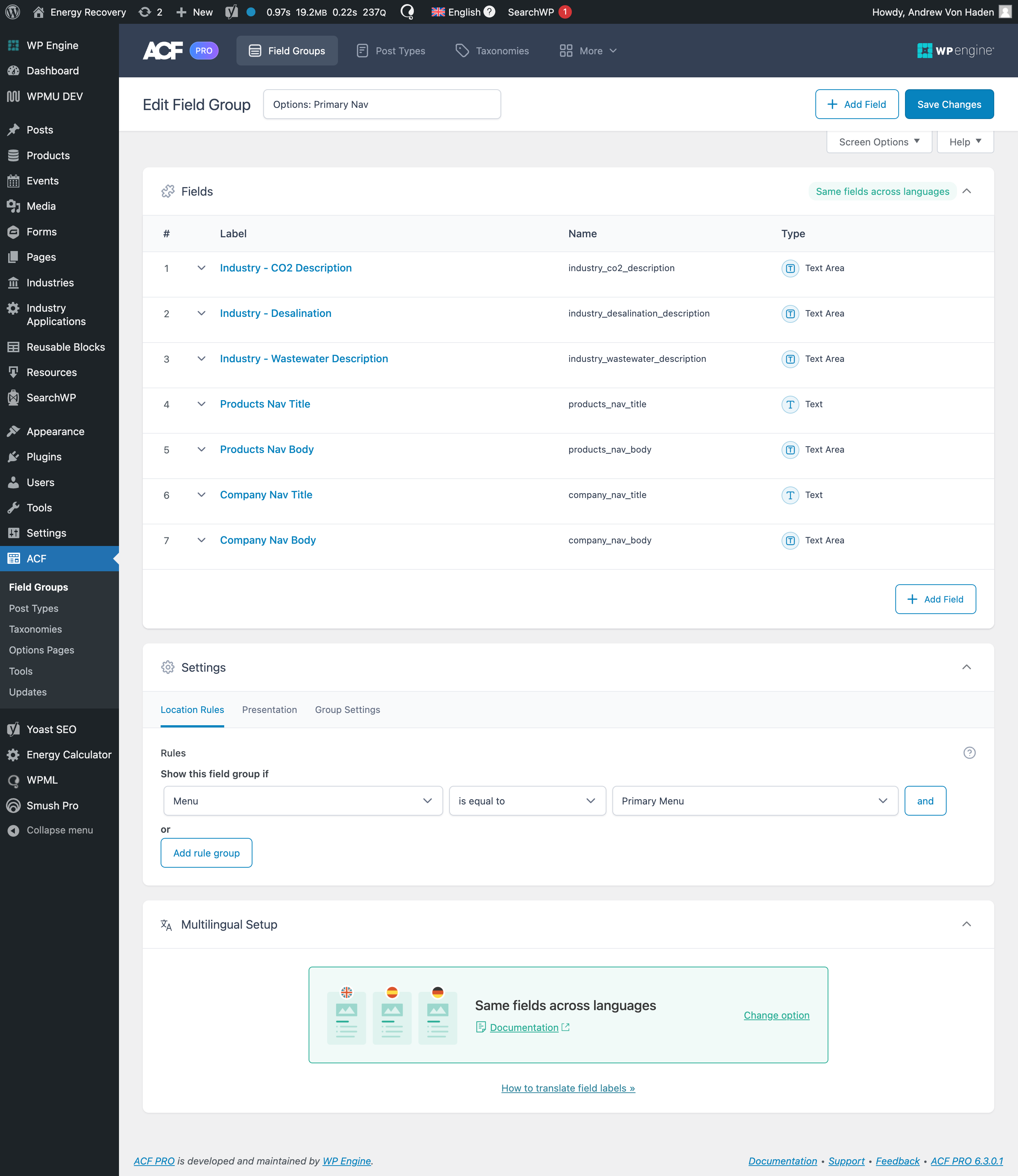

I am working on a site under development and trying to translate custom ACF fields in the primary menu using WPML. The primary menu has been synced to Chinese, and while the menu items themselves translate correctly, the custom ACF fields do not.
When viewing the page in Chinese, the custom ACF fields return null, despite working correctly and displaying data on the English (default) page.
Why are the custom ACF fields returning null when viewing the page in Chinese, despite being correctly displayed in English?
How can I ensure that the custom ACF fields are translated and returned correctly for the Chinese menu?

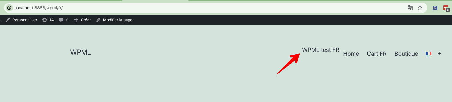

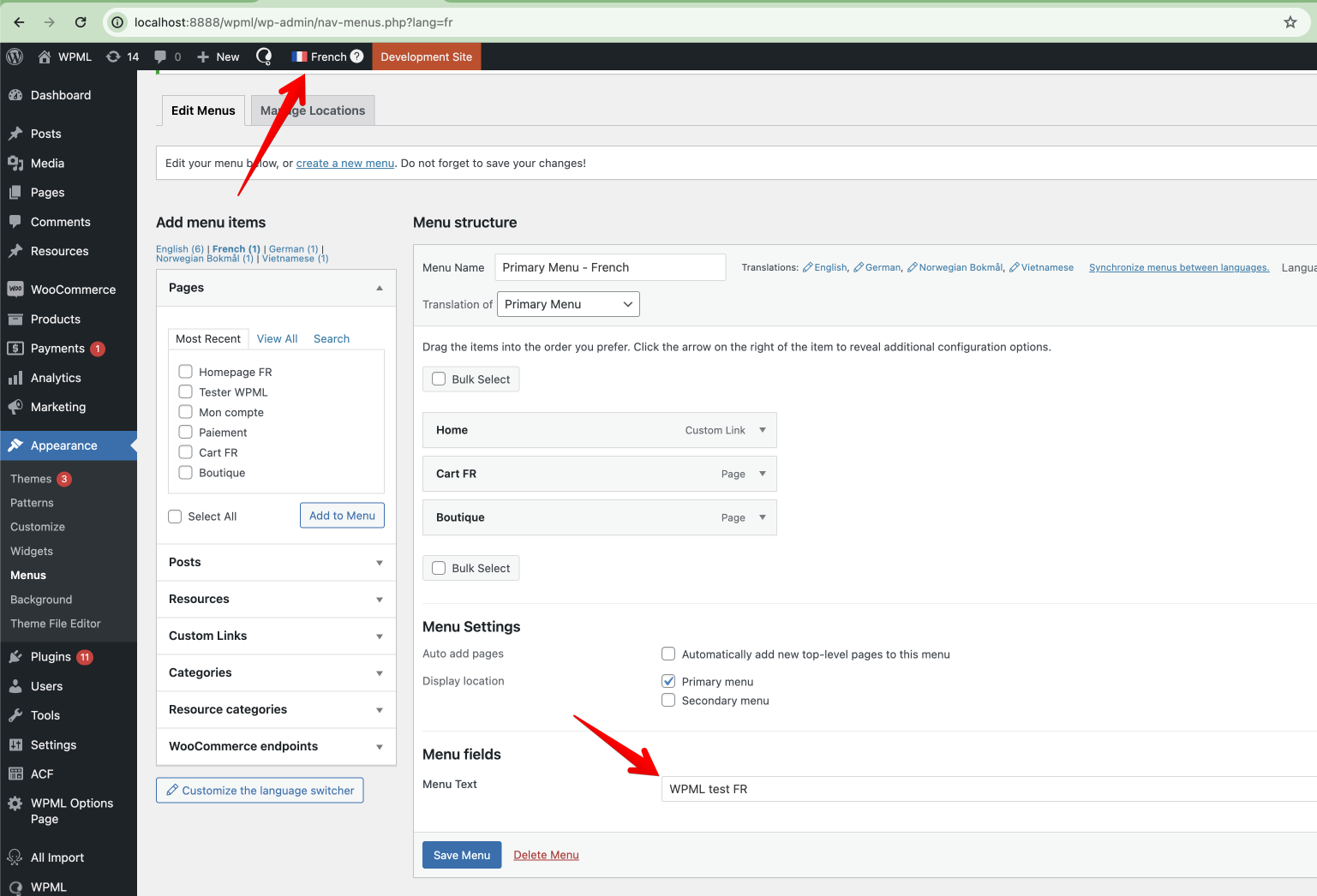

I try to replicate the issue on my local site by following the ACF documentation to create and output menu fields
but don't see that issue. The translation menu field value is displayed correctly in the frontend, please check the attached screenshots.

May 29, 2024 at 2:31 pm #15684524
Andrew Von Haden
I was able to set up the same system on that sandbox environment with the same result.
For simplicity, I just edited the theme file. You can find my modifications in:
Appearance > Theme File Editor > Global Templates > navbar-collapse-bootstrap5.php
I added a field to the menu called Test Menu Field in ACF. This field is attached to the Primary Menu. I then added a primary menu to the site with two placeholder links and test content in that ACF field. the then used the menu sync feature to create a French menu.
