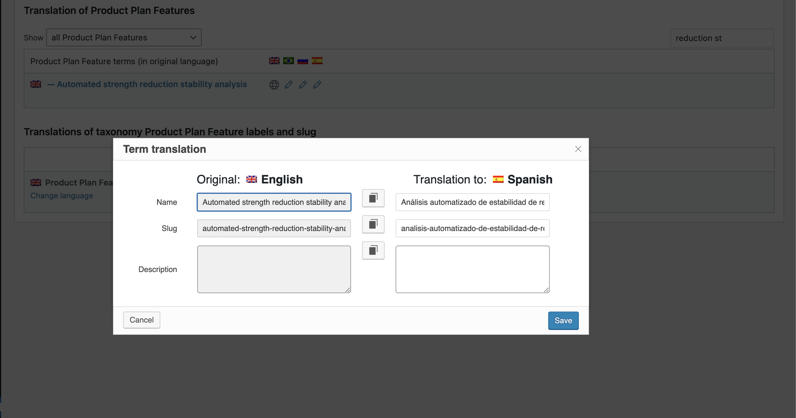

You need to translate the taxonomies and their labels and slugs at WPML > Taxonomy Translation.

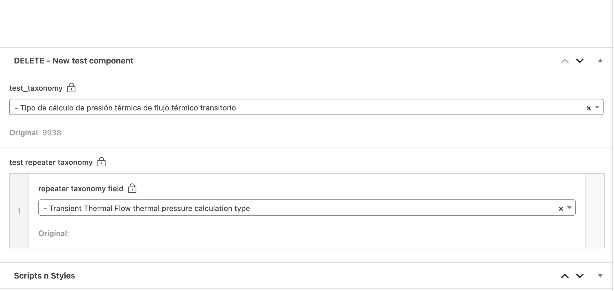

I am a newbie to wordpress and ACF components and I have a few questions due to this reason, please bear with me.
1. I have added a taxonomy value to the backend of a test page (EN - ACF Screenshot), and I was expecting to see the translated value when I checked the 'ES' version of the page (ES - ACF Screenshot), but it is empty - is this the expected behaviour? What am I missing here? For context: The taxonomy I have used for testing is already translated. See the attached screenshot (ES taxonomy translated proof) for proof.
2. I am using the method get_field to output the field values on the front end - eg: $taxonomy = get_field('test_taxonomy', $post->ID); It works on the English locale, but not on the 'ES'. Again, am I missing something here?
Thank you,

Are these taxonomies translated at WPML > Taxonomy Translation?

And why is the repeater field showing "english" value in the backend and frontend? See screenshot and link - hidden link

May I know why the repeater fields are "NOT" still working though?

Okay, do you have any findings on why the repeater fields are not displaying the translated values? - hidden link

The ACF Field is not getting translated, it is getting copied. The translation for taxonomies occurs at WPML > Taxonomy Translation. Also, taxonomies that are assigned to posts will get translated together with those posts, but this only happens once and not for every post.
If you would like to have a translation service to translate all the categories, you would need to create one post, add all untranslated taxonomies to it, and then send the post to translation. If the taxonomy was not yet translated, it will be translated together with the post.

I just tried to edit the taxonomy inside the repeater field on the original content, save the post and complete the translation again. And after editing the "ES" page looks as in the screenshot attached.
Now, after completing the translation, I get an error on the frontend saying the taxonomy (for both repeaters and taxonomy )is invalid, I guess it is possibly because of the way how I am pulling it on the frontend? This is the code :

I tried as per your comments and the taxonomy values are coming through, but the repeater field is not displaying the respective translated language value.
