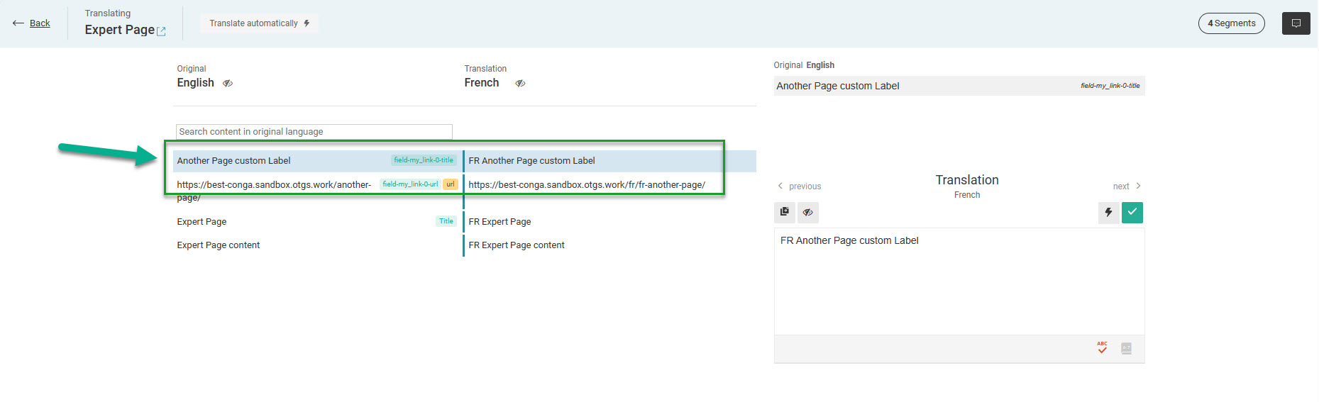

I have a link field in ACF that i can edit cause of the message above, i can not find it in string translations i need help

I consulted our second-tier supporter about this issue. The problem happens because the Link field is set to "Copy" by default with the "Same fields across languages" translation option. To translate the label of the Links field, you need to set the field to 'Translate'. To achieve this, you need to switch the translation mode of the field group from "Same fields across languages" to "Expert", which is our legacy field group translation option. I could confirm this on the test site. Please see the attached screenshot. Please read about the "Expert" option in our guide here.
