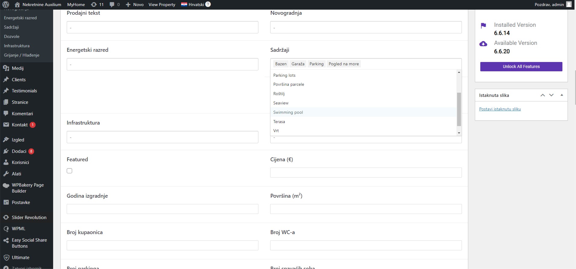

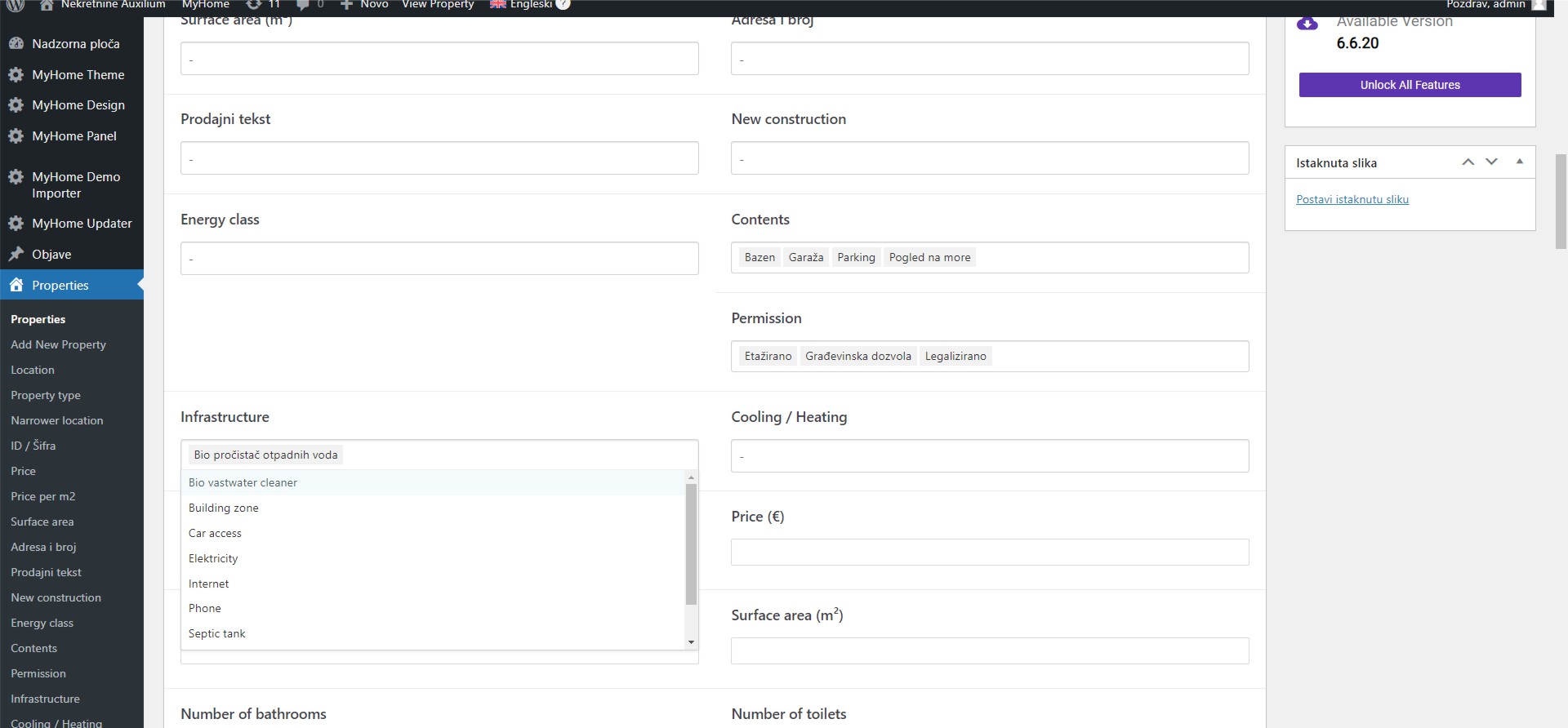

building real estate site with myhome theme and implementing secondary language found acfml bug with custom fields from taxonomy related that have multiple other fields related to property. When i was filling content for client with properties weird things happened and i had mess on site with fields when duplicating language and than clicking publishing post on actual language like i forgot something on first language before going to secondary language.
what i did and what will happen if i give this to client i am sure he will have the same issues because this is user case that can happen and cause mixed content across language and detached taxonomy custom fields or similar that is prepared before:
1. I am creating property on default language Croatian , than i attach fields into this posts from taxonomies that have, like contents, locations, type of properties, permissions. when i finish i duplicate this post for fields to copy on secondary language. And sometimes happened that i forgot some field than i stay on this language and click publish post , and after that fields that are attached to property are created again and ovverriden.
In image attached with this case i am sure you will se what is happening in this user case. i only want all the same fields on secondary language attached to property but translated, which i did and connected this fields in taxonomies of properties. Not mixing and than again translating new connections and duplicating same fields that are already prepared only need to be shown not overriden
Everything works fine when i after first duplicating post dont click publish on current language, than going immediatly editing secondary language but with this user case something was wrong with fields that are ovverriden, mixed and detached. User will have trouble and headache what if he click publish after duplicating post if he think: o i miss something on current screen... he will not know that what will happen than only option is to find backup form last day or something... please help.. tried everything copy, or copy once , translate and allsettings this is happening again and again
provided you debug information for development site, but it also happened on live site where the acf pro plugin is latest version and everything is updated to latest...

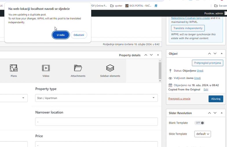

Observations from your video:
- When attempting to update a duplicate, you'll encounter a notification indicating that its content will no longer synchronize with the original.

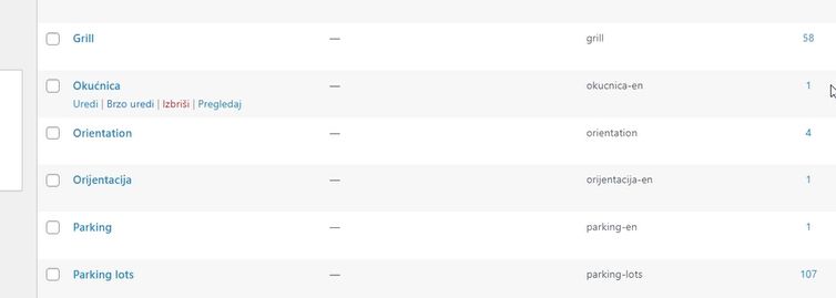

- The count in taxonomy will only match if both languages have an equal number of properties, which isn't always the case.
