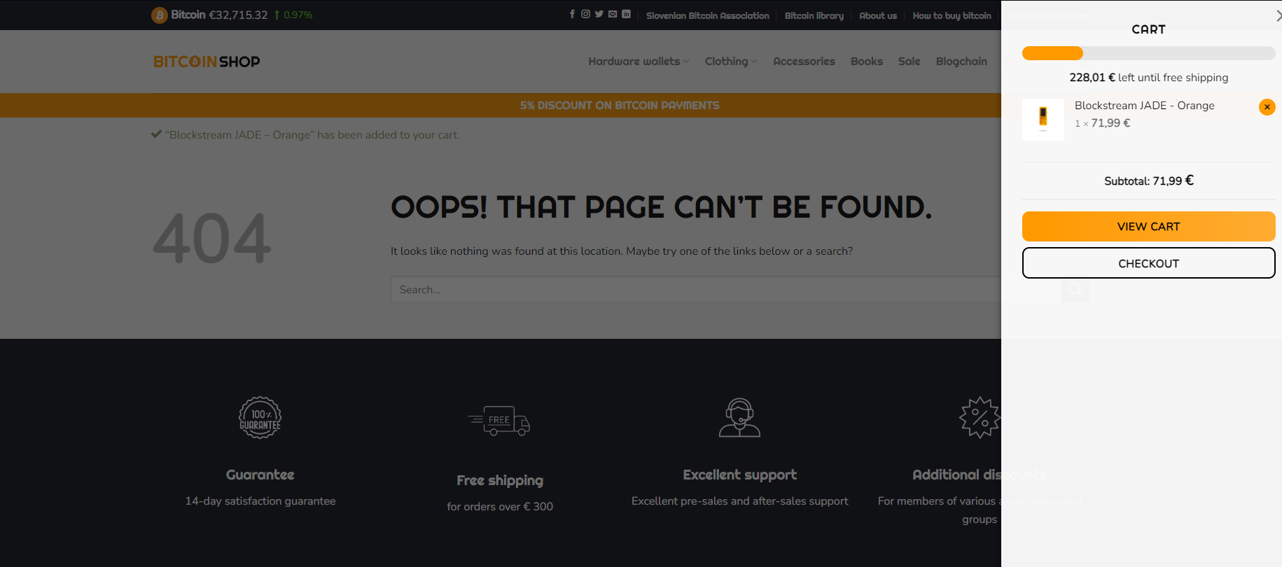

When you add to cart a product it puts the product in to add to cart but redirects to 404 page on the secondary language (english version).
Link to a page where the issue can be seen: hidden link - its any product but I give these one for reference (You have to add a product in to cart on single product page to se the issue on .net domain)

Upon selecting the "Add to Cart" button, the product is successfully added to the cart. However, for some unknown reason, a page refresh is triggered, resulting in the loading of a 404 error page.

The issue is with Jetpack plugin do you have any idea how to fix so it works with jetpack

We have recently identified an issue with the Jetpack plugin where non-logged-in users receive a 404 error during the process of adding a product to the cart. For further details, please refer to the errata provided below.
- https://wpml.org/errata/jetpack-trying-to-add-a-product-to-cart-in-2nd-language-while-not-logged-in-goes-to-a-404-page/
If your situation aligns with this, I suggest trying the workaround outlined in the Errata and hopefully, it will solve the problem.
Please let me know if you're getting the expected results after adding the workaround or if you need further assistance in this matter. I will be happy to help.
