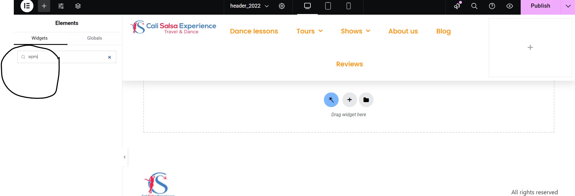

Hi Kor, Thankyou for your time, youre very generous,
My issue is all related to the mobile version of the webpage,
The language switcher is only appearing in the desktop version, but I am not able to see it in the mobile version header.
The wplm widget is not available as a widget, see the picture below
I will deeply appreciate if you don´t send me to read a ton of "documentation", but just help me to make this widget available.
Thankyou

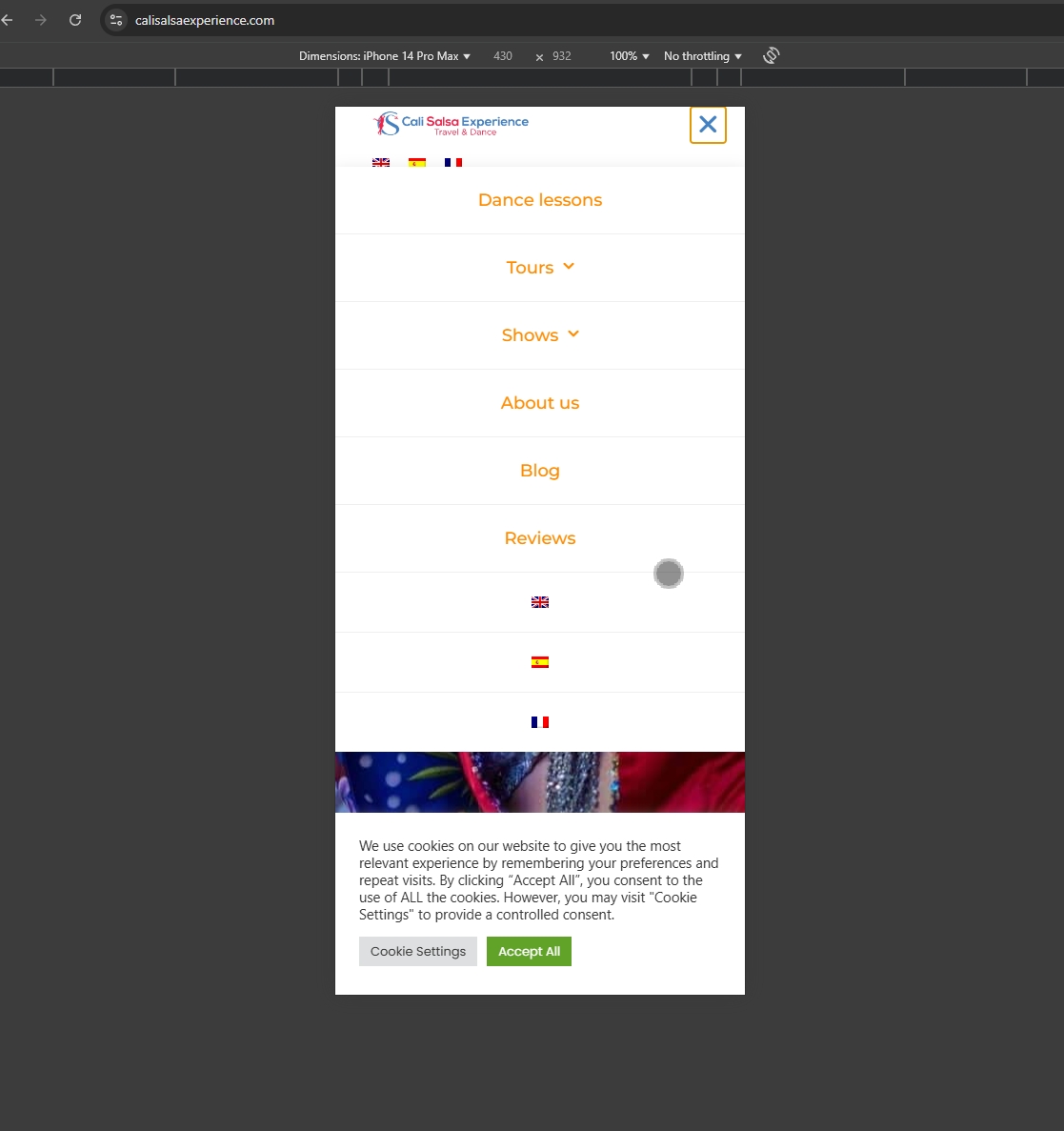

February 28, 2025 at 1:12 am #16758589
WPML Supporter since 08/2022
Thanks for your reply. I can see that you've already added the language switcher in the mobile menu. However, I noticed that you're displaying so many language switchers. Would you like me to remove these extra language switchers for you?

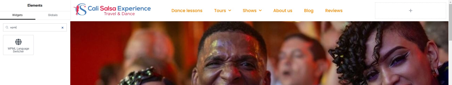

February 28, 2025 at 9:51 pm #16762909
alejandroM-48
Site owner
Hi Kor!
Thank you for your time! 🤩 I may see now the flags in the mobile version of the webpage.
I just wanted to know, How did you add them?, since I am not able to edit them from the back-end of the Elementor theme.
I see you have enabled the widget option (see picture below), but apparently it is not the option you've implemented. Just in case I need to edit them in the future.
I have already removed the menu of the language switcher that was attached to the main menu. Thank you for offering to do it yourself.

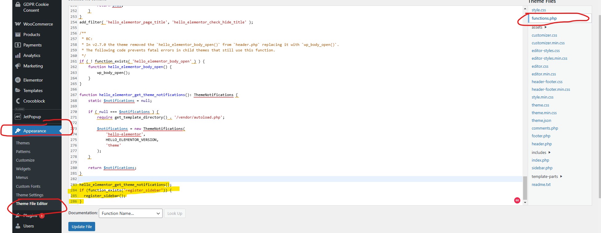

March 3, 2025 at 8:34 pm #16770808
alejandroM-48
Site owner
Hi Kow,
I might have added this code in the php functions of the theme as a language switcher. (see picture belllow)
But I dont remember if this refers to a language switcher, if it does I guess I will have to remove it.
To dont screw it up, would you be able to remove the part the refers to language switcher?
I think is the last part from line 283 until line 286. What do you think?

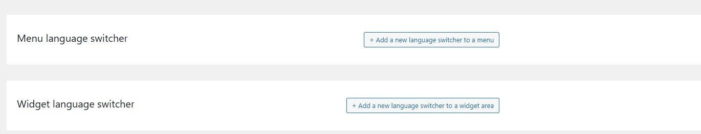

March 3, 2025 at 9:06 pm #16770876
alejandroM-48
Site owner
I already tried removing the php code, and I did not work. The flags still appearing as visible. So this is not the case.
Also in the photo below you may see there is no menu added as a language switcher or as a widget. So, I still dont know how this flags are appearing.
Are you able to find out, knowing you have the credentials of my site with an administrator permission, plus the expertise of WPML supporter?
Thank you for your time Kor you´re very generous.
March 4, 2025 at 1:19 am #16771246
Thanks for your reply. The language switcher on the header is added on the Elementor Header template here hidden link
I've removed it for you. Then, I navigated to WPML > Language > Menu language switcher > Added a language switcher over there.
Now the language switcher shows up on both desktop and mobile version. Could you check?

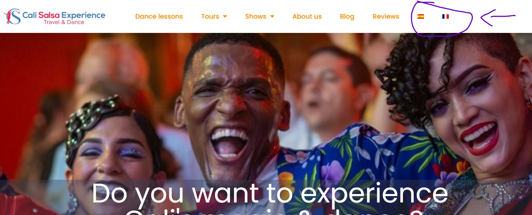

March 14, 2025 at 5:10 pm #16818121
alejandroM-48
Hola Kor!
Still me around. 😊
My ultimate goal is to have only the wpml menu widget showing up.
I don't want to see any other bar showing side to side with the menu. This way I may have control of the size and format of the things showing up in the header.
In the first photo of the font end of the webpage you may see there are some flags that I would love to eliminate, as they appear in the front end of the webpage, but I can't see them neither edit them in the backend. See photo "wpml front end"
Here you see I can't see this flags in the back end.
See photo: "wpml back end" when editing the header.
Could you please help me to eliminate these flags to have only the wpml widget available?
https://wpml.org/forums/topic/remove-language-switcher-on-the-navigation-menu/
