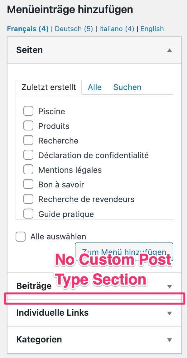

Give the Customer (Separate admin User) the option to maintain the Page Menu for all translated languages. My Page uses custom Post types, which should be shown as Menu Items in a Sub Menu. When my Customer opens the Design > Menu Page in WPAdmin, she does not have the custom post type section in the left sidebar of the menu screen.

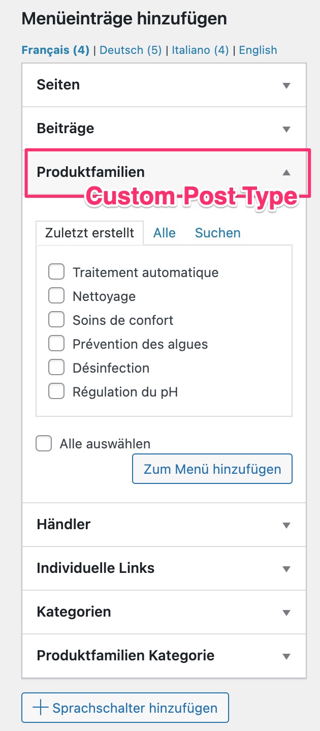

When I open the menu screen, I have the custom post type section and can add custom post types to the menu as I wish.

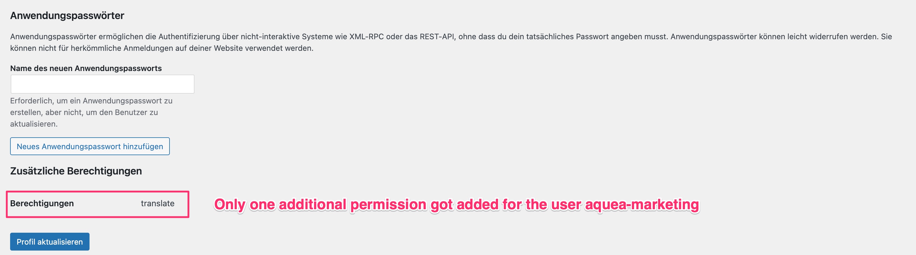

My Assumption is, that it is connected to the additional Permitions of the users.
My User aquea-jan has several additional permitions.
The Customer user aquea-marketing does only have one additional permition "translate"
See printscreen "additional-permissions-aquea-jan.jpg" vs "additional-permissions-aquea-marketing.jpg"
I expected to see:
All custom post types as sections in the left sidebar of the menu screen for all users having the administrator role. See printscreens "Menu View User aquea-jan.jpeg" vs. "Menu View User aquea-marketing.jpg"
Instead, I got:
Just all default Sections as there would not be any custom post types
I tried to create a new user with the admin role both from the users admin page and also from the wpml translator page, but they always only get the "translate" additional permition.
I have the issue on two separate WordPress instances. If needed, I can create a temporary admin user where you can see the behaviour.

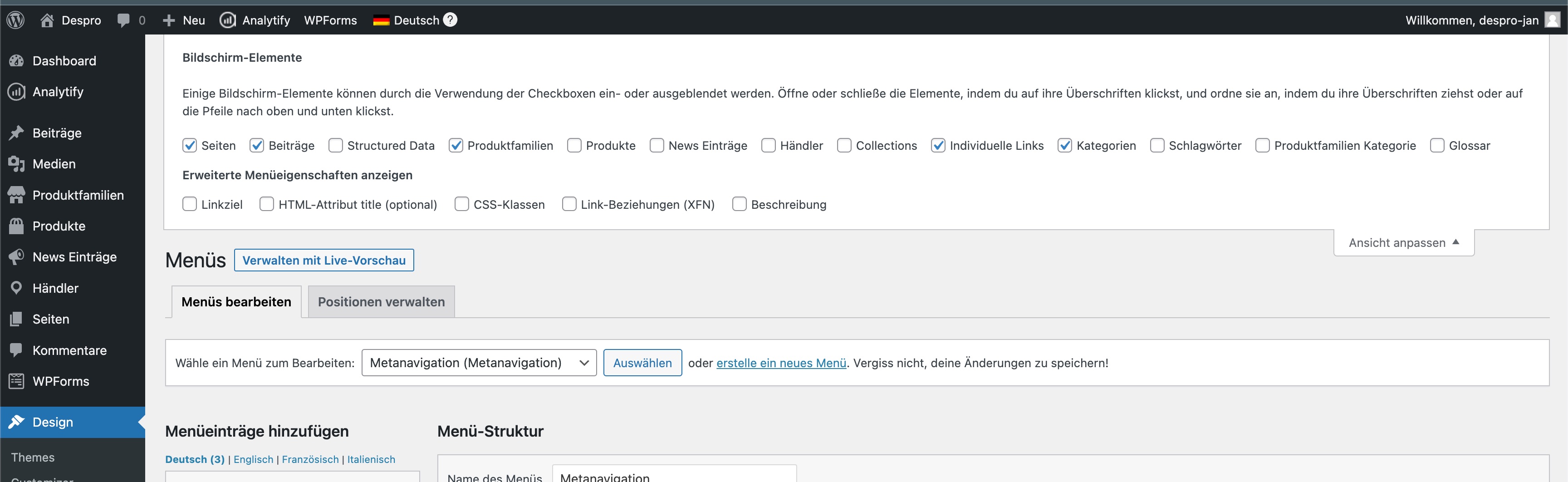

It turned out, that the problem was the whole time, that in the Screen Options, the Custom Post Type "Produktfamilien" was not selected and that's why, it was not shown to the second admin user.

Since, the CPTs display was controlled by screen options and it is not restricting user to actually use that CPT, I don't see a problem here. The screen options are handled by WP's own system, and the default display may vary depending on CPT's registration. That's why screen options are available to the users, to show/hide allowed content on screen and/or to set some display settings.
