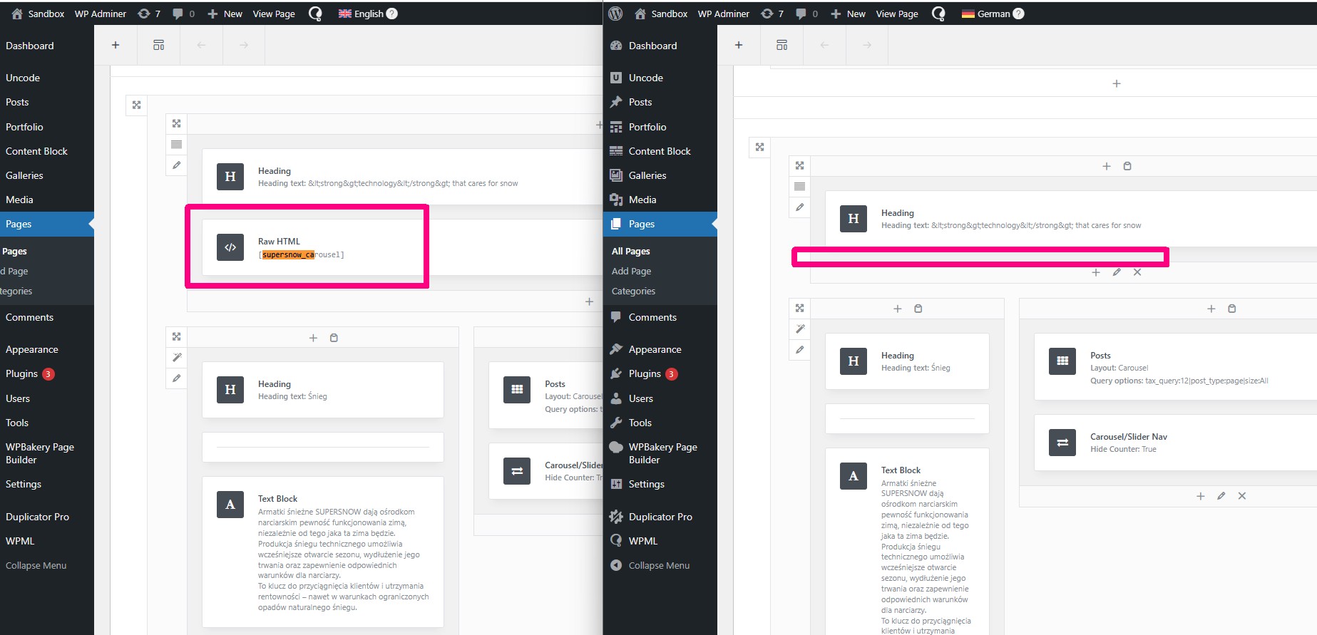

Anyway, I copied the content of the home page and you can see there's a shortcode: [supersnow_carousel] — however, after performing the translation, the shortcode disappeared.

Just to confirm my understanding: after the page was translated using the Translation Editor, this field was removed from the translation, and as a result, its content is also not being rendered on the frontend?
If this is correct, I will escalate the case to our Compatibility Team for further investigation.
January 14, 2026 at 7:50 am #17727968
agataM
Yes, the shortcode is added, but after performing the translation it disappears completely on the Front-End. Please investigate this issue.
