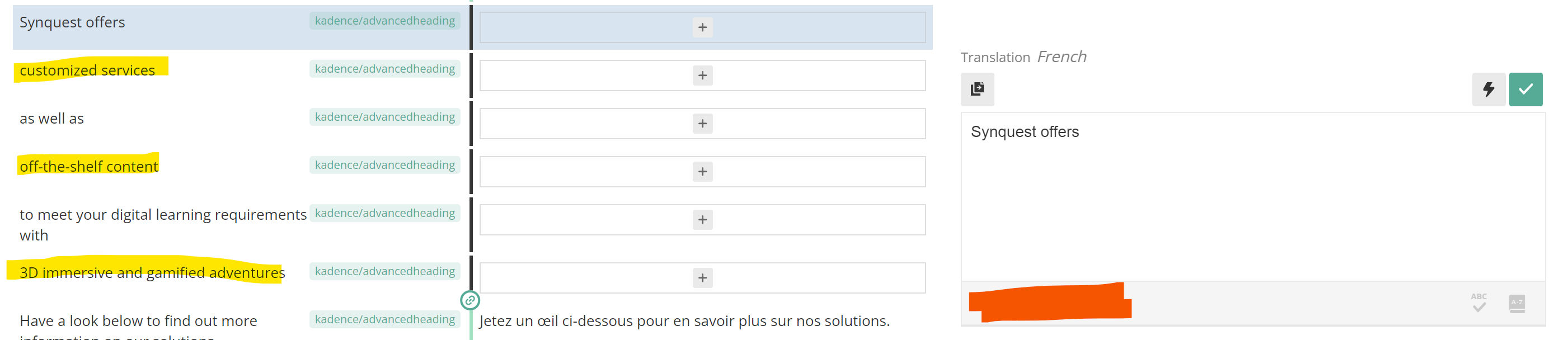

I've an issue with a fix that was provided in a previous support ticket, which started with reply #14039719 and ended with reply #14067105. The initial request was solved with provided code, but it has created a much bigger issue: all the highlighted/bold text has now disappeared from the translation editor. Please help me as soon a possible, my production website is impacted. Can you please give me access again to the sandbox site used in the previous ticket to allow me to recreate the issue? Thanks in advance!

Thanks for your reply. I was unable to recreate the issue in the new sandbox, but in the new sandbox the previously provided fix to translate the additional strings of the typed text also doesn't work. Could you please check why that is the case?

August 4, 2023 at 1:56 pm #14155335
arnaudA-8
Yes, that's the issue, the bold and highlighted text is not showing in the translation editor and after translating the text is still shown in the original language. Please provide a solution. Thanks in advance!

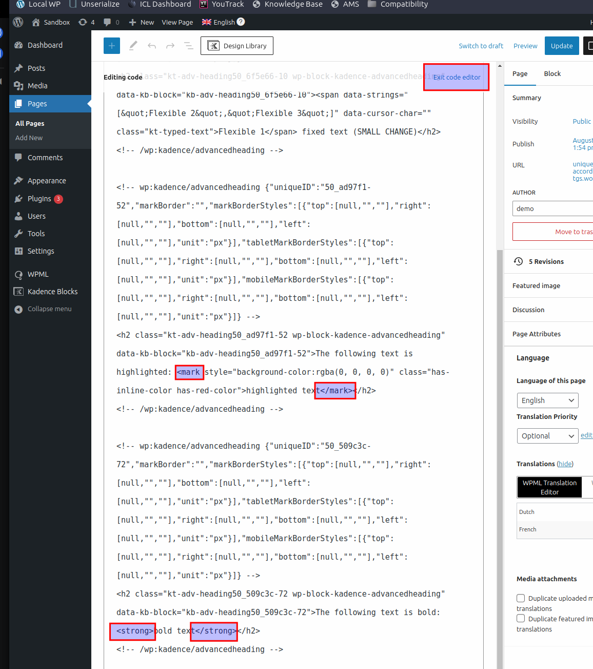

August 4, 2023 at 7:24 pm #14156679
Eran Helzer
Update.
I added the necessary configuration, it seems to be working correctly now.
Let me tell you what I did so you know what you can try in the future:
- Switch to code editor when editing the page
- Recognize the surrounding tags of the untranslated text, in this case and <mark></mark>
- Go to WPML -> Settings -> Custom XML Configuration
- Add the elements to the fourth line in the configuration
This:
      <xpath>//*[self::h1 or self::h2 or self::h3 or self::h4 or self::h5 or self::h6]/text()</xpath>
To this:
      <xpath>//*[self::h1 or self::h2 or self::h3 or self::h4 or self::h5 or self::h6 or self::strong or self::mark]/text()</xpath>
Please verify that this resolves the issue, and if so you can copy the configuration from the test site to yours:

August 7, 2023 at 8:22 am #14161843
Eran Helzer
Yes, of course.
1. Please take a look at the fourth line of the WPML -> Settings -> Custom XML Configuration:
This includes all the HTML elements that will be sent to translation (h1, h2, h3, ... strong, mark).
The issue was that "strong" and "mark" were not included in the configuration you previously had.
2. In order to know what HTML elements I needed to add, I opened the page with the code editor (screenshot attached).
3. Then, I saw what HTML element the untranslated texts were in, "strong" and "mark", and added them to the configuration.
So this:
Turned to this:
After updating the configuration, I had to re-translate the page, and this time the highlighted and bold text was also translatable.
August 7, 2023 at 3:00 pm #14164759
arnaudA-8
Yes, this 'solves' the issue in the sense that all text is now visible again in the translation editor. However, it's split up in a lot of different strings that need to be translated separately. Before, it was one big string in which 'tags' could be added to influence the text (bold words). This is not only way more convenient, but is also required because the sequence of words is not the same in every language. Please advise on how to fix this.
