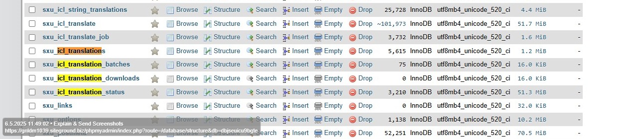

simeaM
As shown, the Tables are there, but the SQL query wants the wrong tables.
So I need to check where does the SQL get build?

Bobby
WPML Supporter since 04/2015
Thank you for confirming!
Yes you are right the SQL is targeting the wrong prefix.
