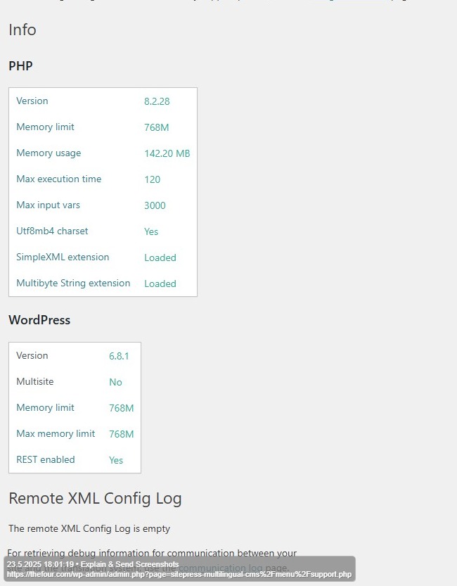

May 23, 2025 at 4:04 pm #17067246
Joshy Merki
And there is all green here

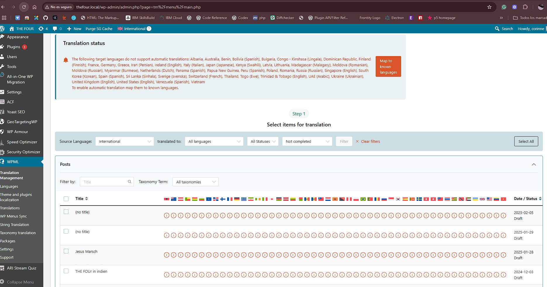

I took a local copy of your site and can not confirm the same issue. See screenshot.
I will need some more time to investigate the issue on your site or even better on a staging site on which the same issue occurs. I suspect it might be that one of Sitegrounds must-use plugins might be causing the problem.
