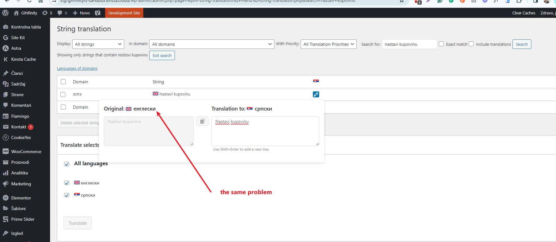

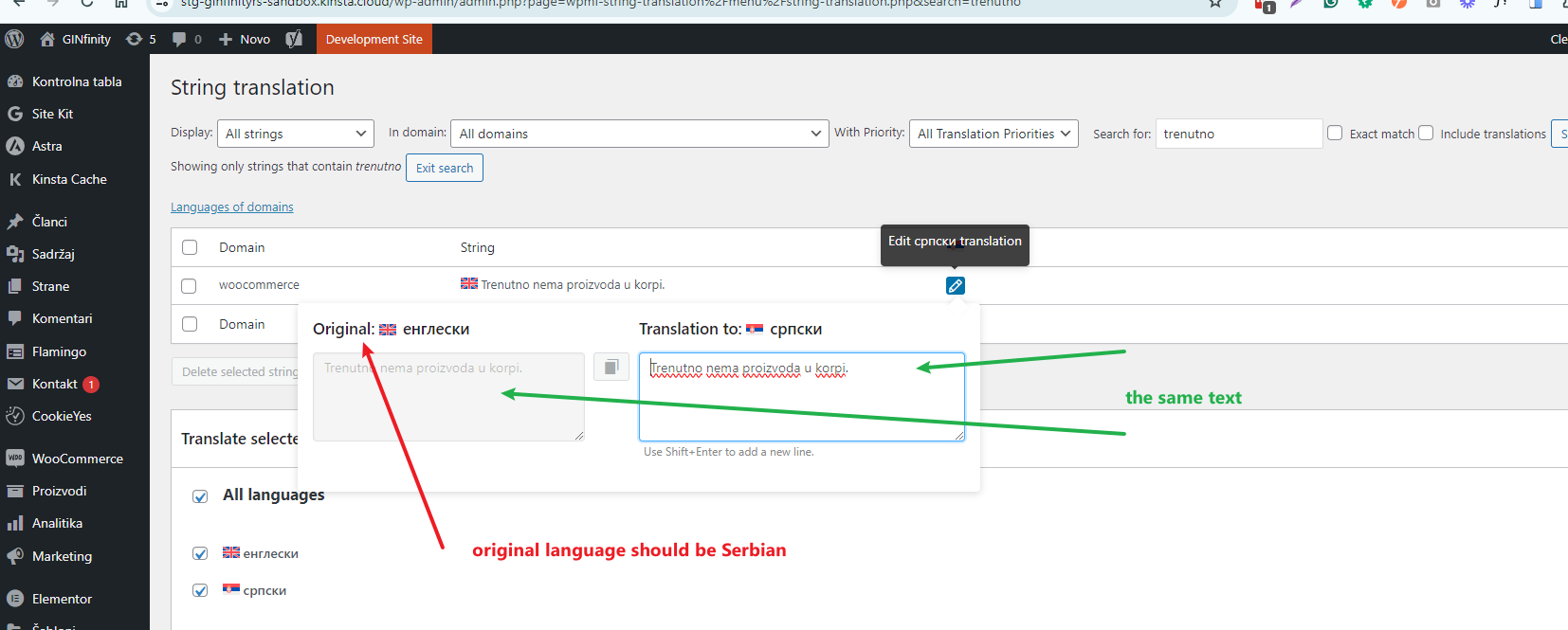

Hi, I found what you suggested to me and I can find it now in String translation, but I have a problem with the default language. I cannot find where to change it for this 2 times. It's set to be English as default for these 2 items and needs to be Serbian. So the problem is - on both sides Serbian text. Can you please help me how to change this? I'm sending screenshots in the attachment. I see that one part is related to Astra and one to WooCommerce, but I cannot find where to change it. Here are the credentials if needed:

1) I deleted the access details for your site's safety. If you don't see the form below, please don't add your credentials, as they will be publicly exposed٫ (hidden link)
2) Please select the string, change its language, and then translate it to the correct language. Kindly check this guide. (https://wpml.org/documentation/getting-started-guide/string-translation/how-to-change-the-source-language-of-strings/)
