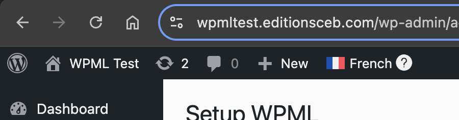

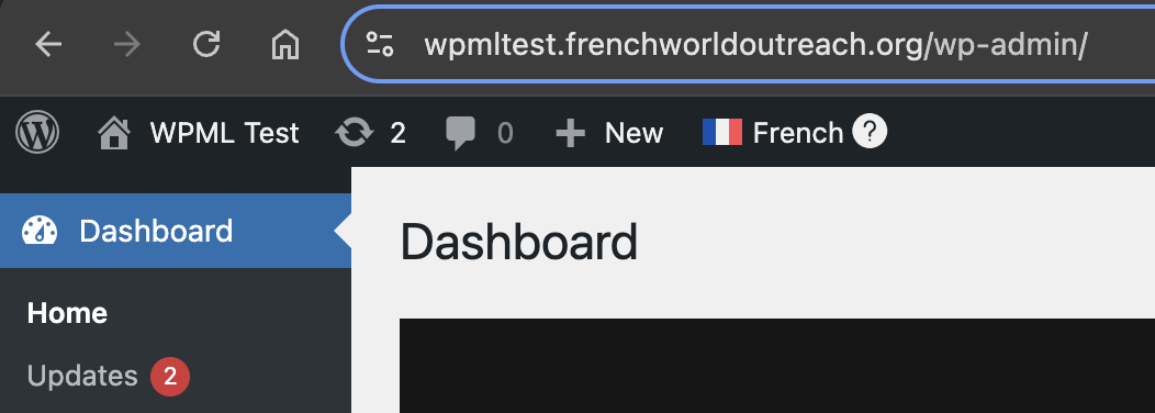

I can confirm that I am reproducing the issue on the testing site that we have been looking at. I have recorded a screencast to demonstrate, available at this link (or please let me know if you have an alternate way you wish to access it): hidden link After I first tried to start fresh with a different browser, plugins disabled, and cache cleared for the relevant sites, these are the steps I followed in the first part of the video to demonstrate the issue. 1. Logged in to wpmltest.editionsceb.com admin. Is this expected? Thus far it is sufficient to demonstrate the problem, but in the video I also tried a couple other things to further investigate the problem. |

I can clearly see the issue in your screencast, however, my experience as you can see in the following video is different as I can't reproduce the behavior. hidden link Update: Are you testing in an incognito window? I was able to reproduce the issue when testing in an incognito window only. |
