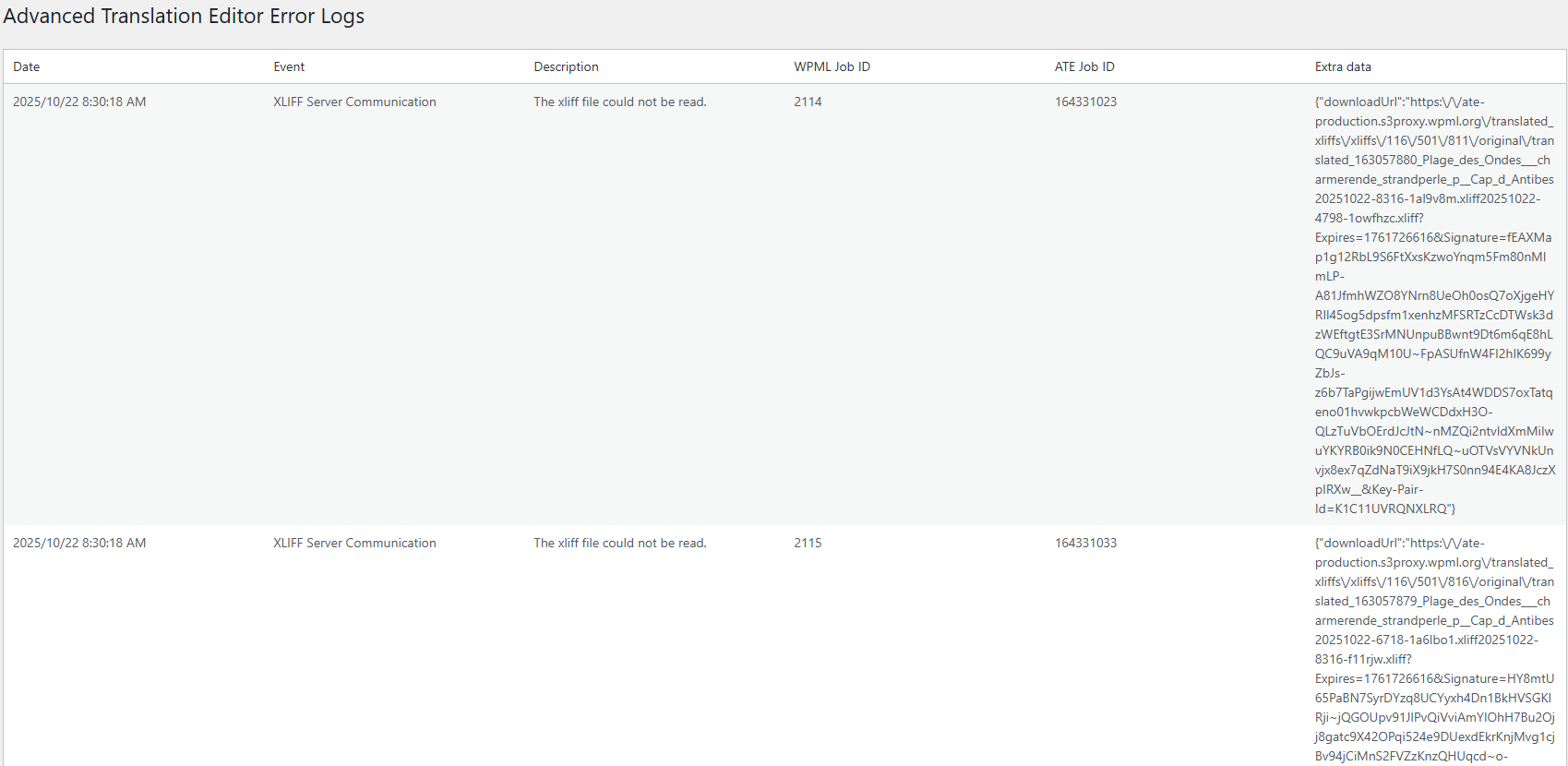

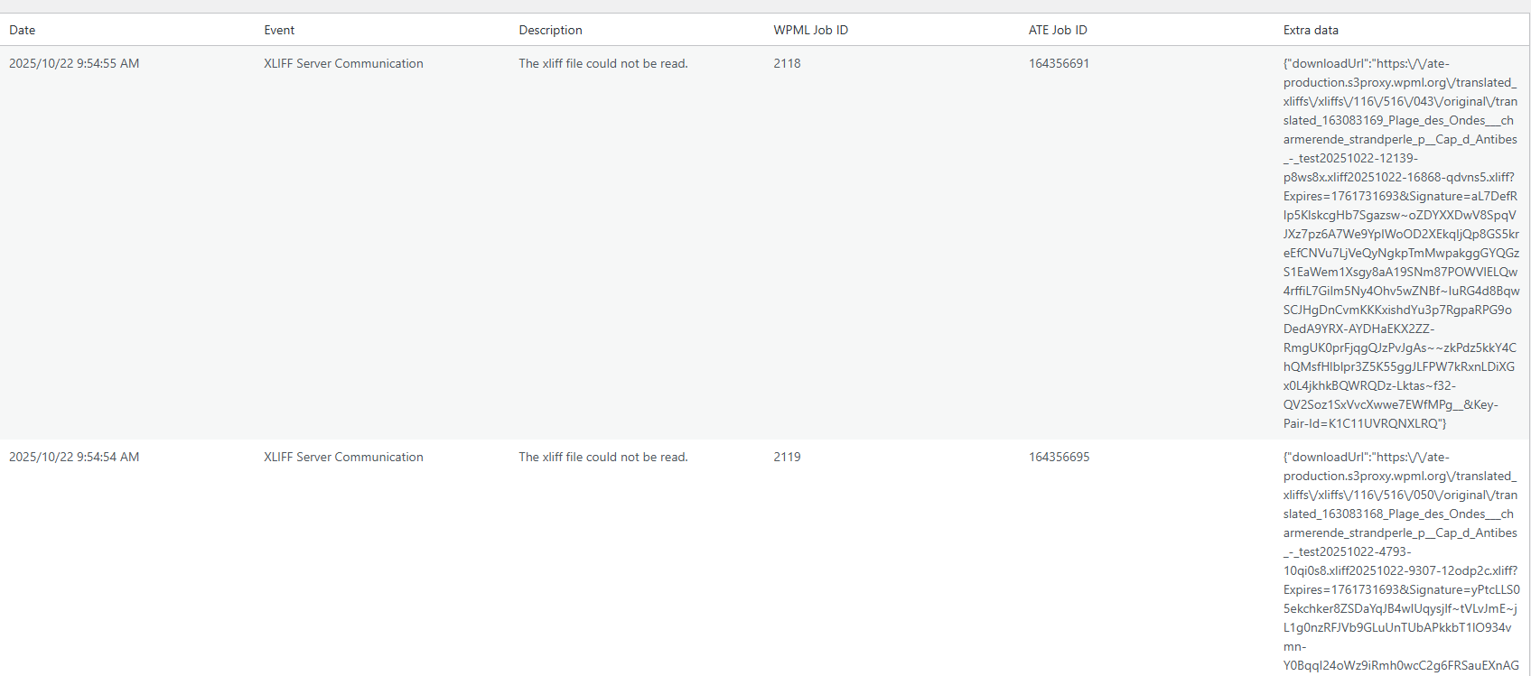

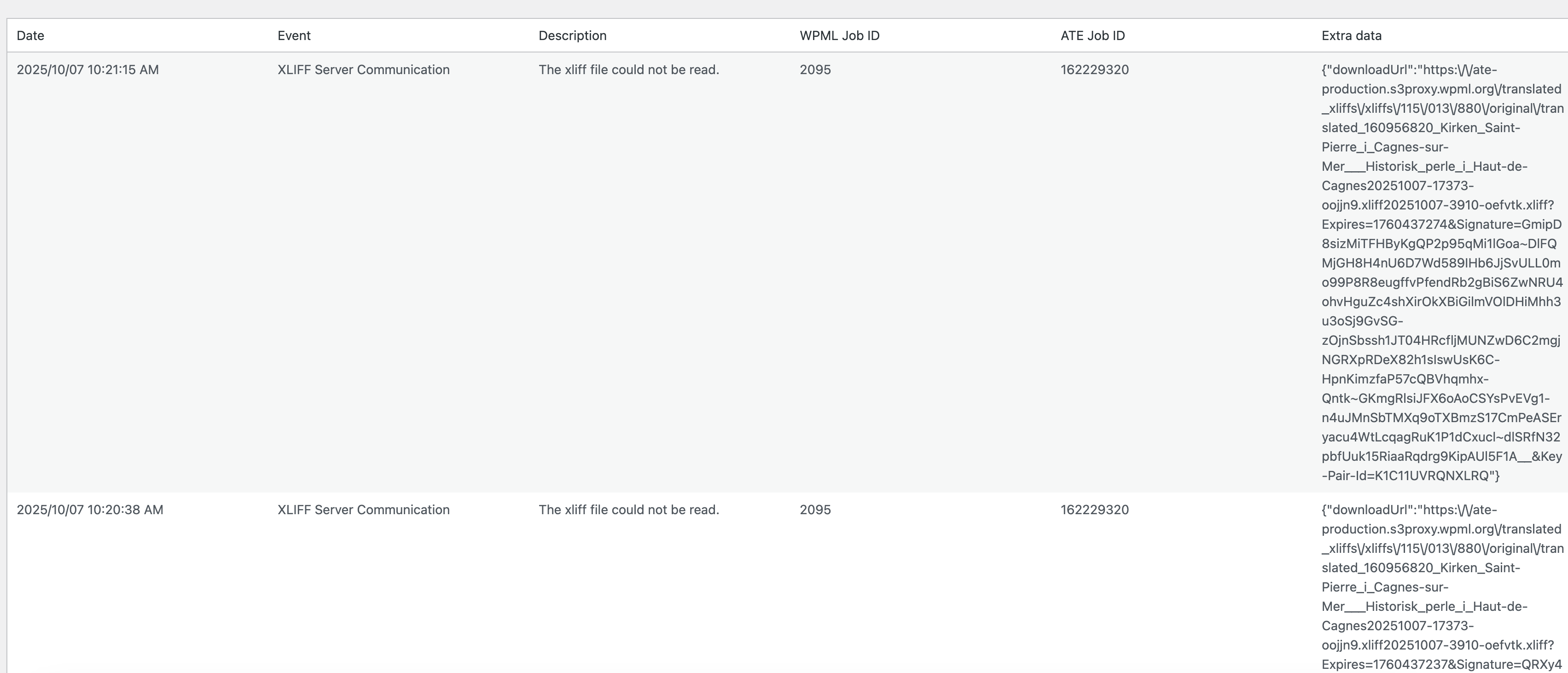

The translation process gets stuck with a 'gear' icon, and I receive an error in the 'Advanced Translation Editor Error Logs': 'The xliff file could not be read.'
Why is the automatic translation stuck with a 'gear' icon?
What does the error 'The xliff file could not be read' mean?

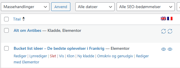

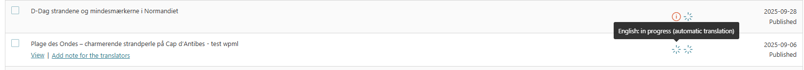

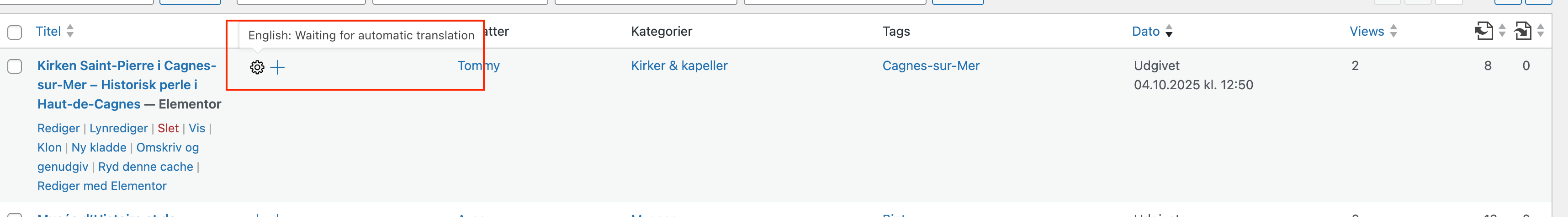

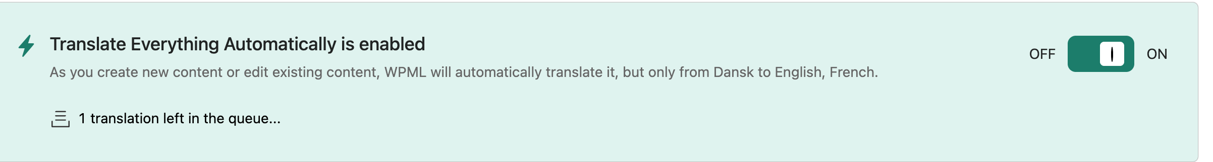

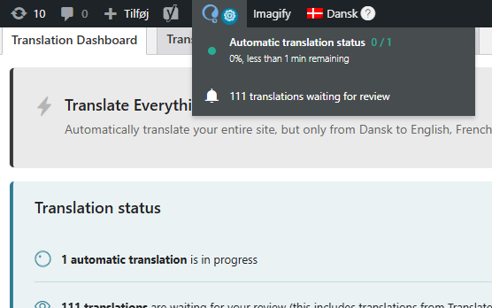

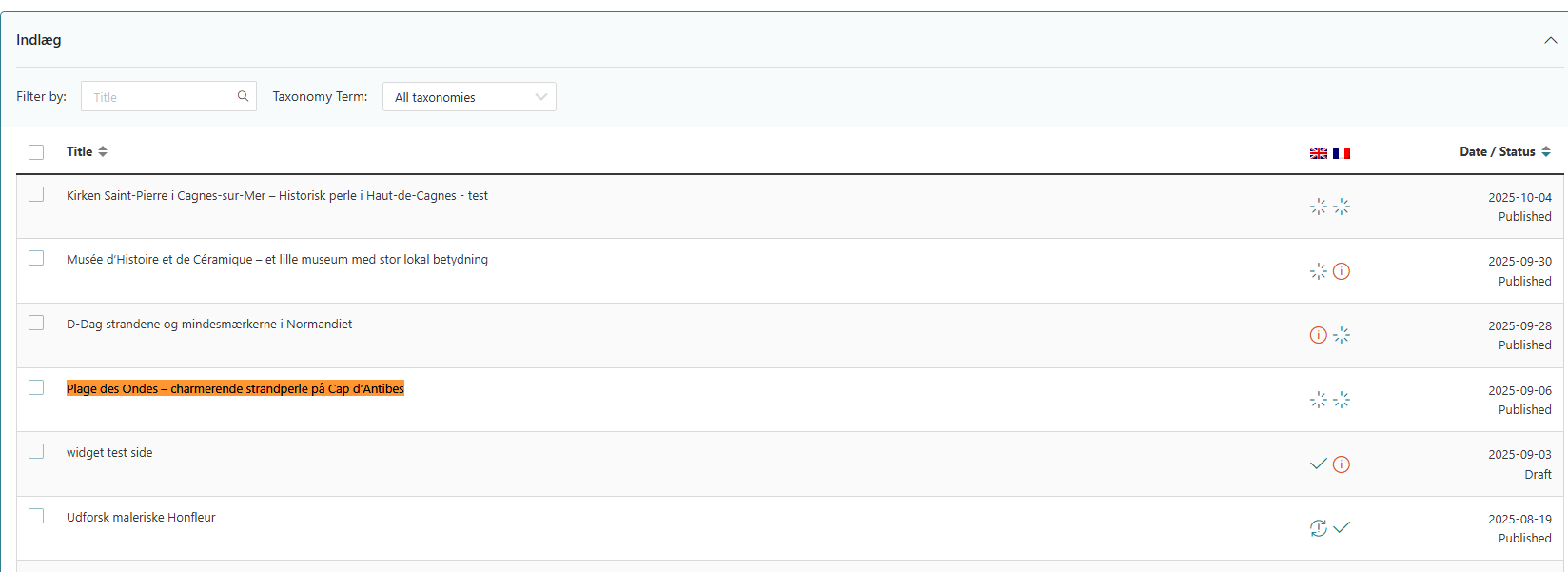

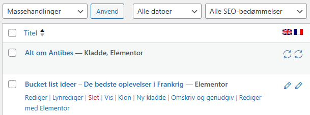

I updated this page (added a space) in the original language (danish) hidden link - and I see that it has changed to review in both english and french and that I can review and accept the translation on both.

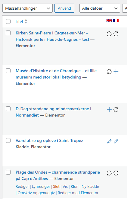

Now if I try the same for a post - hidden link - I get the refreshing-translation-status-symbol and, shortly afterwards the gear symbol "Language: waiting for automatic translation" - in the translation dashboard: hidden link - it says "Language: in progress (automatic translation)" and does not finish.

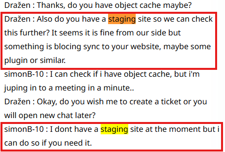

October 22, 2025 at 9:35 am #17506328
simonB-10
But you asked us if we could create a staging site for you to test the wpml issues we face.. 🙂
"Anyway, I have checked and it seems to be a know issue on our side. I have shared your case with our 2nd tier who is working on similar reports. Once they have some news I will share and get back to you."

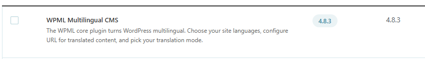

This is done and I have checked for updates and updated the "WPML Multilingual CMS" to version 4.8.3
It still seem to be stuck.

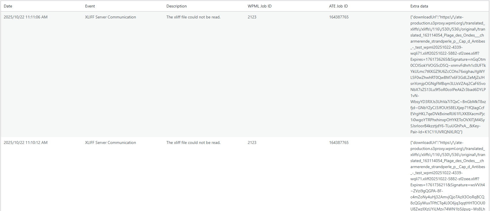

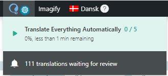

I took your advise, and changed the text-widget content to just be "test...", saved and send to translation (automatic translation)
It is stuck at 0% and has a gear-symbol "Complete the english translation" and the Translation dashboard says "English: in progress (automatic translation)"
