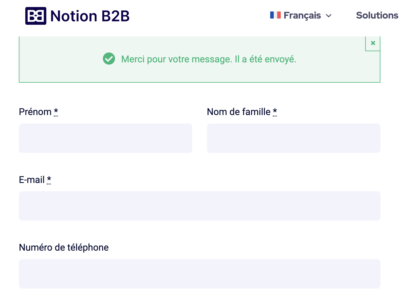

I did some further testing. I set up a clean install and was not able to reproduce the issue there. Feel free to use this link and change settings or anything you would like to test: hidden link
I then went back to your live site and switched to French. I think previously, I did not fill out the phone number field. This time I did, and the form submitted and I see the submission on the backend. Can you test and let me know if you find the same results?

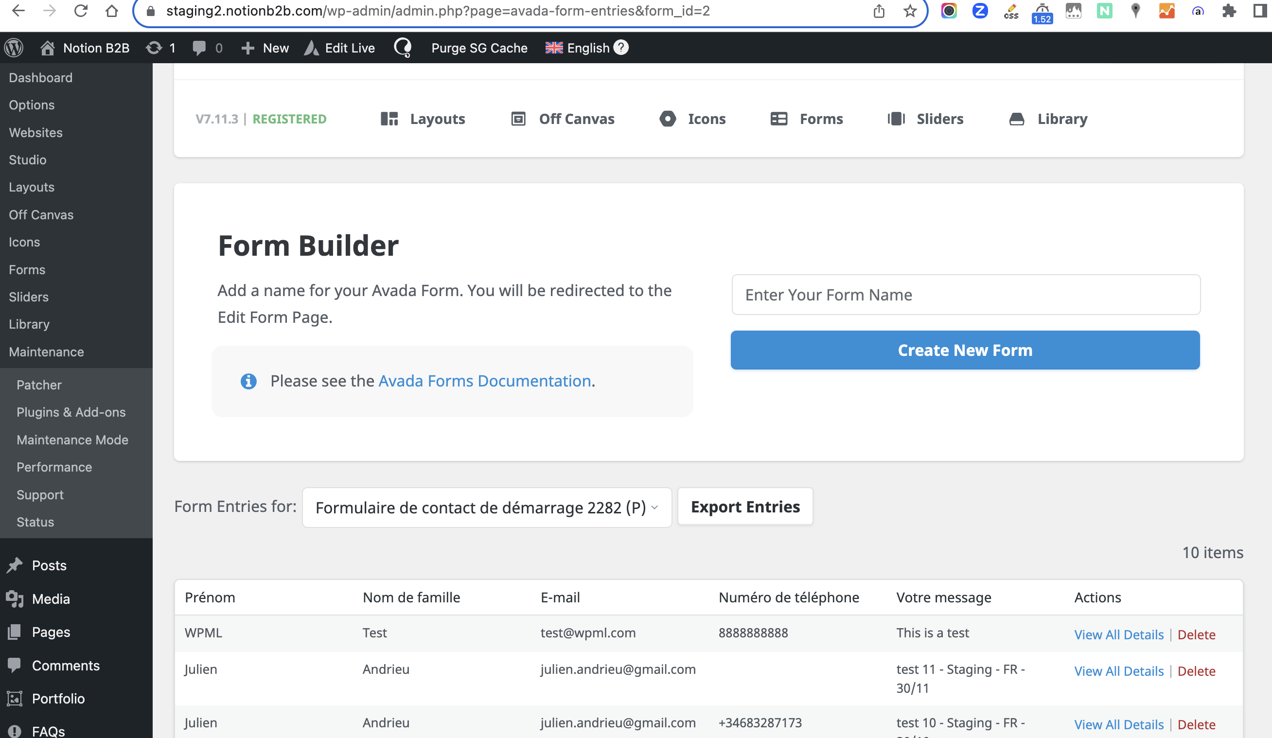

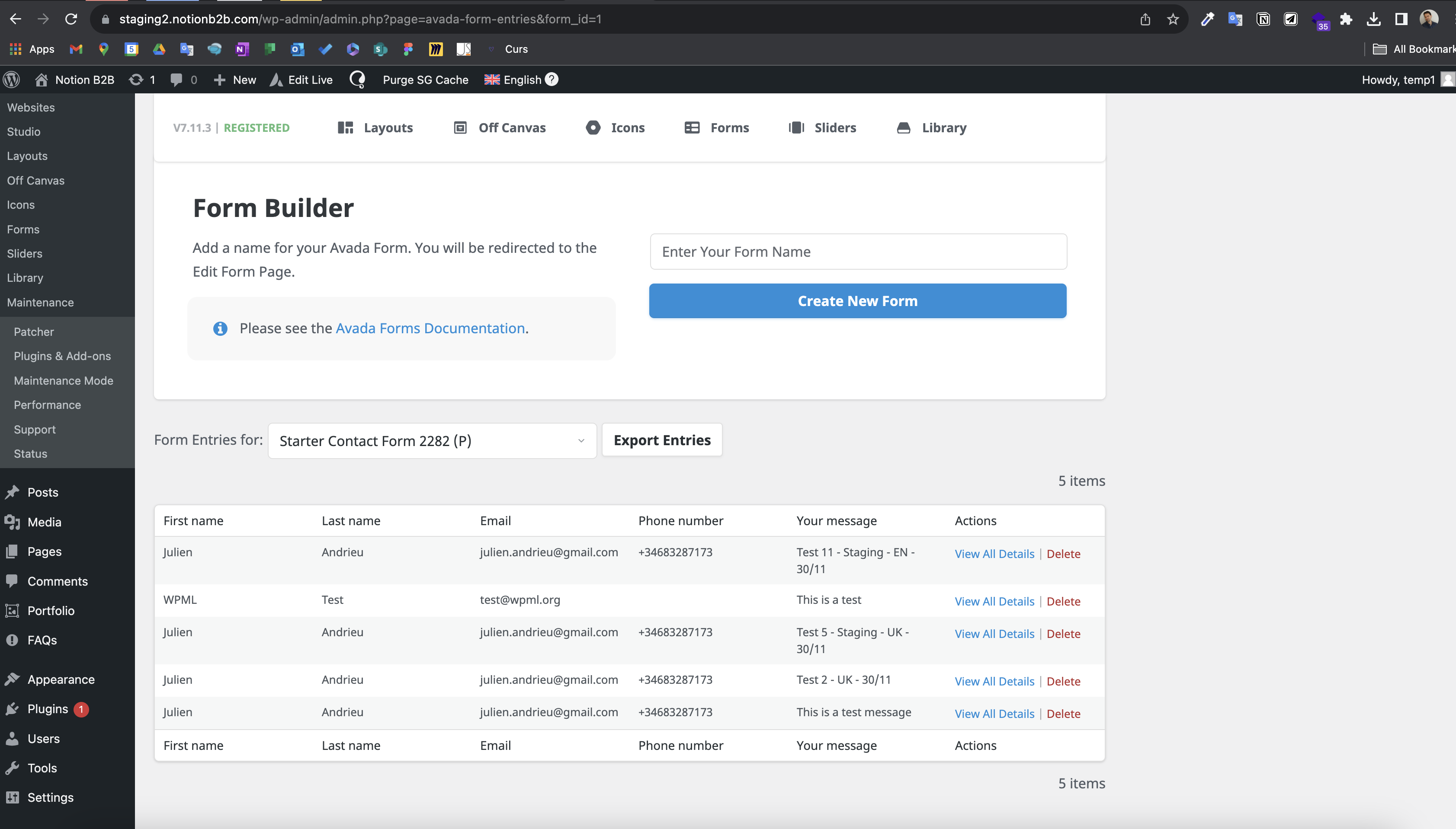

I can't neither find any new form entries in the DB (see screenshot - All entries here has been done via the EN version of the form).

I just tested it again on your live site. In your screenshot, you are looking at the English form. You need to use the drop down to switch to French and then you will see the French entries.

Oh my gosh!!! 🙂
As easy as that. So, Indeed it's working. Messages are recorded in the DB.
