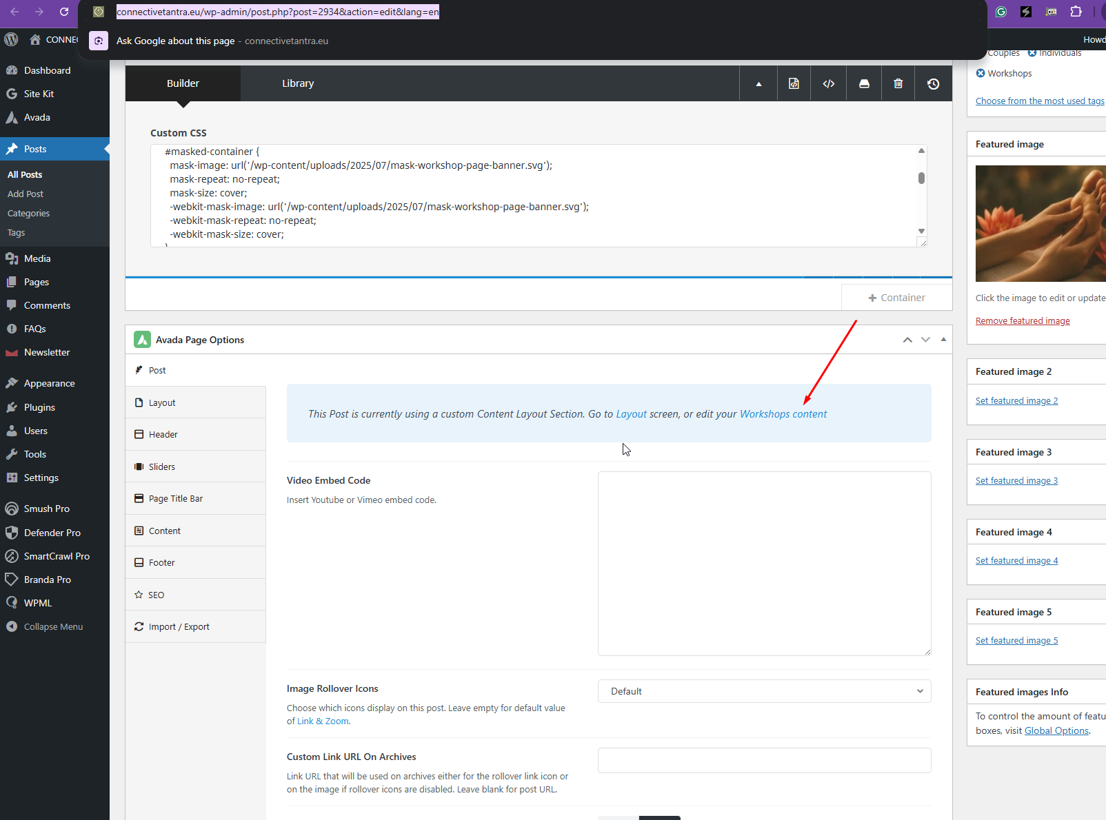

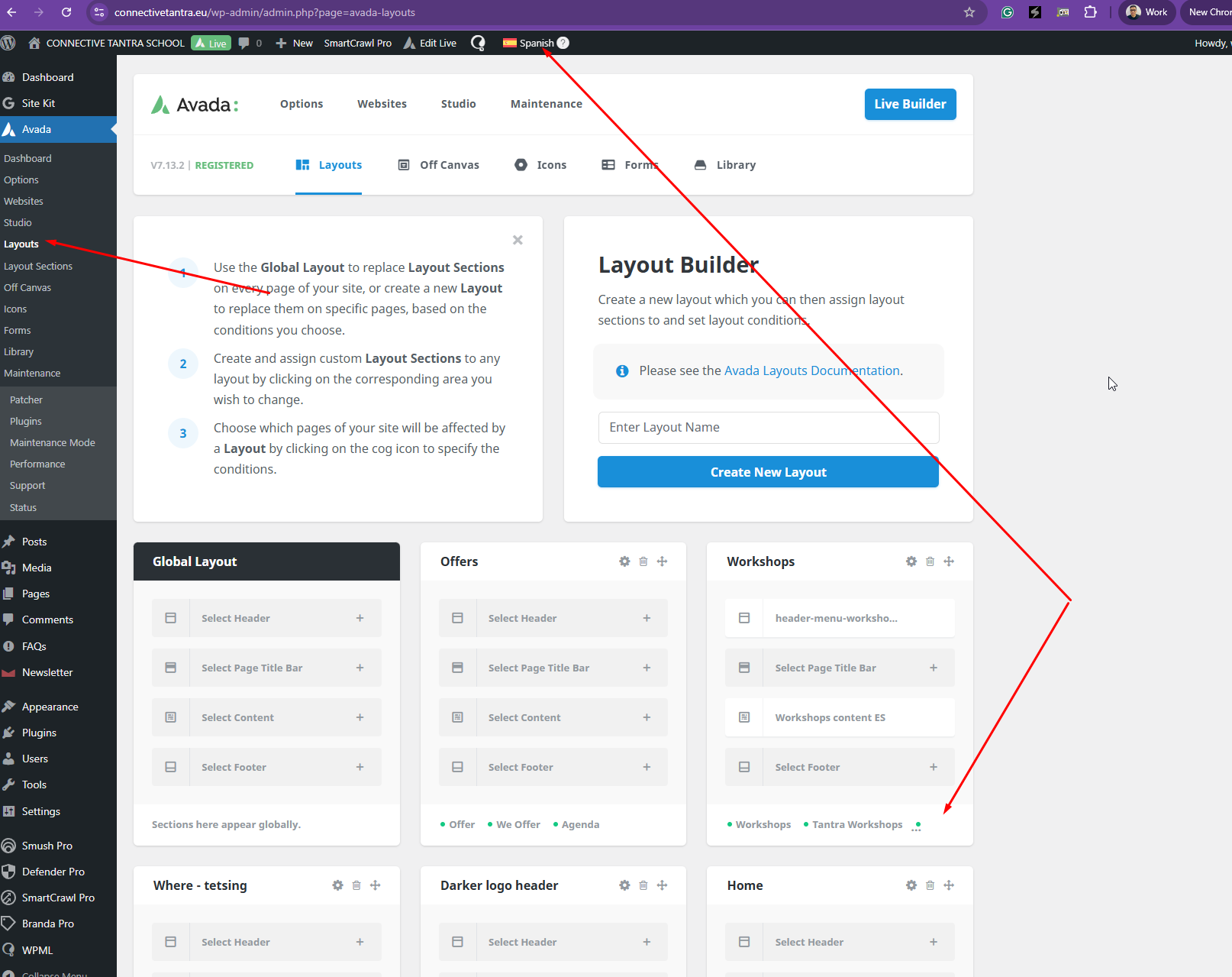

Thanks for your patience. I've edited the English language page here and in the "Avada Page Options" below, it says that "This Post is currently using a custom Content Layout Section. Go to Layout screen, or edit your Workshops content" as shown in the attached screenshot.
But when I edited the Spanish language page here hidden link , it is not using any Custom Content Layout Sections.
Could you please translate the "Custom Content Layouts" here hidden link and let me know if it fixes it?

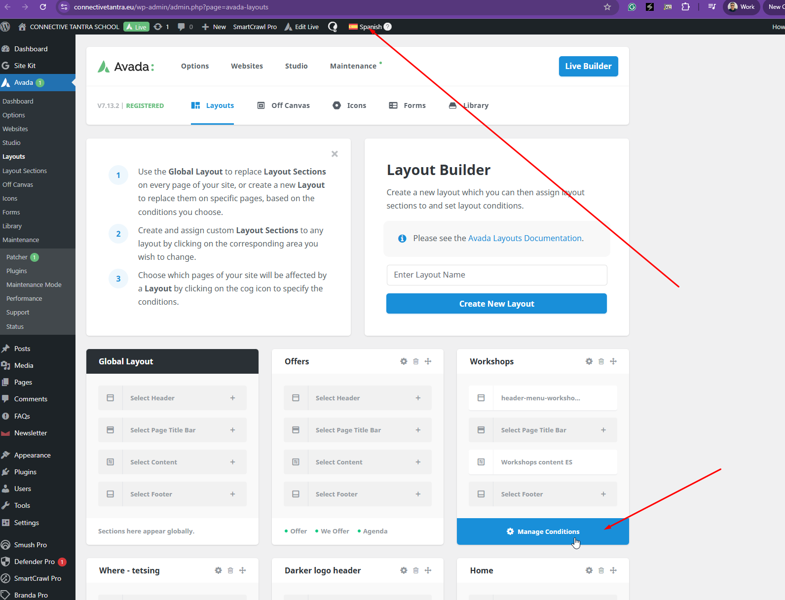

Thanks for your reply. I've adjusted the layouts here hidden link as shown in the attached screenshot and it seems to work now. Could you check?

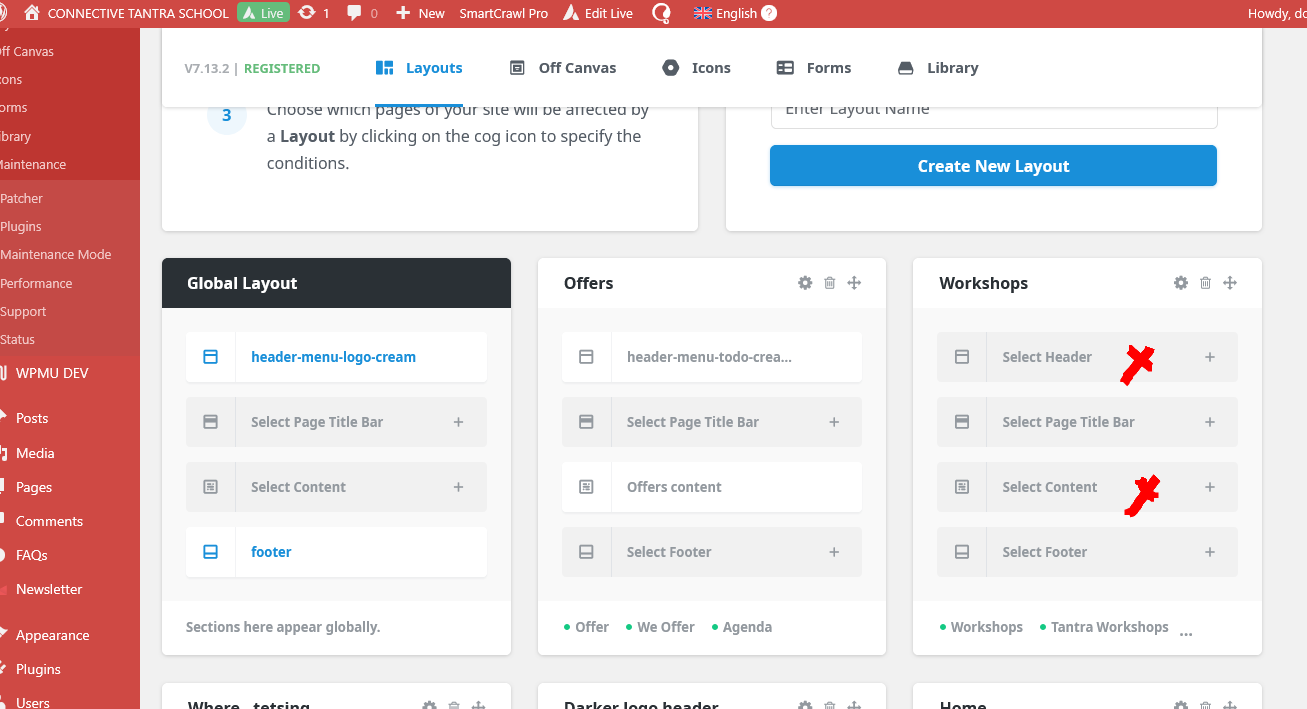

What I see now is:

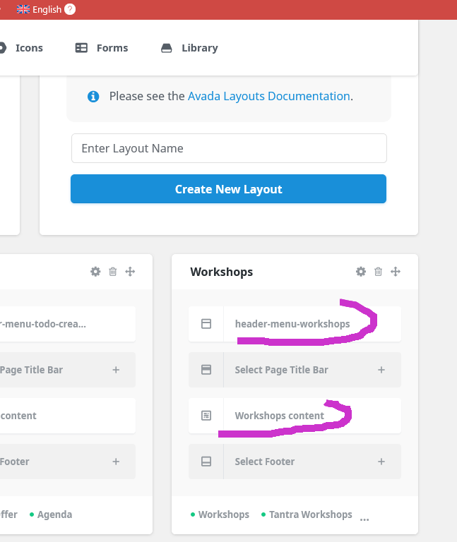

1) The Avada "Workshops" layout in English are "gone". Please check the screenshot.
2) I updated the Eng post hidden link and then re-saved the ESP translation. Still not working ok.
Looking foward for the workaround! As I cannot keep on working on the website!

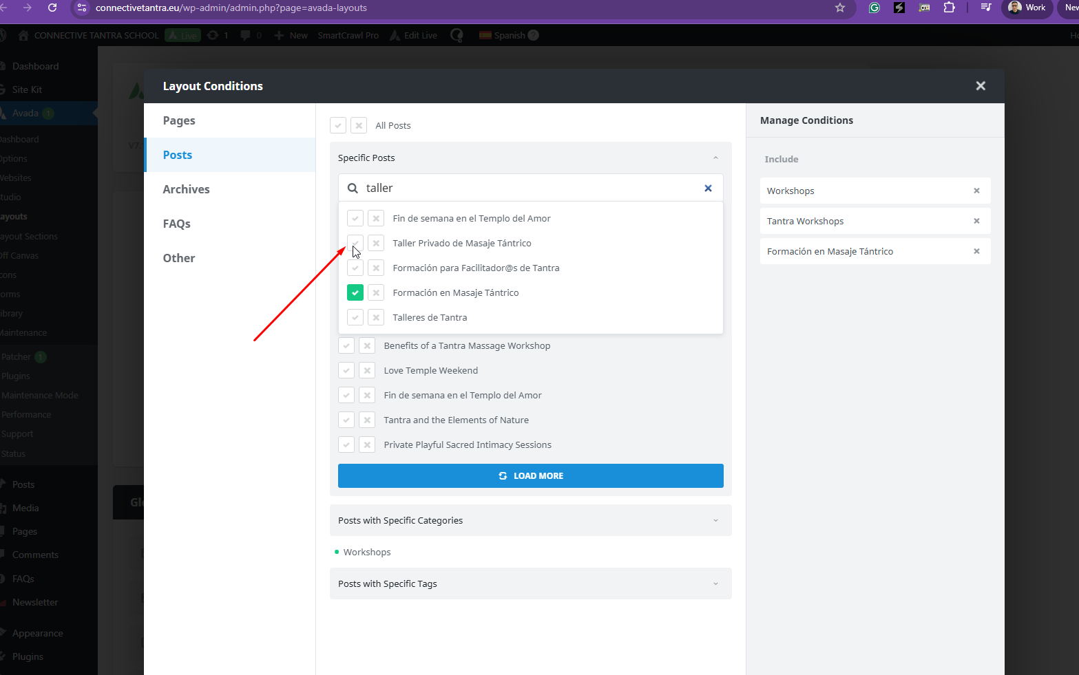

Thanks for your reply. I've added the post in the conditions as shown in attached screenshot and it's displaying correctly now on your Spanish post here hidden link . Could you check?

Thanks for the workaround. It seems to be working now.

1) The ENG layout sections "vanished". I´ve just re-added then myself but I fear future conflicts.
Which layout are you referring to? Can you share screenshots?

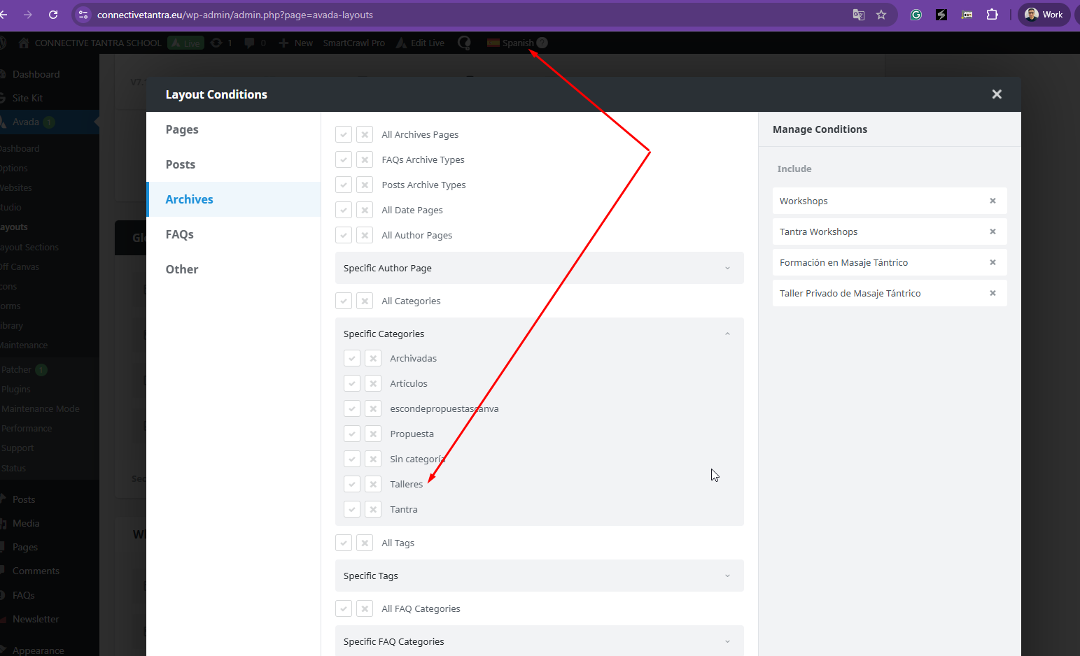

2) The layout already had a wider condition for all the posts with "Workshop" category. So, it should not be necessary to add each individual post by hand! With your workaround, I´ll have to add each new post I translate? 🙁
Could you try adding the "Spanish" > "Talleres" category into the condition and see if it works? (refer screenshot)

1) Shared. I had already mentioned this. I´ve re-assigned the sections manually after your workaround.
2) Yas! That wrked out fine, thanks!
