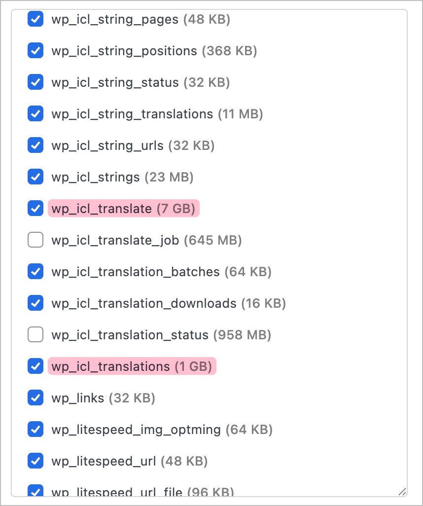

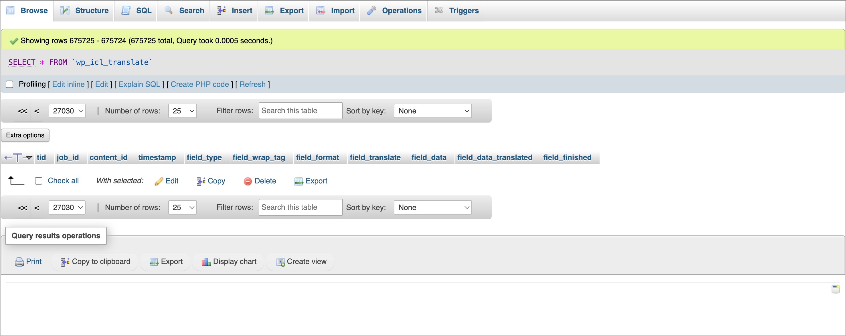

Another thing I noticed is, that the table wp_icl_translate is super huge!
May be related with the backend issues, may be not.
I've attached some screenshots.

Is there any way to reduce the size of those tables?
Something must have triggered it to get so big?
The screenshot I sent I found was actually already a year old, the database was comparatively small then. I just checked and the current table is 7GB big. I can't even export my database anymore with that amount of data.
