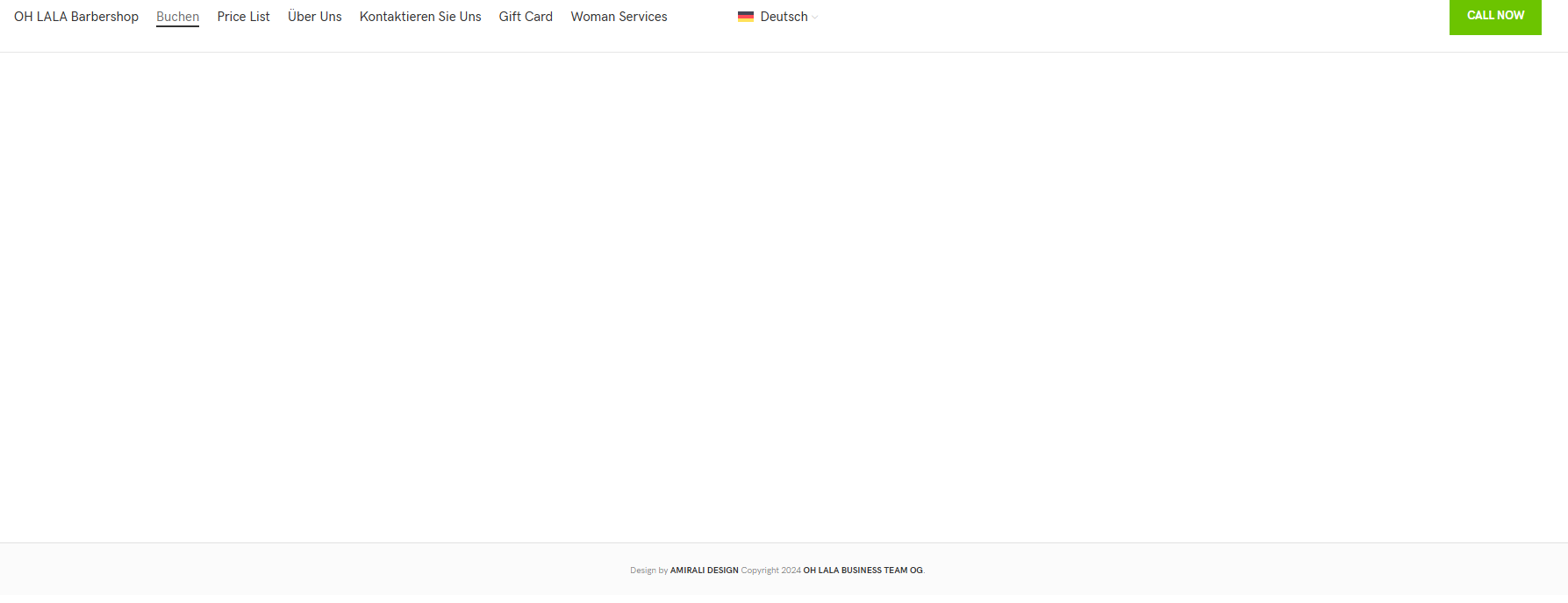

The client was experiencing an issue where the booking page appeared white and empty when viewed in languages other than the default. Additionally, there were problems with logos not displaying in other languages.

I am using a booking system on my website hidden link and I am trying to manage bookings in multiple languages using WPML.
My booking page is displayed white and empty when viewed in languages other than the default.
How can I resolve the issue of the booking page appearing white and empty in other languages?

Why am I not getting the right answer?! I did all the things mentioned and still there is a problem! I have to deactivate the plugin.

I checked it and it looks like the booking is loading content from an external source directly in the site, I can see this when I edit that page:
<script src="//widget.simplybook.it/v2/widget/widget.js" type="text/javascript"></script>
I'd like to check with you where are you able to edit the booking for the original language. Let's say you needed to change a string in the booking widget, where in the site do you go to edit it?

majidN
In the reservation software!
I don't care if the booking page is translated!
It means that in German language, the reservation page is also in English, it is ok.

Since it is the only content in the page, I went ahead and duplicated the booking page into the secondary languages.
That fixed the issue, the booking is available in the secondary language as well, kindly test it again.
