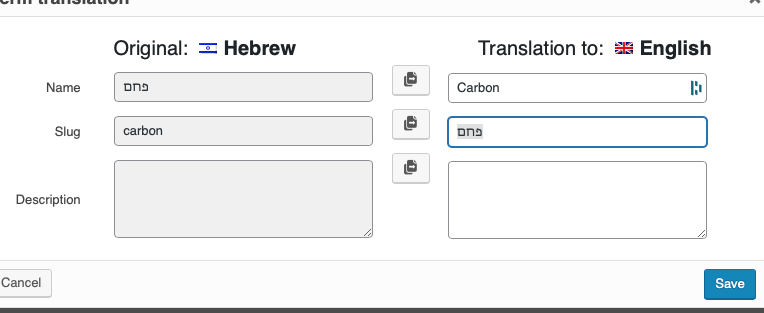

When i run bulk edit on products with a specific attribute, the bulk edit process change the attribute value to a different value (attribute value the wpml create itself for the first time)
Here is a video that reproduce it - hidden link
I found that the reason is that the slug for the attribute value is the same as the attribute name in a different language, which cause the attribute to be recreated.
When i changed the slug in english, the issue didn't happen

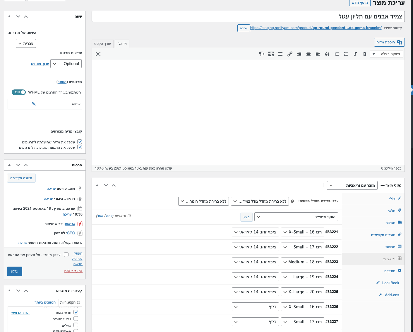

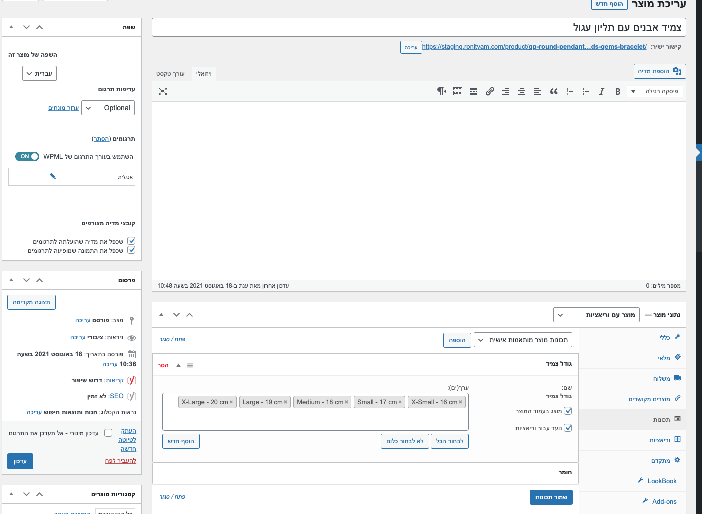

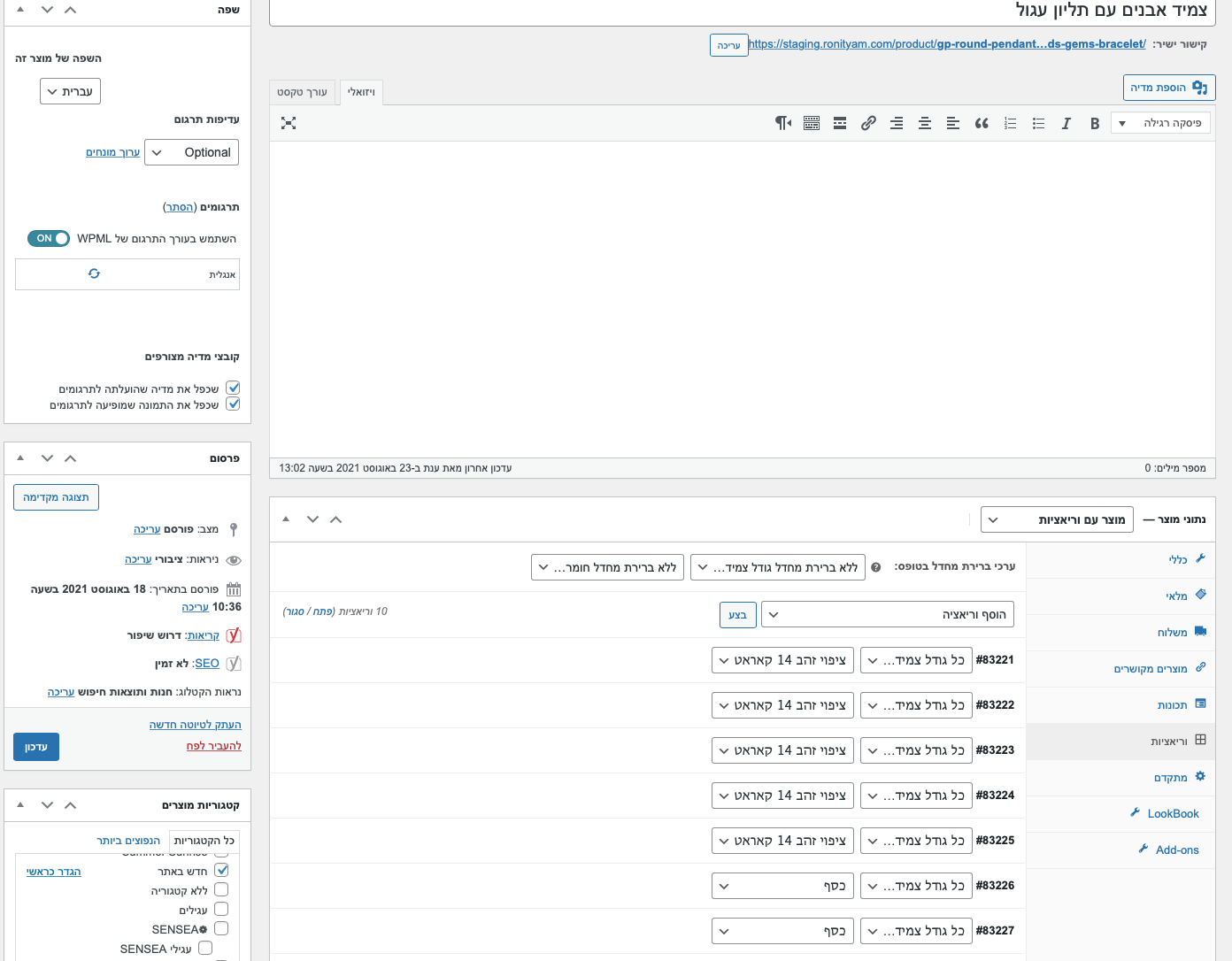

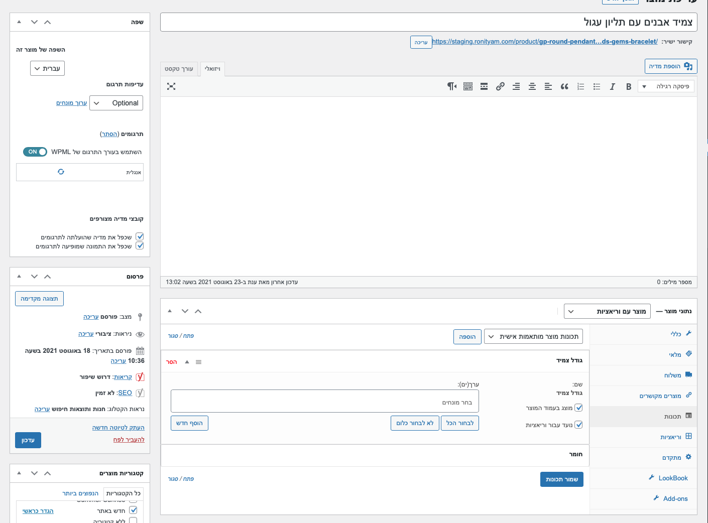

I have another issue related to bulk edit, when i run bulk edit (without changing any parameter, just save the product through bulk edit) on product with a specific attributes, after i save product attributes/values and variation disappear, i don't have any slug issue in this attribute and can't find out why this is happening and won't be able to reproduce, I can give you access to our staging environment or we can use duplicater

I´m sorry for the delay to respond. I was on leave and this ticket got missed. I can reply that the issue is not being "ignored" as it does not have the status of "will not fix" but there may be other priorities that have delayed a fix.
I have set this ticket to "escalated" and it will remain attached to the internal work ticket.
For the 2nd issue, which seems related and might be the same root cause, I have opened a new ticket to investigate it separately.
