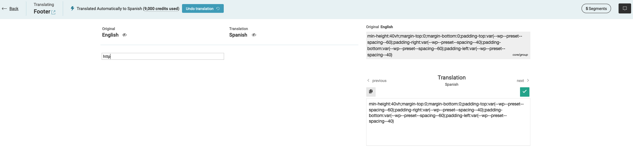

Those settings seem to work when we're referencing hrefs in core blocks, but WPML doesn't seem to want to translate hrefs in custom blocks. So we've got the following wpml-config (image 1).
This works on our core paragraphs in the footer, because the url I've linked to doesn't show up in the translation manager at all and shows up correctly on the rendered page (image 2, image 3).
With our custom blocks, though, the url *does* show up in the translation manager, which makes me think it's not being picked up as a link that can be translated (image 4). The destination URL does definitely have a translation (image 5).
This is the core problem. Our custom block text fields show up for manual translation fine when defined in the wp-config, but the links are not automatically translated.
I'm not sure what the difference could be in how WPML is handling the core paragraph block (markup in image 6) and the custom block (markup in image 7). Maybe it treats the key element different than the xpath element or doesn't like that these values are in attributes?

OK, I've uploaded our theme, which contains all the blocks. The site exhibits the same behavior: core paragraph blocks in Footer display no links in the advanced translation editor, I assume because they have been automatically translated. (image a, image b).
Custom blocks like front-page-carousel in Front Page display links in the advanced translation editor, so it appears they have not been automatically translated (image c, image d, image e).
