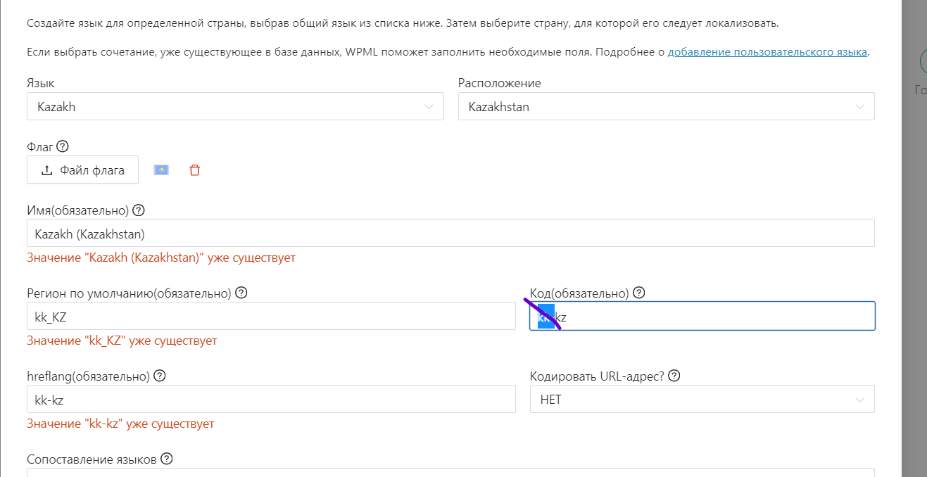

Hi, I have just installed WPML and trying to add Kazakh language to my website as a second language.
To have good reading url I would like to have a language code /kz insted of kk-kz. How can I do it?
Currently the system does not allow me to change the code but leave other settings like hreflang etc as it is.
Please find screenshot attached.

Once a language is added to the system or if it's one of the pre-loaded languages the language code cannot be changed.
Please go to WPML->languages->Edit languages->Add a new language and from there add a new language that will use the language code 'kz'.

January 24, 2024 at 8:19 am #15220084
vitaliK-3
But I cannot finish insatllation without any languages added.
Should I add wrong language, and after installation remove it and add my custom?
Would it be recognized by the system for the Automatic translation?

Yes, that is correct, if it is a new installation, I recommend the following:
1. Add your default language of course
2. Add the secondary language you need or a random one that is ok.
3. Finish the installation of WPML and now head back to WPML->Languages->Edit languages and add the custom language.
Once done you can map the language to use the automatic translation
https://wpml.org/documentation/automatic-translation/using-automatic-translation-with-custom-languages/
