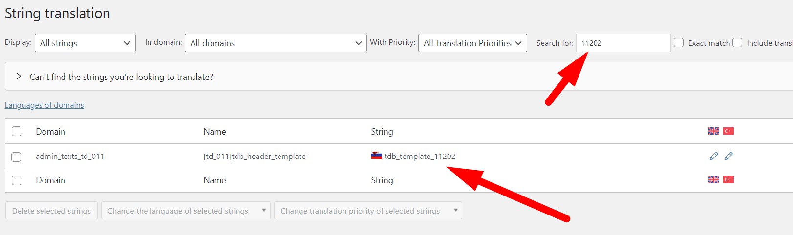

Then I go to Admin Texts Translations and try to seek for Russian records 11204, but it is not available, like in the previous times. Instead of it, an English template ID 11202 is now available!
So, I hoped that the issue is resolved, but it is not!
When I see the ID 11202, it is marked not as English translation, but as Russian translation (see the screenshot attached). And it offers me to translate ID 11202 into English and Turkish languages.
I see it is possible to change the language of the string. But I decided to follow your scenario.
So I deleted the string. It showed me warning that the translations will be deleted too. But in fact the translations were not deleted. All the templates in three languages were still there. So I did not have to create a new headers.
Then I went to WPML-> Theme and plugins localization, selected my theme Newspaper and scanned it.
From the Admin texts translations I added the record 11202 to string translation.
And now it was assigned English language and it was set as global!
