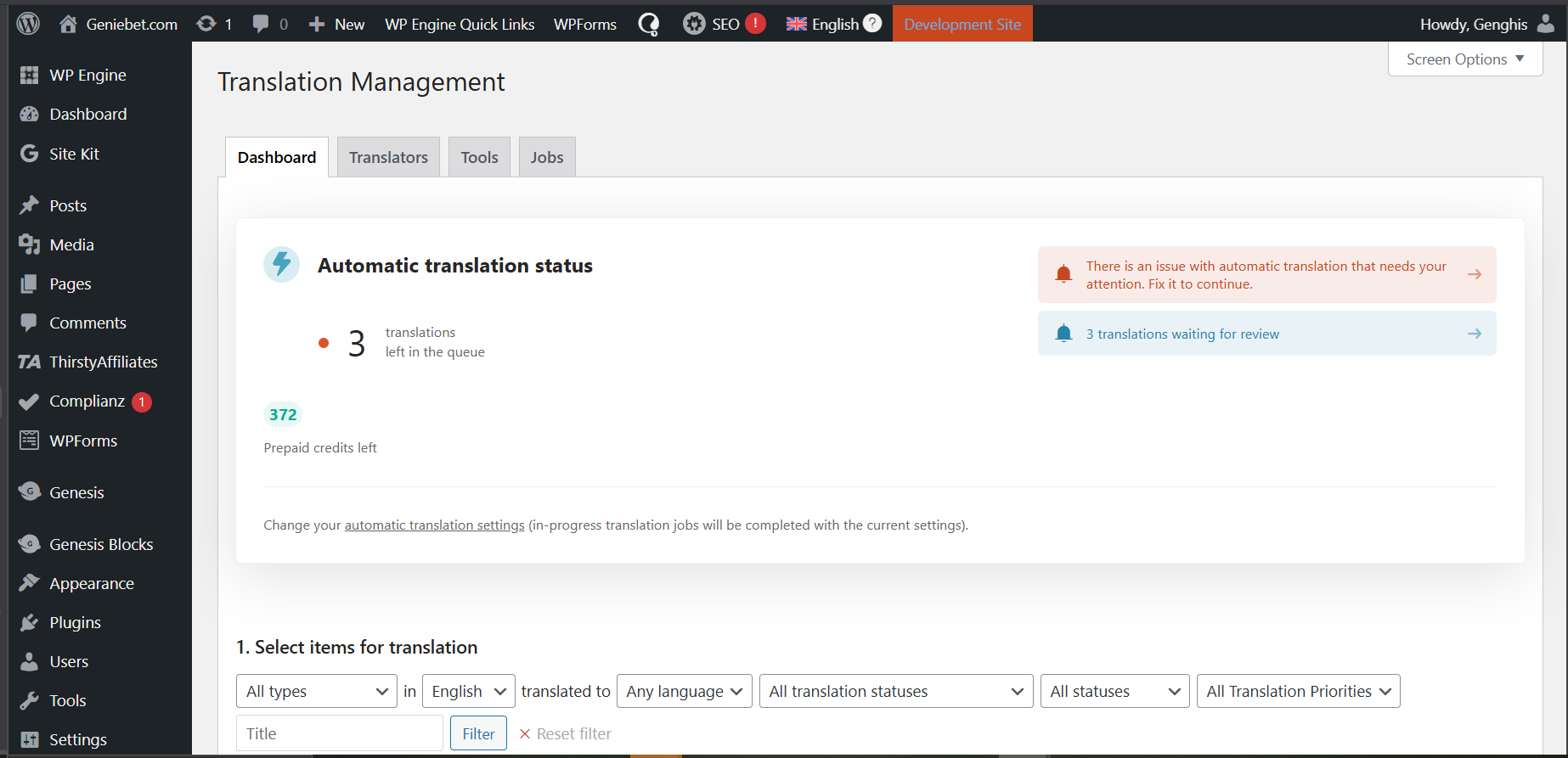

aodhagang
I have implemented the solution suggested by one of your agents for automatic WPML registration using PHP for easy moves between production, development, and staging as per this guide: https://wpml.org/faq/automatic-wpml-registration-using-php-for-easy-moves-between-production-development-and-staging/.
In staging, I can't use my translation credits. WPML translation shows I only have 372 credits left, but my WPML account indicates I should have 68904.
How can I fix the issue of incorrect translation credits in staging?
How can I prevent this issue from occurring again?

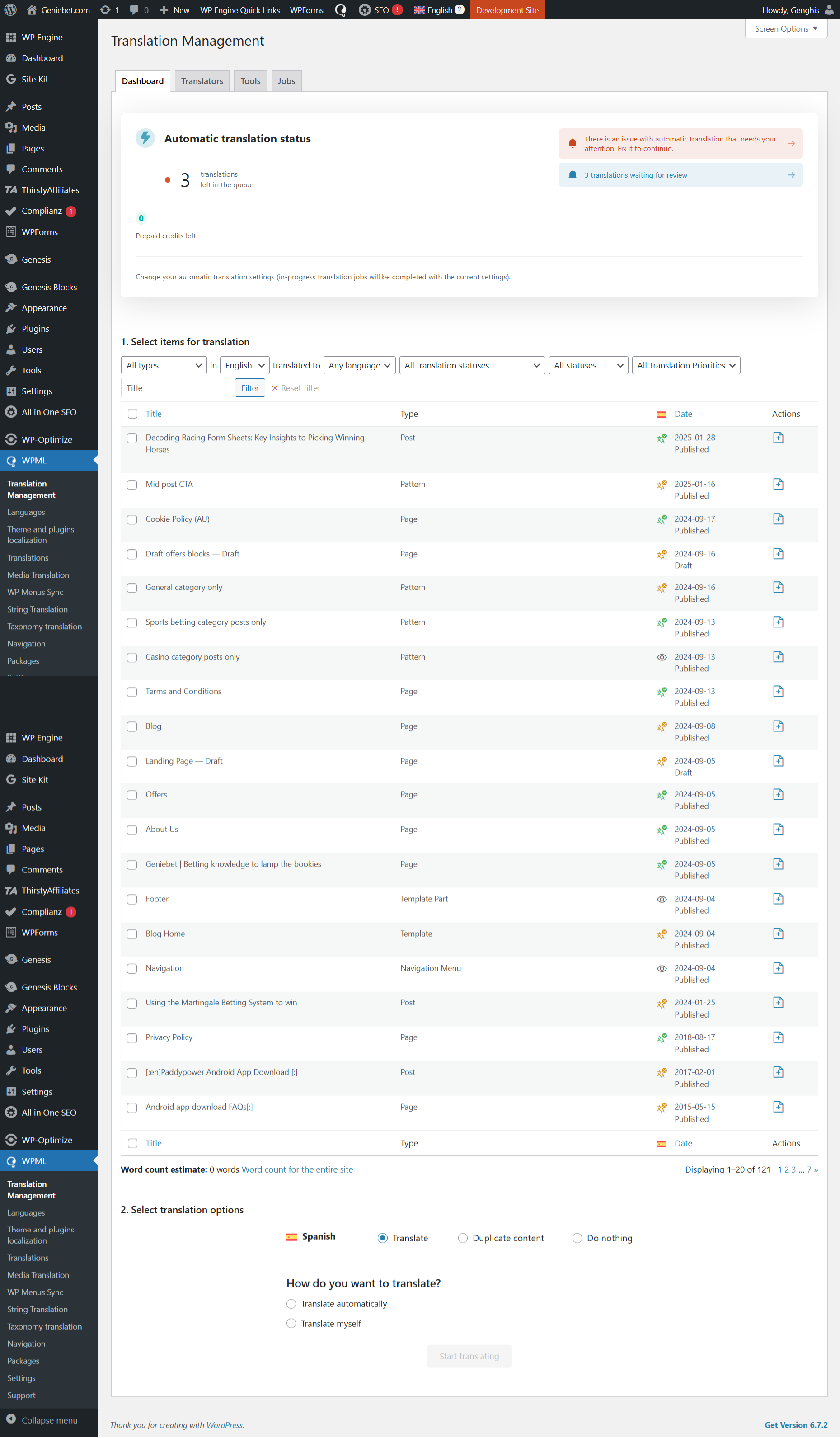

March 14, 2025 at 4:36 am #16814310
aodhagang
Some screengrabs attached.

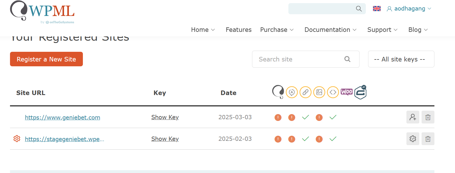

March 14, 2025 at 4:46 am #16814361
aodhagang
+ my account showing I have 60K credits on staging.

Thanks for getting back. The site keys for your websites are okay, but when you moved website, it created a new instance in our ATE system, since it looks this a new website / copy of your production that you moved at the time. Now you have real staging site but in your WPML.org still old instance is showing.
I am afraid this a known problem, and we are working on improving this process when moving website from staging to production and viceverse.
Now the best way, would be to unregister your website from WPML.org, unregister key from staging site and then re-register it again, so you see correct website under your profile and add credits.
I know this is not the solution or reply you expected, but we are working on improving this in the future versions.
