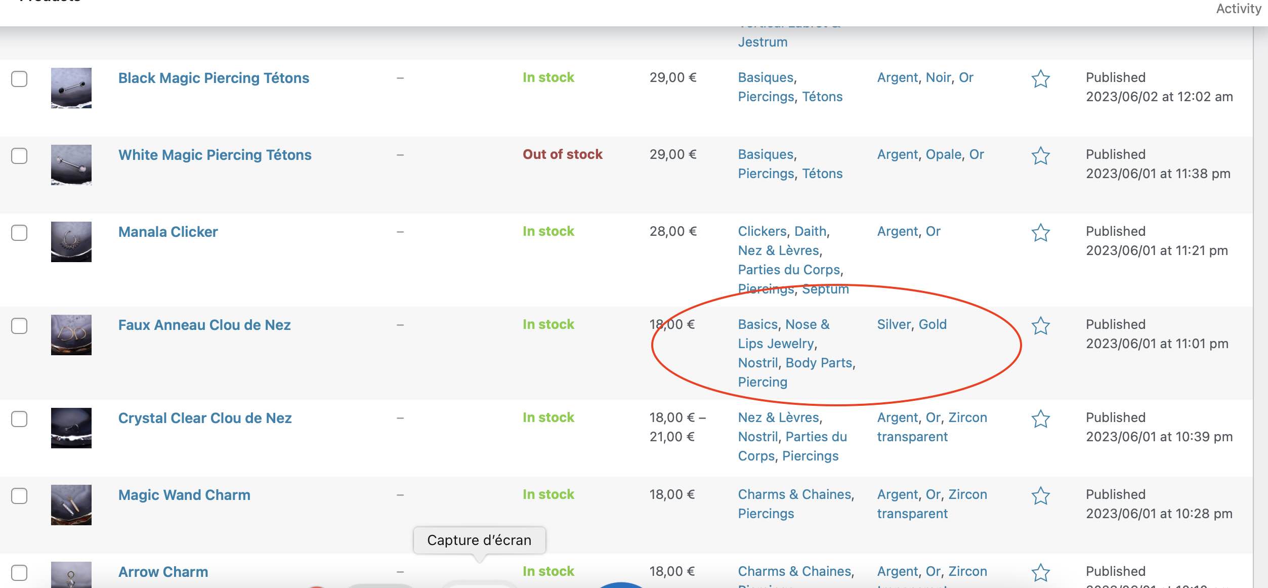

When I tried to update some products I realized that they are linked to the wrong category language. Which is creating messed up links. See screenshot Ex : hidden link - this is my staging site that is up to date - the category "body parts" and "nostrils" are English.
It also mess up with the variation which is causing some products to not be available to my customers (variations are not appearing or cannot be clicked on). See screenshot.
This is completely random, it does it in random product without reason or without I did anything. I have to check ALL my product regularly to make sure Its correct and re-enter the variations sometimes. This is super annoying and it last since 1 month, since my former host provider has migrated my website to a new server (I dont know what they did exactly).
