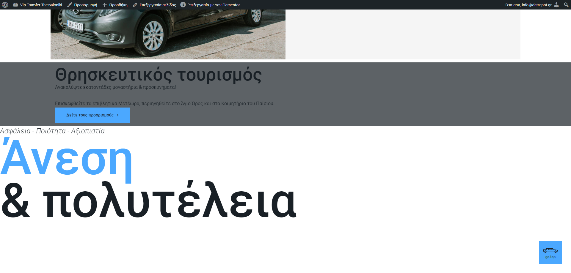

I am trying to translate a section in the homepage.
No.
In homepage, there is a section similar the one I am trying to translate.. The first one is translated correctly, but the second one does not. I could see the changes I have made in the backend of Elementor, but in the frontend It does not appear correctly. I guess the theme has some custom blocks or something that I could not translate properly. I believe something in the settings of WPML could help me solve my issue. Screenshots attached

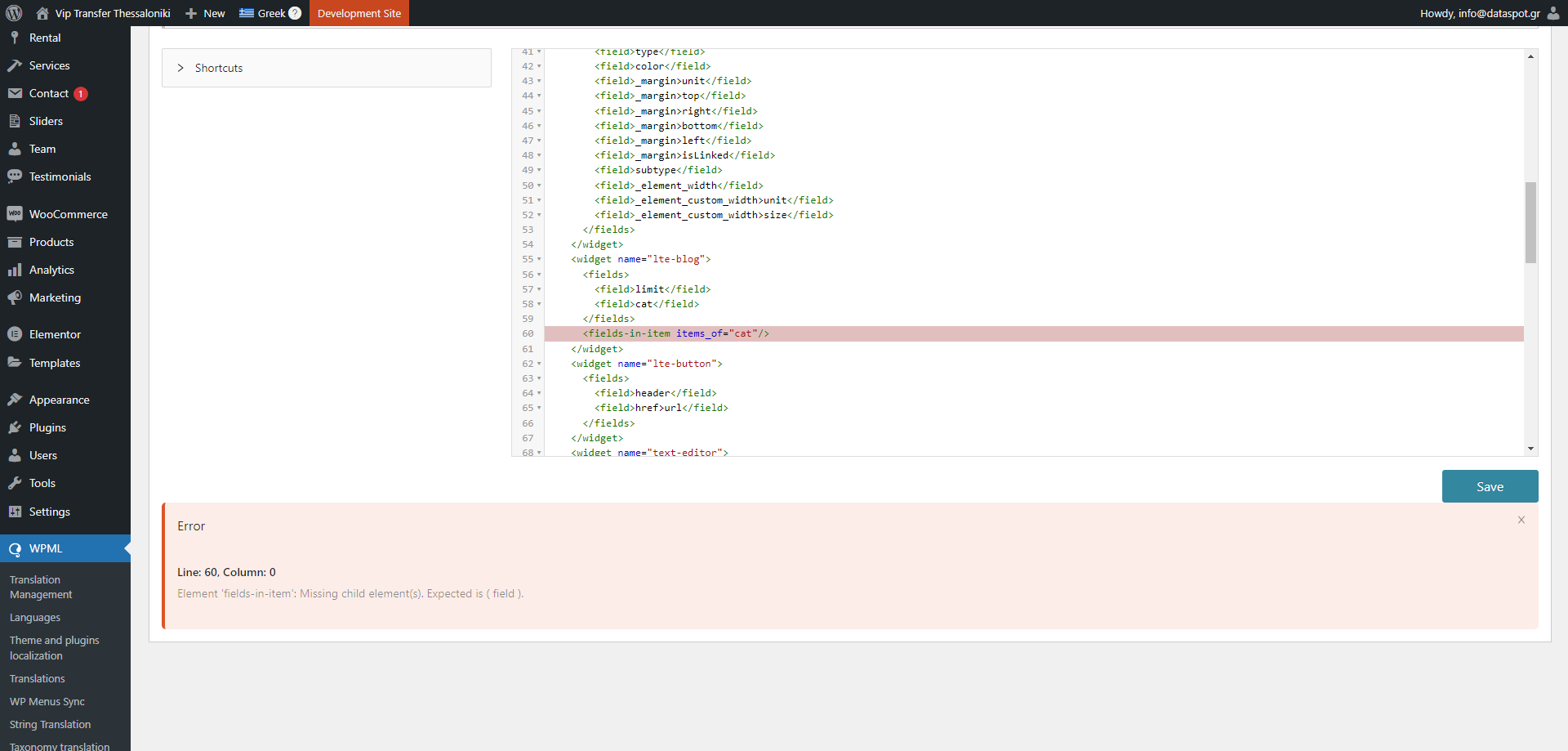

I did increased the memory limit and update the theme and plugins too! My main issue is: I see the edit Elementor page (backend) correctly but not at the frontend. I saw the the screen of the guide you are talking about, and I could translate the texts, fields and so on.. but still the frontpage is like broken..
Thus, I tried to delete the translated page (English - main language is Greek) and the sections causing the issue, and did the guild from the beginning. I did not see any deference.. I have an error at the Custom XML Configuration (attached screenshot) I do not understand what is about.
Moreover, I am thinking to change the section that is not display correctly, in order to understand better what causing the problem.. I guess the error in the screenshot is about the categories of a custom post type "rental".. I have already translated the categories and other taxonomies! trying to figure out what happening.. Any ideas or help, would be welcome

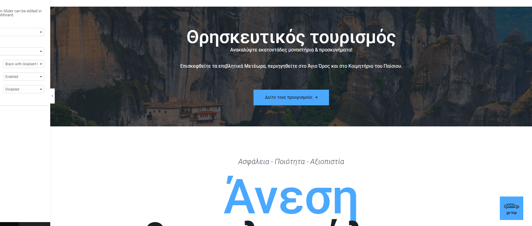

Couldn't find any solve to my problem.. Thus, I have change the section that might causing the problem.. And now translations and frontpage are working as expected. Thank you for your time and guidance anyway. Last quick question please: Could I delete the Multilingual Tools plugin safely? I believe I do not want that, right?
