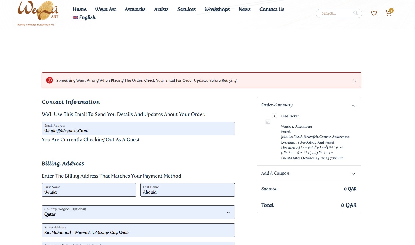

October 27, 2025 at 1:40 pm #17522246
bahaaB-2
I am trying to complete the workshop checkout process on our live website. The issue can be seen at hidden link. I expected to see a redirect to the 'Thank You' page after an order is placed.
An error message appears after checkout, but the order is placed successfully, and the confirmation email is received. The user is not redirected to the 'Thank You' page. The issue resolves when the WPML Multilingual CMS plugin is deactivated.
Why does the error occur during the checkout process with WPML active?
How can I ensure users are redirected to the 'Thank You' page after checkout?

1. Does the issue persist when all plugins are disabled except WPML and WooCommerce?(yes)
2. What happens if you create and test with a new product?(it will work with woocommerce products properly just the workshop tickets(product) will show this error(we are using eventer plugin to create these types of workshops.
try to buy free ticket from here and check the error(hidden link)
3.Wordpress debug log file doesnt record any error
Note:The full process was working properly before suddenly the error is showing now however we as admin and client receive emails and order is placed successfully in the woocommerce orders

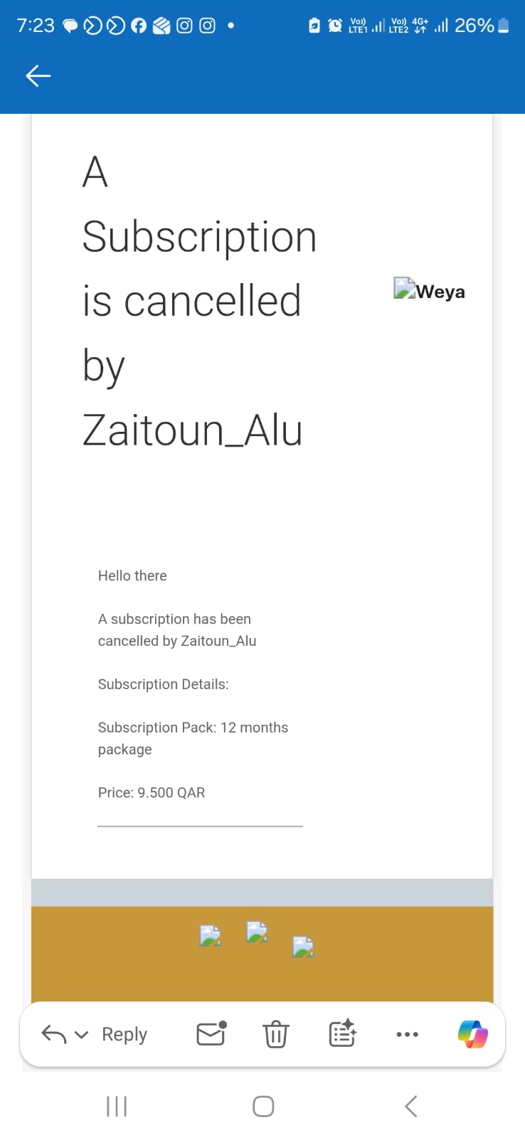

October 31, 2025 at 10:56 am #17535562
bahaaB-2
Hello
Did you disabled yesterday a vendor by this user?cause we have received this email attached
