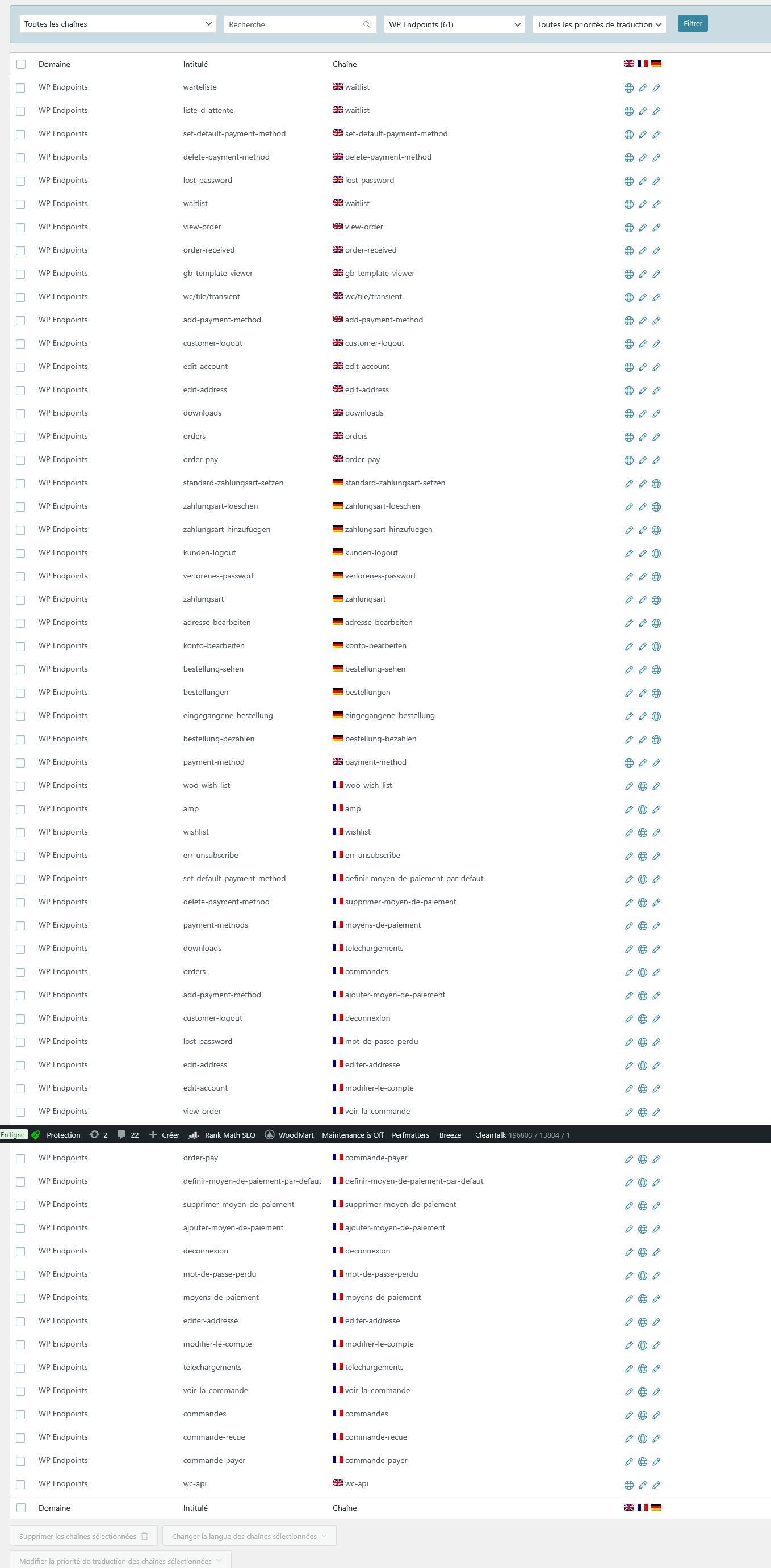

What I did:
deactivated all but strictly necessary pluings - no effect
retranslate all endpoints (see attached) - no effect
clear / flush all caches - no effect
wp / permalinks save - no effect
All in all, it's normal in French (original language), in German (translated via WPML) but not in English (translated too)
The last point suggests an issue with English when considered as a translation, WP and WC being natively English

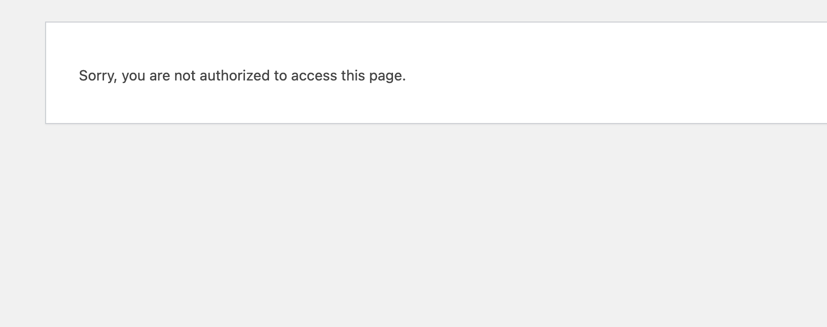

Was our access altered I no longer have backend access to continue with our debugging process, see screenshot below.

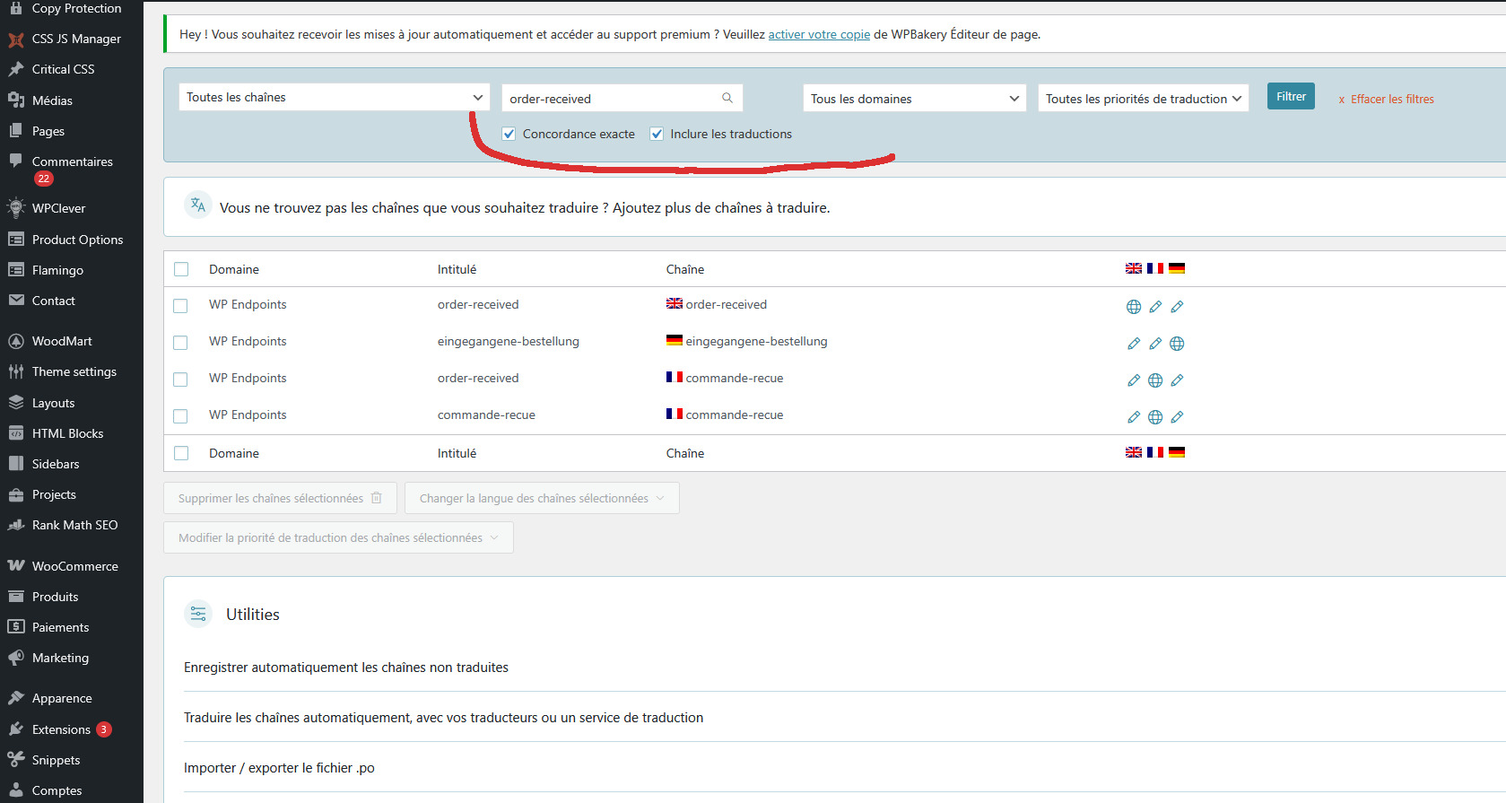

1. Go to WPML->String Translation -> Search for 'order-received' and check both boxes Exact match / Include translations .
2. You will get 3 results
3. Select all three and delete them
4. Refresh the page, navigate to the dashboard and then navigate back to WPML->String Translation.
At the very top you will get a new string entry for commande-recue and it will be under the English language.
5. Select it and click on "change default language of selected strings" and change it to French.

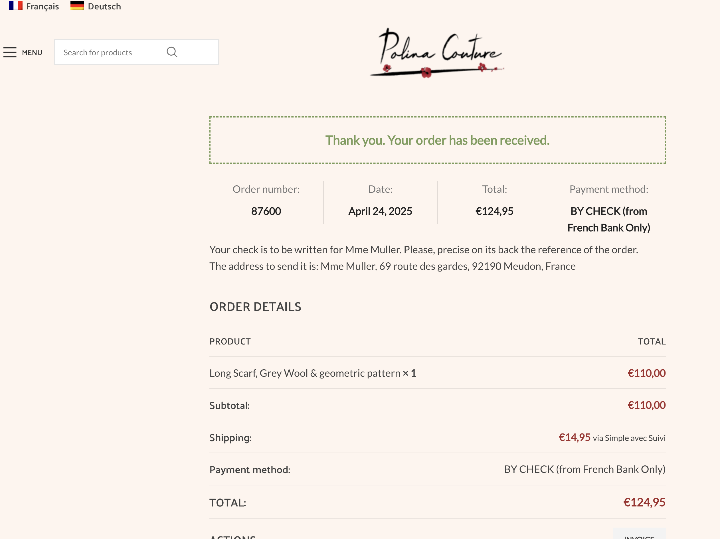

It looks like it works ok for me now.
Let me know if you can follow the same steps on the live site, please.
