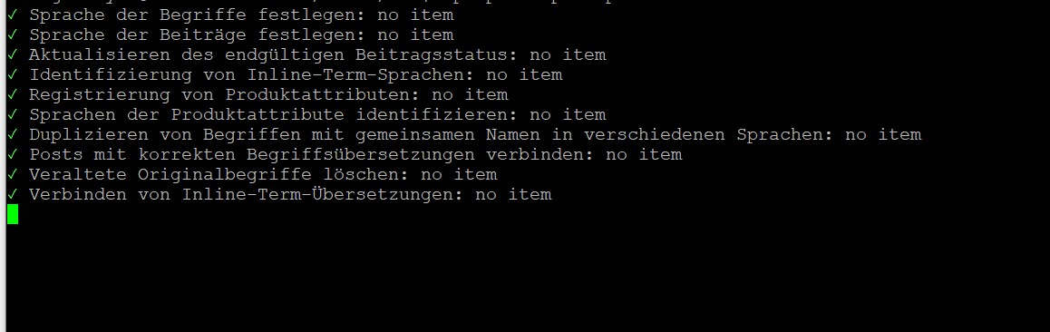

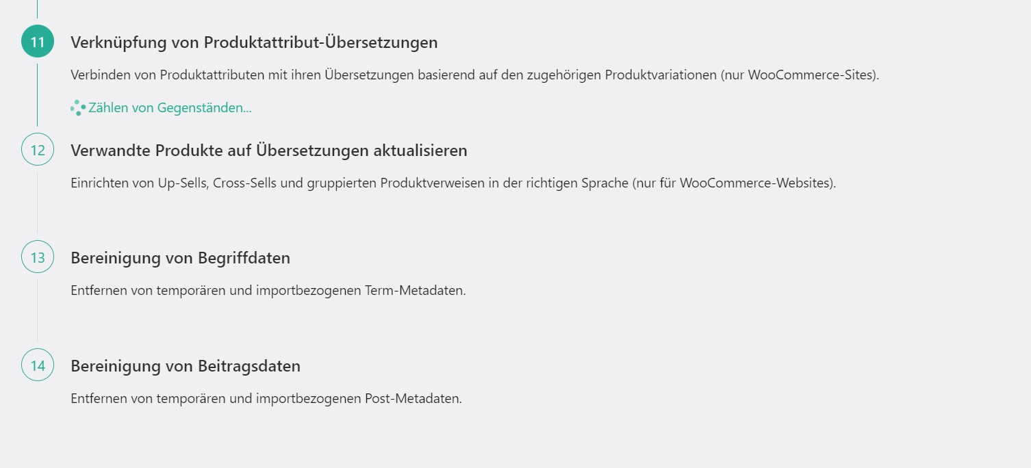

i did import several product variations (9000) with the new parameters and the linking set up via wp all import and tried the cleanup afterwards, but no, it won't finish, neither in the cli nor the wp backend. There are no errors either, any possibility to enable logging to further understand the issue?
no it always stops at counting "Linking of product attribute translations" in the backend and won't even show starting this step on the backend.
both processes time out after about 10 minutes. The cpu processing time can't be an issue (5950x ryzen). So it has to somehow end up in a loop. I could run xdebug on it when you tell me where to look.

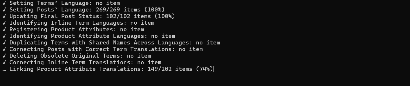

I tested multiple times with WooCommerce products and noticed that the process got stuck at the "Linking Product Attribute Translations" step. However, when I performed the same action from the WordPress UI, I did not encounter the issue.
During my investigation, I noticed that the process got stuck at 149 items (check the attached screenshot). However, When importing from the UI, 149 items were imported, but the rest were skipped(Screenshot: hidden link). Despite this, the process didn't get stuck in the UI. Also, there are no errors being logged in the debug file.
Therefore, the issue with the CLI could be caused by the items being skipped.
Before I escalate the matter to the 2nd tier team, could you please check if any items are being skipped during the import process from the UI? Once I receive your confirmation, I will escalate the issue and take the necessary actions to resolve the problem.

actually my process stops at counting. So counting fails and the actual linking never starts.
