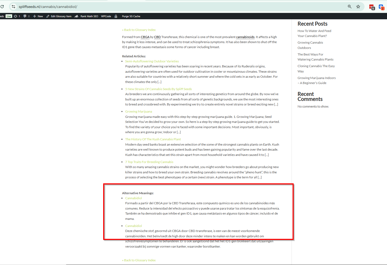

I am working on a live website hidden link and trying to remove CM Tooltip Glossary Spanish and Dutch translations from the original English page using WPML.
CM tooltip shows translations on the original English page.
How to remove the Dutch and Spanish transalation from the English page.

Thanks for your reply. I've checked this page hidden link in the backend, and could you tell me how the contents on the frontend are displayed? hidden link
In the backend, I can only see one paragraph of text.

Thanks for your reply. I’ve deactivated some unrelated plugins to make the troubleshooting process easier.
I’ve checked this page again hidden link
and I can now see the Articles and Meanings sections.
Could you let me know how the “Related Articles” section is being populated with posts, and how the “Alternative Meanings” section is filled with Glossary items?
December 4, 2025 at 8:59 pm #17636202
Marcel Elbers
I think the related articles is set in the CM Tooltip plugin settings under >Glosssary Term>Glossary Term - Related Articles>Show custom related articles
Alternative Meanings i think this is set under General Settings>Display Alternative Meanings on Glossary Term Page.
Does that help?
Thank you,
2025-12-04 21_57_02-iMUIS Verkenner 4.7.9d_ - [60463] Spliff (meijers) (ts.imuisonline.com).jpg
2025-12-04 21_57_59-iMUIS Verkenner 4.7.9d_ - [60463] Spliff (meijers) (ts.imuisonline.com).jpg
The topic ‘[Closed] cm tooltip shows translations on original page’ is closed to new replies.
