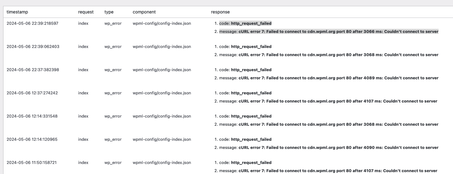

Hi WPML team,
I've been encountering these WPML errors for about two weeks:
Code: http_request_failed
Message: cURL error 7: Failed to connect to cdn.wpml.org port 80 after 3066 ms: Couldn't connect to server
I attempted to delete the key from WPML and connect WPML with a new key, but without success. I still encounter the same error when trying to update.
Could you please help me identify the problem?
Thank you.
