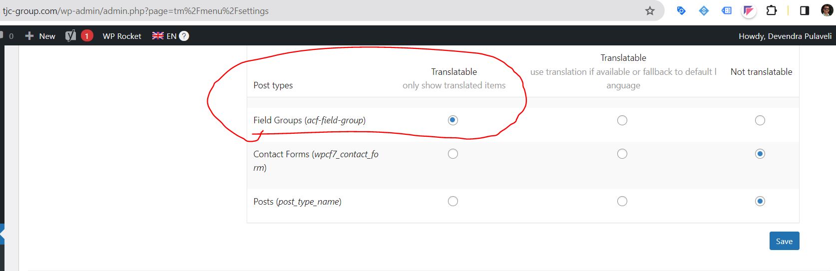

lauraP-35
Hello
We have set the field group to "Translatable - Only show translated items" but still it is not working. We are not able to update or add content. The fields are not fetching updated content. I would request you to recheck the backend and let us know the solution. We already shared you the backend access details.

I hope this message finds you well. Thank you for sharing the access information, which has allowed for a thorough review of your current content translation setup.
In one of my responses(#15342128), I highlighted a crucial aspect concerning the translation preferences for the ACF Field Group post type. If the translation preference for the ACF Field Group post type is set to "Translatable", then you will need to manually(Using WordPress Editor) translate the page. If you try to add/update the Translation using WPML Translation Editor, the translated contents will not appear there as expected. For a comprehensive understanding of the manual translation process, please refer to the following guide: https://wpml.org/documentation/translating-your-contents/using-different-translation-editors-for-different-pages/.
Upon further investigation, I noticed that the translation methodology for your pages varies; some have been translated manually, while others have used the WPML Translation Editor. An exemplar case is your Homepage, which was initially crafted in French and subsequently translated into English manually. After that, the default site language was changed to English.
Now, if you prefer to use the WPML Translation Editor for future translations, it is advisable to adjust the translation preference for the Field Group Post Type to "Not Translatable." This adjustment will allow you to translate content using WPML Translation Editor. It is also important to note that upon setting the ACF Field Group post type to "Not Translatable," and translating a page using the WPML Translation editor, all translated content is added within the main field group, not in the translated one. You can check the "WPML Test" page, where both main and translated field groups are visible, yet the translated content appears only within the main group.
Based on these findings, I recommend the following strategies:
1. For "Not Translatable" Preference:
- Both default and translated field groups will appear on all pages, enabling the use of the WPML Translation Editor for content translation. It is important to note that content translated via the WPML Editor will be added only to the default field group. You can remove the translated field group that doesn't have any content. For the contents that have been added manually in the Translated field group, please don't delete the Field group as you will lose the contents that you have added manually.
2. For "Translatable" Preference:
- Only the translated field group will be visible, but, you can only translate contents manually. If you use the WPML Translation Editor under this setting, the translated field group will not capture the translations, as field groups are treated as separate entities upon translation.
It is essential to weigh these options carefully and choose the one that best aligns with your workflow and content management practices. if you have any questions or require further assistance, please do not hesitate to reach out.
