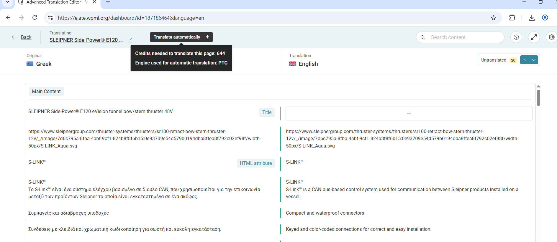

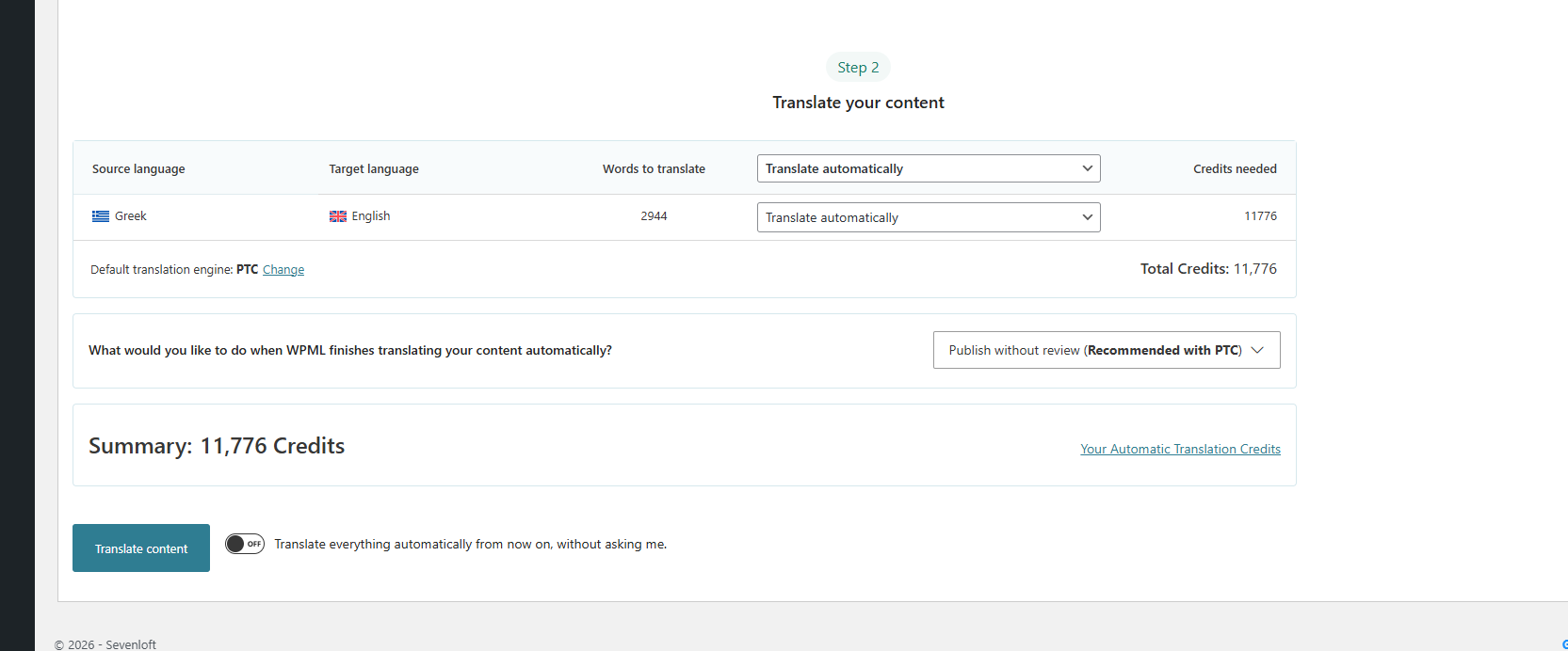

When going to WPML > Translation Dashboard and sending the product for automatic translation, it was asking for 11,776 credits for the translation (see translation dashboard.png).
However, if I try to translate the product directly (by clicking the “+”), it only asks for 644 credits, and most of the fields are already translated, which means that the “translation memory” actually works. (see ate,png)

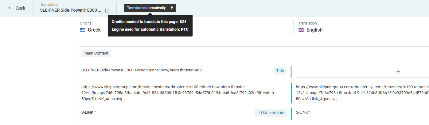

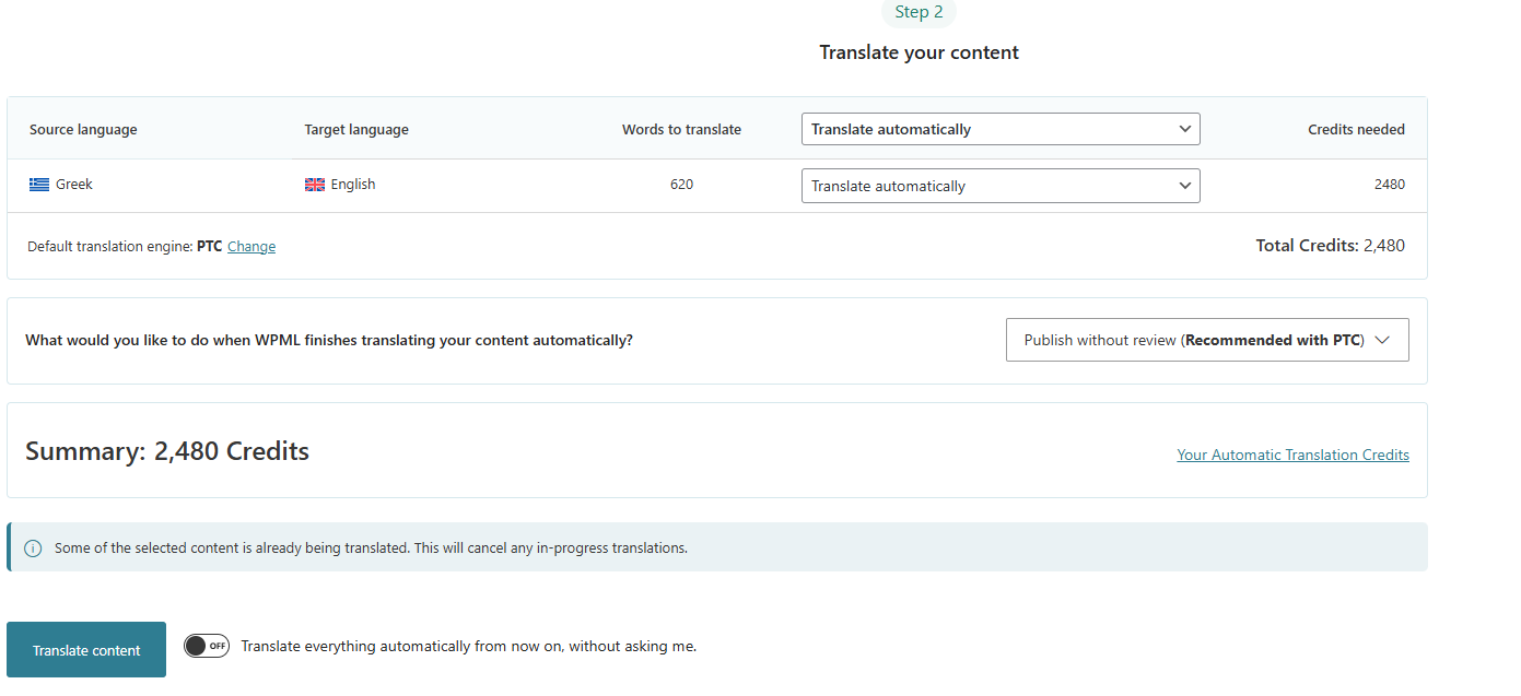

i tried to translate another product and still got the same issue. See the screenshots i uploaded.
