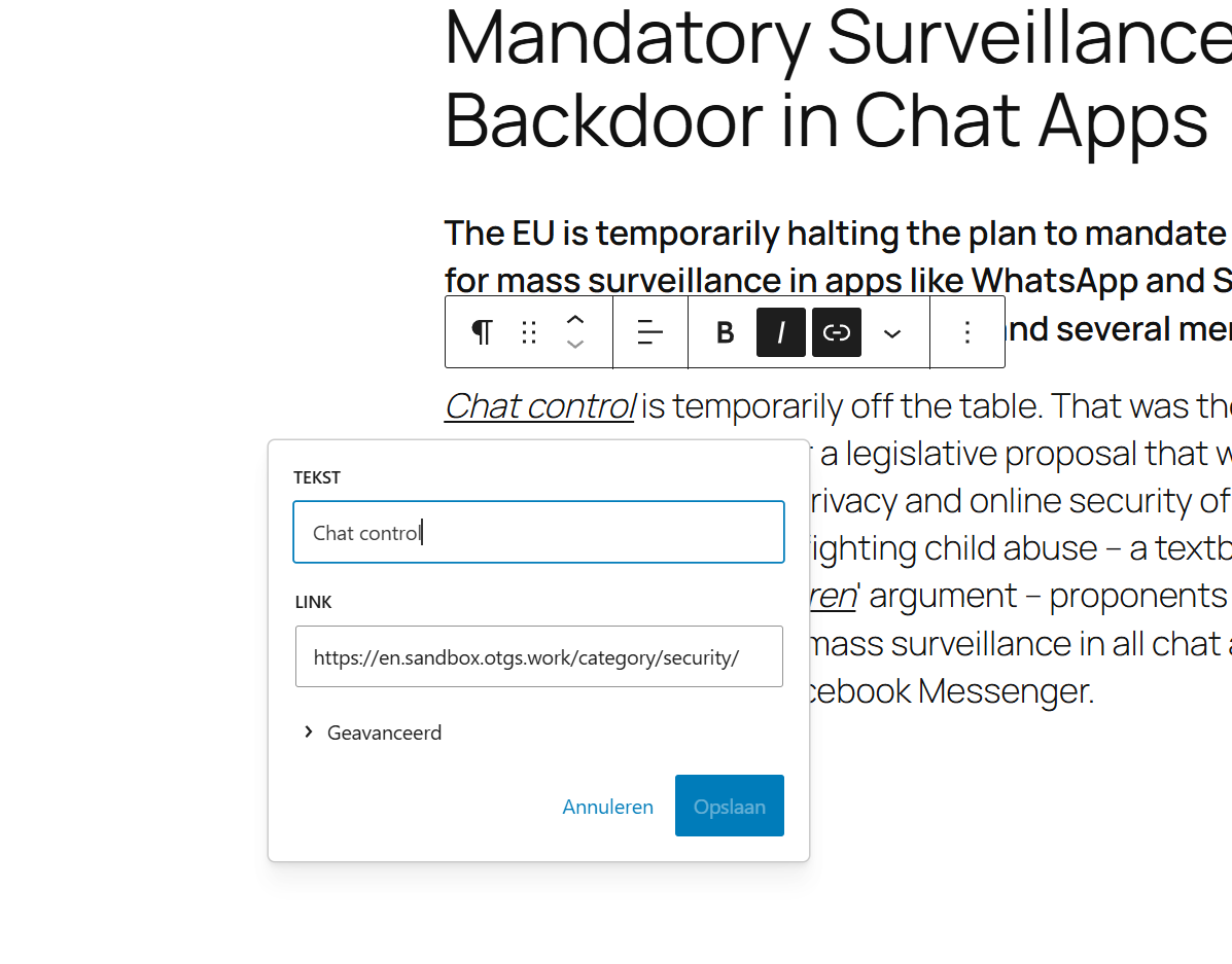

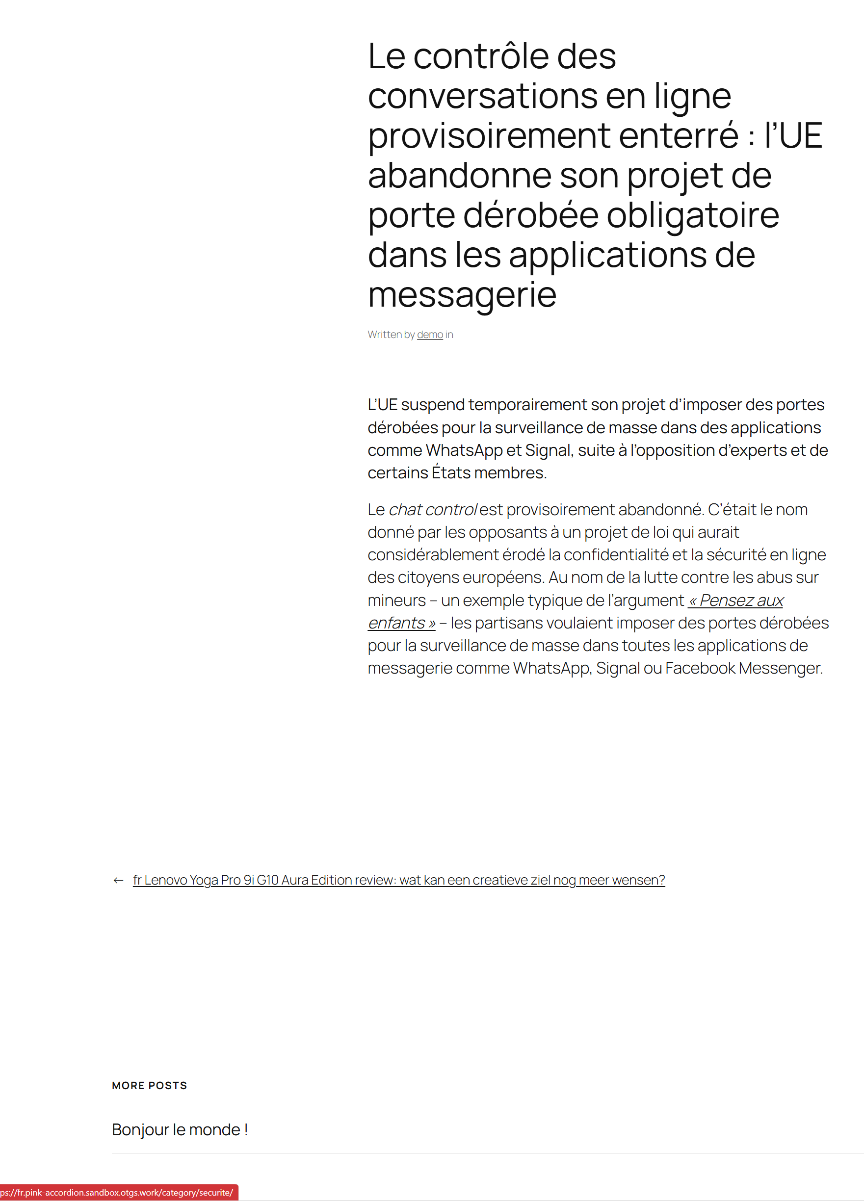

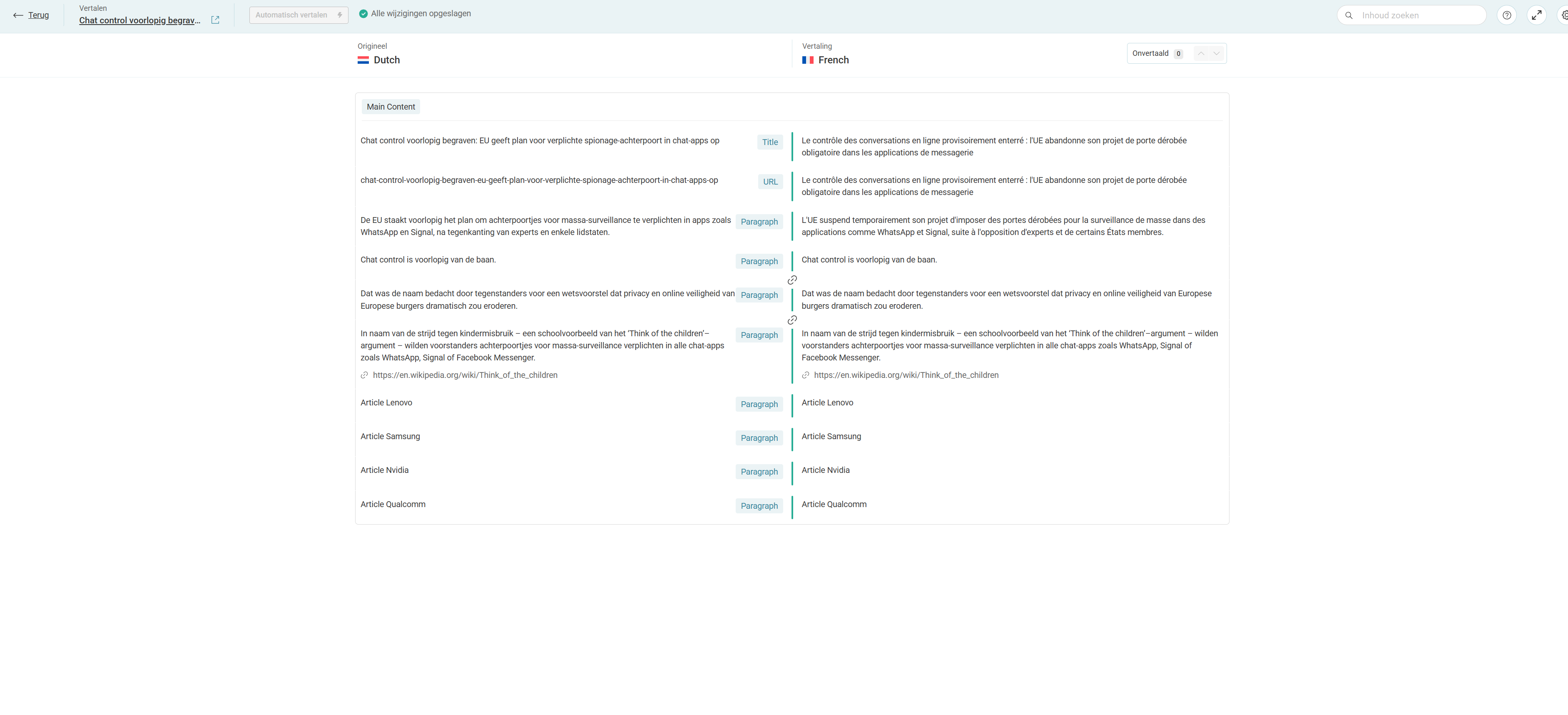

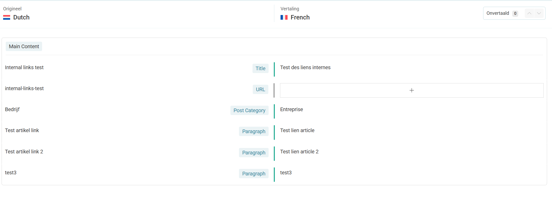

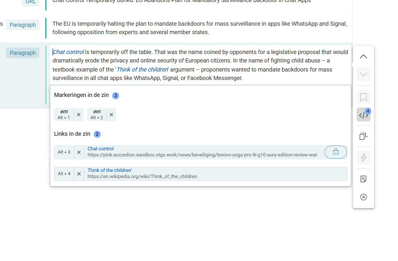

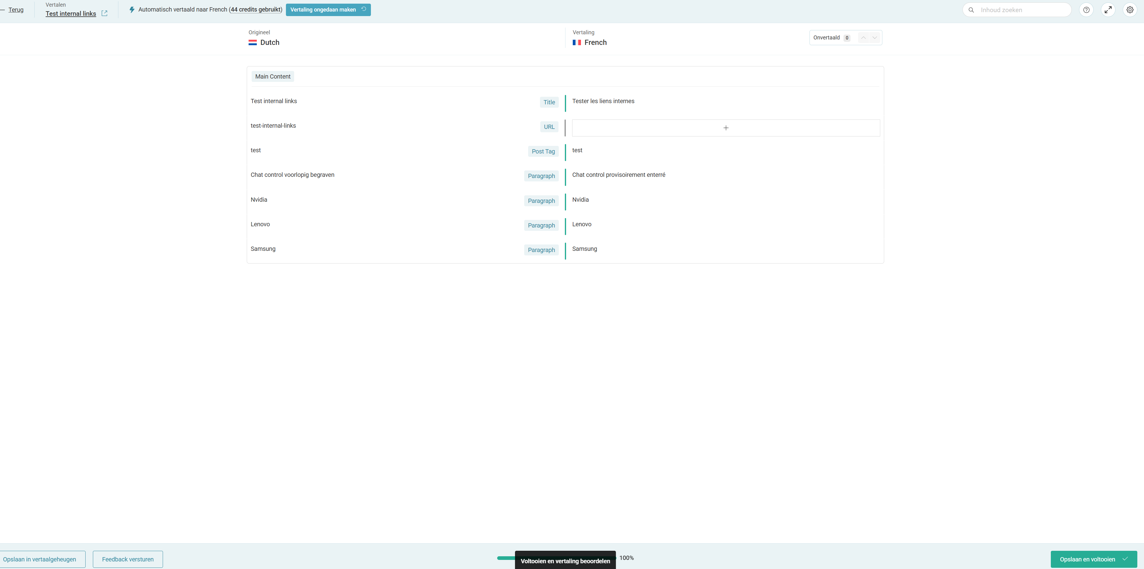

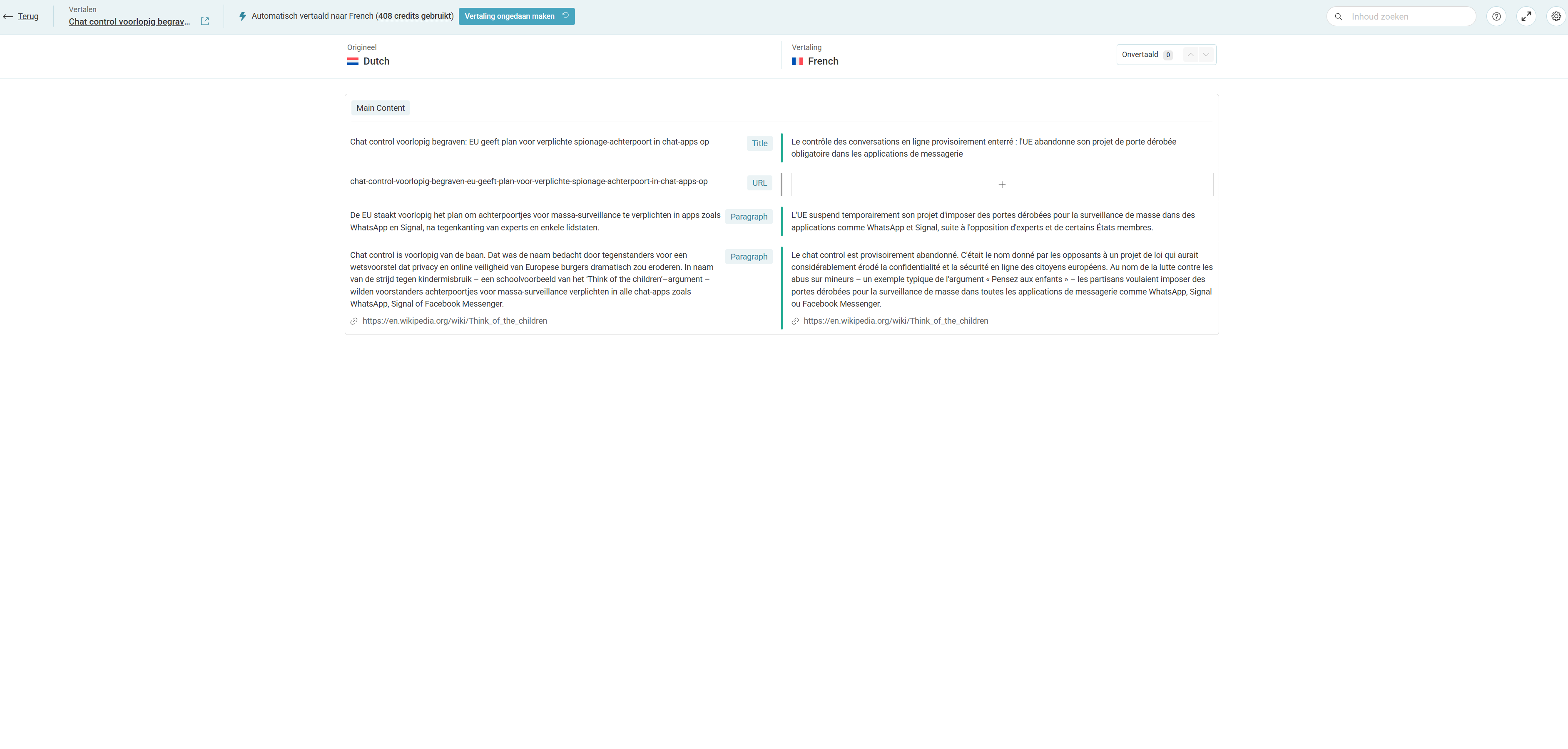

In that article, the phrase “Chat control” links internally to another news post. I then translated the article to English using the Advanced Translation Editor (screenshots 1 and 2). During automatic translation with PTC, the second URL field also remains empty; that’s another side note/bug. After saving the translation and opening the translated post (screenshot 3), the internal link no longer points to the translated target post but instead becomes a category URL.
I can’t show this on the frontend because the second domain doesn’t exist on the sandbox, but the incorrect link is clearly visible in the editor. From testing on the sandbox, this seems to happen only when WPML is set to use different domains per language. (it worked when it set to the default /en/)

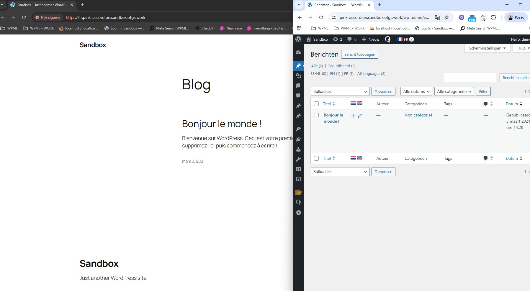

I’ve set the sandbox to use different domains per language now. You can reproduce and show me the issue directly there (screenshot/url of the frontend).
The secondary domain will be something like:
You’ll just need to bypass the browser warning about the non-secure (self-signed) certificate — once you accept that, it should work fine.

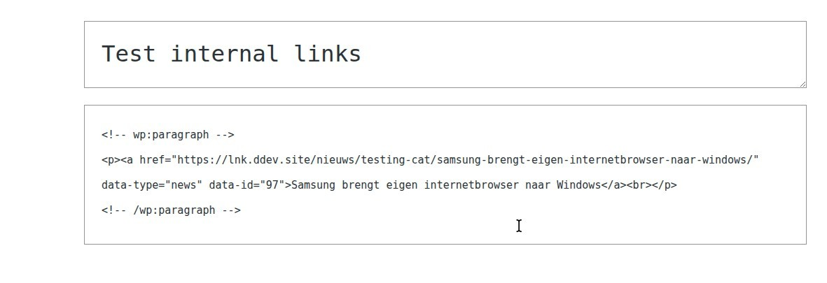

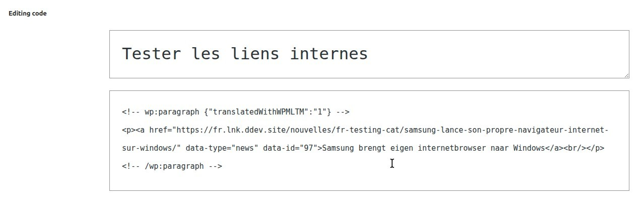

I've translated this post to french with PTC (screenshot wpml-4):
NL
FR
Now you can see the 'Chat Control' internal link in dutch:
has changed to this in french:
hidden link (screenshot wpml-5)
The article of Lenovo does exist in french, so it should link to that page.

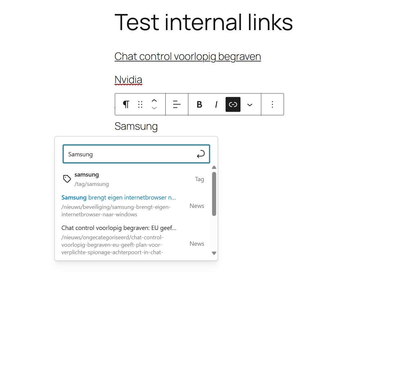

To make it more clear i've added 4 seperate internal links to an article. They are all translated and all link in french go to the category page.
NL
FR

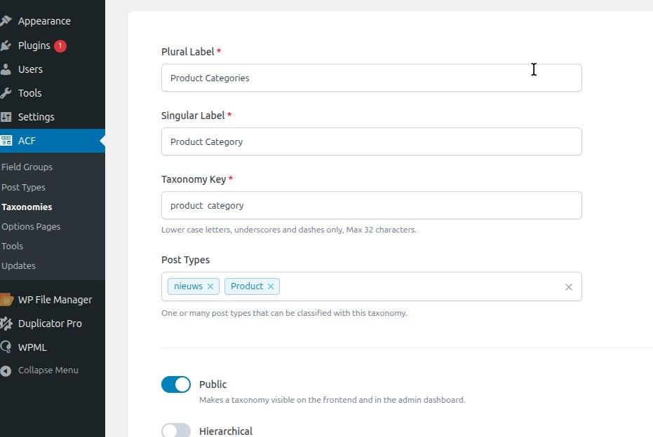

The issue with internal links not translating correctly happens because the post type was using WordPress’s default “category” taxonomy instead of a dedicated taxonomy. WPML handles custom taxonomies differently, so using a proper one ensures links translate automatically.
Here’s what to do:
1. Create a dedicated taxonomy
* Go to ACF → Taxonomies (or use your CPT UI plugin).
* Create a new taxonomy — for example:
* Plural label: Product Categories
* Singular label: Product Category
* Taxonomy key: product_category
* Under Post Types, assign it to both your custom post types:
* nieuws
* product

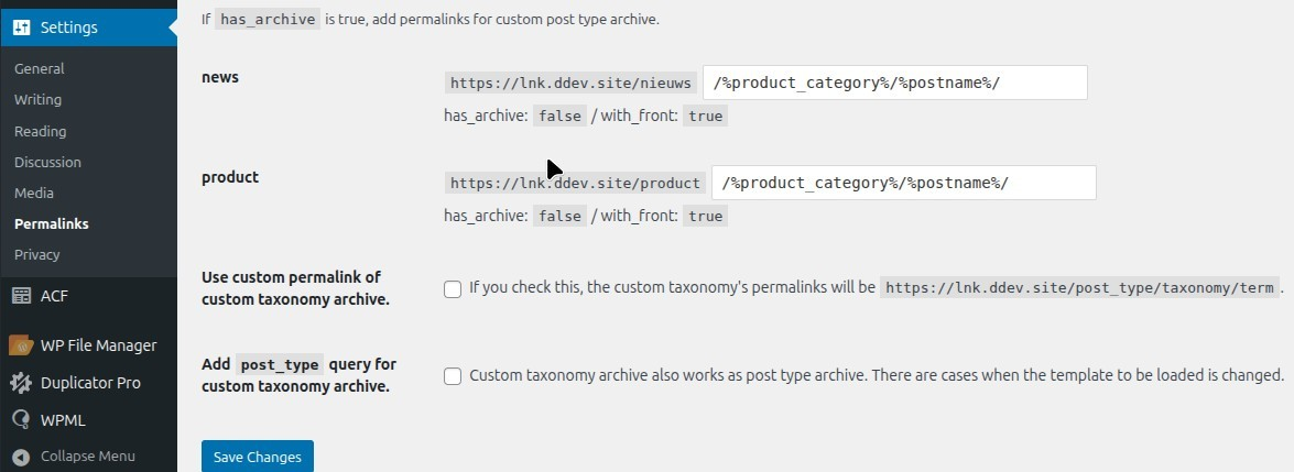

2. Set the correct rewrite rules
* Go to Settings → Permalinks.
* Make sure the structure for your post types looks like this:
* news: hidden link
* product: hidden link
* Set:
* has_archive → false
* with_front → true
* Save changes.

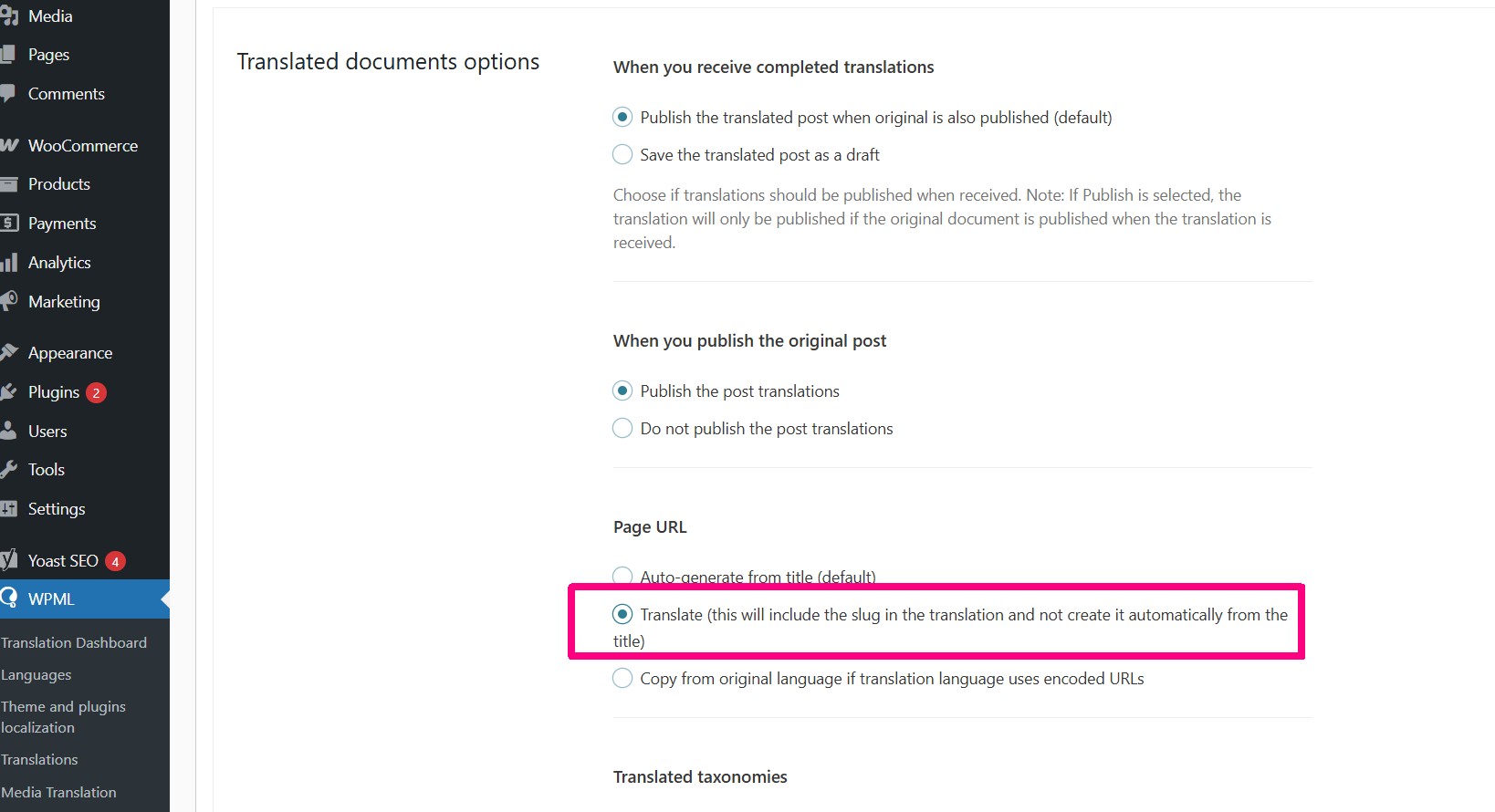

2) What could be the cause that the slug doesn't translate and we have to do this manually? It should be the same as the translated but each translation this stays empty. (screenshot)
November 5, 2025 at 8:40 am #17548672
cedricV-14
2) translated title*
November 5, 2025 at 10:10 am #17549135
Bruno Kos
You can try Scan now and adjust links, but perhaps it may not work as it would not not cover all the scenarios (let us know if this fails so we can check if there is perhaps a database workaround possible).
As for that second option, it would not be there automatically (the translation of the slug) and it only shows up in the translation editor when you choose "Translate (this will include the slug in the translation and not create it automatically from the title)" option in WPML -> Settings. Was your initial plan to translate these slugs, or?
