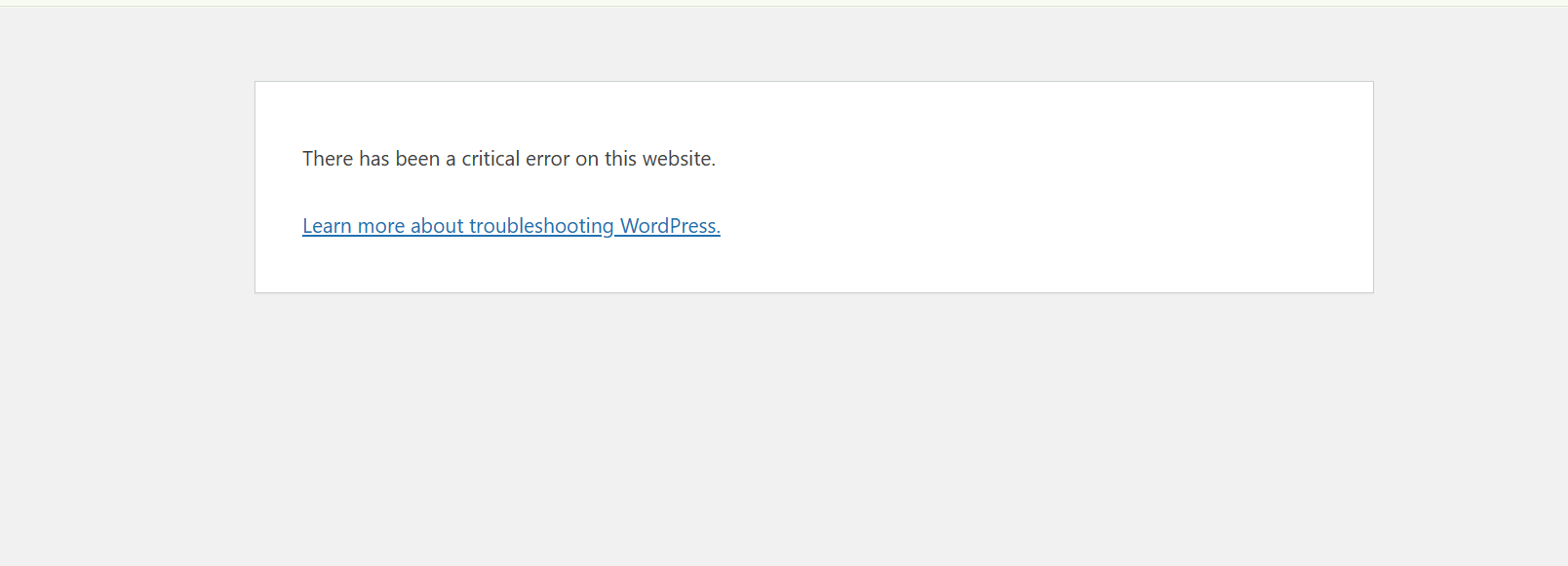

I am trying to activate the WPML plugin to enable language translation on our WordPress site at hidden link. This is essential for setting up a multilingual site.
Whenever I try to activate the WPML plugin, the site encounters a critical error and becomes inaccessible.
How can I resolve the critical error that occurs when activating the WPML plugin?
What steps should I follow to successfully activate WPML without causing a site error?

whenever i am activating string translation plugin i am still getting error when i went for arabic pages, if i deactivate the string tranlation plugin the arabic page will come

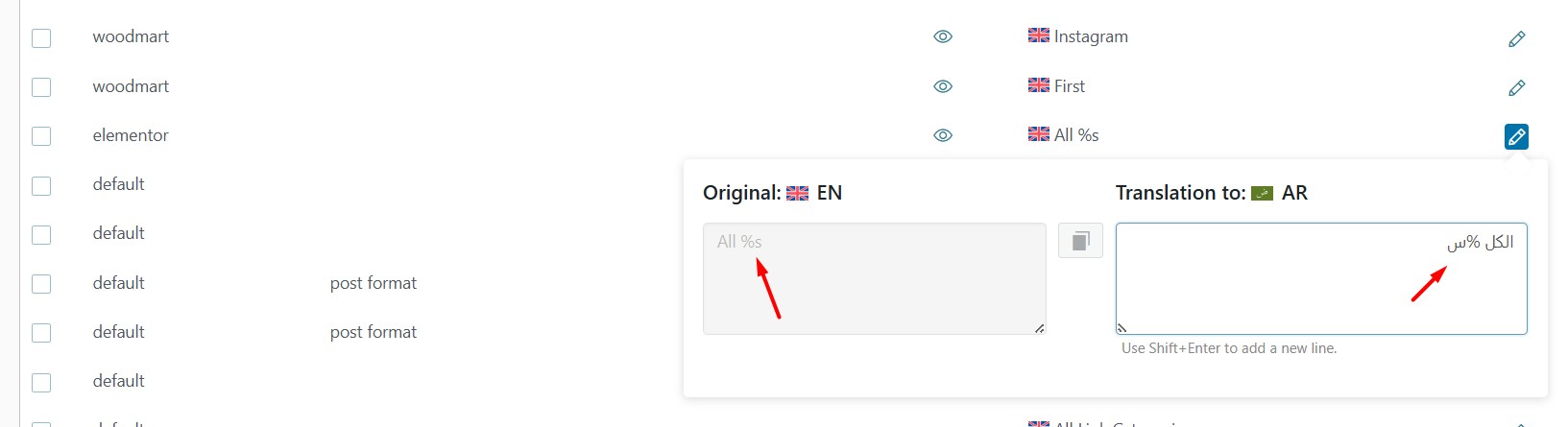

Thanks for providing the login details. This type of usually occur when placeholder(%s) string is translated somehow as mentioned here: https://wpml.org/errata/php-8-php-fatal-error-uncaught-valueerror-unknown-format-specifier-in/
To fix this issue, I followed the below steps:
1. Went to WPML >> String Translation.
2. Searched for %s string(screenshot attached).
3. Corrected its translation.
And now Arabic language pages are accessible without any issues. Could you please check and confirm?
Thank you for your cooperation and patience
