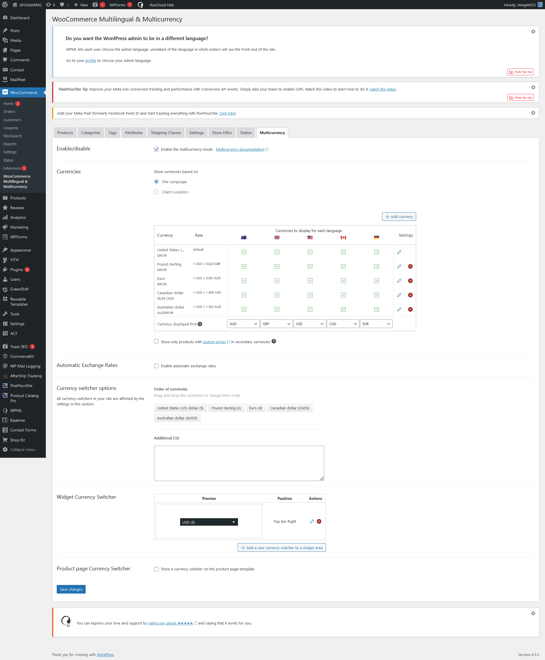

I use WooCommerce Multilingual & Multicurrency Plugin and WPML plugin together.

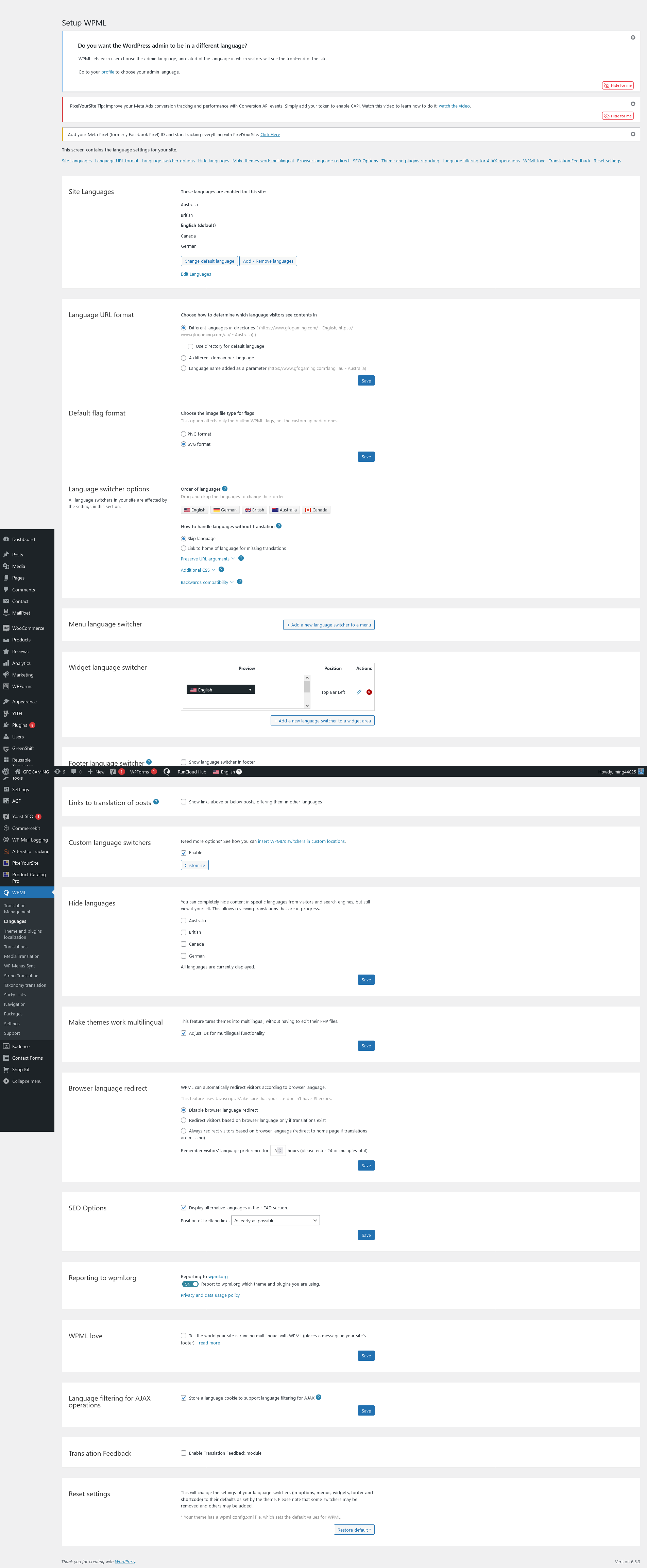

I set up the Multicurrency like setting in the attachment image, and set up the language switcher like the setting in the attachment image.

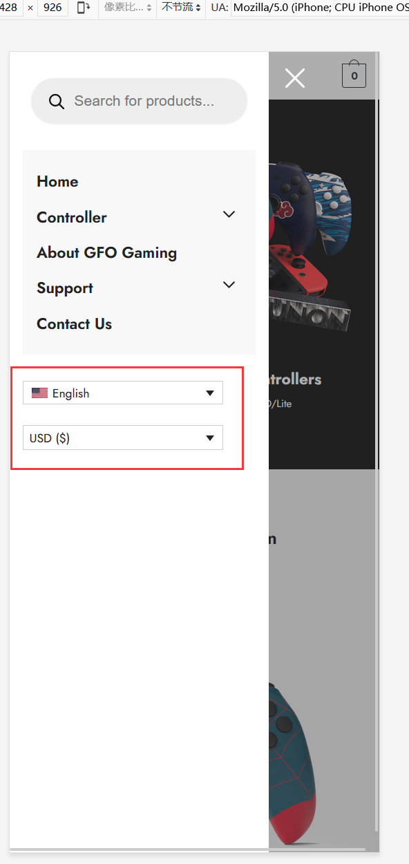

But now the Currency Switch doesn't work. Currency will change only when the language changes.
Does it work correctly?
In my mind, I set up all currencies available for each language, so I think the currency should be able to switch anytime, am I correct?

I also notice that when I login admin and access to the front end, the currency switch can work although I don't change the language, but when I log-out and access to the front end as guest, the currency switch doesn't work, currency only change when language changes.
