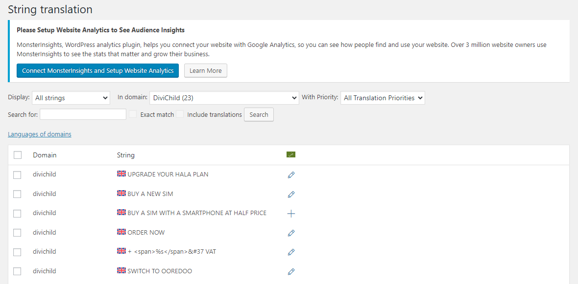

1) I tried to use a custom language file for English and Arabic by creating files inside child theme language folder. But it is not fetching the language file. The text domain is 'divichild' and file name is 'divichild-ar.po'. Attaching the screenshot also.
2) Is it possible to add translation in .po file without file line number.
3) I have exported the .po file from string translation option in WPML and added some text, but it is not reflecting in frontend.

We have QA and Pre-prod environments, I have updated all the translations via string translation option in WPML. I have exported the translations as .po file and imported into Pre-prod environment but it is not importing anything from the file and I'm not getting any errors. Please find the attached screenshots Please support.

difficult for me to say what happens or go wrong, make sure to select to include translations in the website where you are exporting them.
If would be helpful if you could please share a video of the process, so I can see what string you are exporting, then importing, and what string does not get translation imported.
