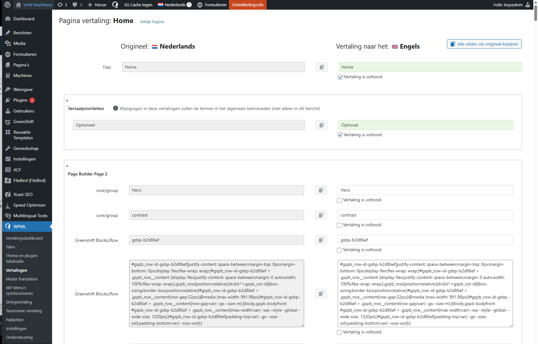

* There are now a lot of unnescessary lines in the translation editor, which makes it hard to translate the real strings to be translated. Please check attachment
* it's so strange, every link, from page links to taxonomyu links, are translated properly, except for the post type archive. In our case /machines
September 4, 2025 at 8:16 am #17373677
Indeed, I still needed to adjust the XML config.
Could you please give it another test now on the staging?
1) Edit the original page or template and save it again
2) Open the translation editor and complete the translation
Note that our support is not responsible for creating the XML configuration. Those issues should be reported to Greenshift.
