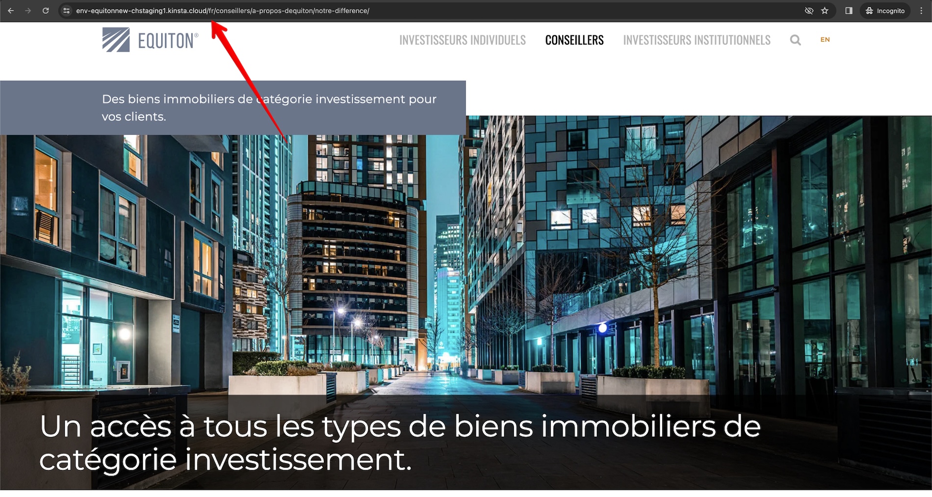

March 12, 2024 at 3:46 pm #15400475
cathyM-3
Hi Long
I am still having issues with this process.
Here are the steps i took - i am doing all of this on the staging site so i am going to post staging URL's.
This is our staging site
Before updating the domain on the language section of WPML the FR URLs looked like this
I have set a staging domain for the French Site
I have run a search and replace to search for
hidden link and replace with hidden link
I have saved the permalinks but not all of them get updated. Some pages still have the old url. The result is that the layout is also broken - see example page
Also on the language switcher on the top right - if i go back to EN it does not take me back to the FR page. If you want to see the backend, please don't make edits on the existing access. I have a new staging site, specific to testing this. I can provide access if required.
March 13, 2024 at 2:35 am #15401857
Long Nguyen
WPML Supporter since 02/2022
I don't see the different domains per language enabled on the new staging site, because when I switch to French language, the URL shows the directory /fr/
I can switch back and forth to English, French language on this page without any issues. Please enable the option different domains per language on this site, share a screen record of the issue on your end and let me know "Some pages still have the old url".
If you are testing on another site, please share the credentials of that site in your next reply.
Thanks.
