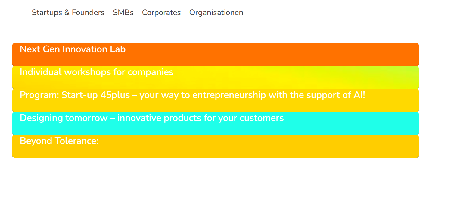

Additional info:
I changed bit on the home page in German - seems it got translated again.
First hours after translation instead of boxes there are stripes shown - see attachment
After some time it changes back to boxes
I've seen this already before.

Hello There,
I understand the issue you're having with the Blog layout and will try my best to assist you in this matter.
It appears that the custom CSS used in the German version to display the blog layout in a grid hasn't been copied to the English version. This is why the layout isn't rendering correctly. Please check this screenshot: hidden link
To address the problem, please apply the CSS code to the English version of the site as well. You can target the English language specifically using the language selector property in the CSS. For example, please take a look at the following CSS code:
 html[lang="en-US"] .blog-layouts-36 .et_pb_posts > div {
    display: grid;
    grid-gap: 20px;
    grid-template-columns: repeat(12, 1fr);
    grid-template-rows: repeat(15, minmax(75px, 1fr));
I hope the issue will be solved right after adding the CSS for the English version of the site.
Please be informed that providing custom code support is beyond the scope of our support. I shared the CSS for demonstration purposes. If you need help/support with custom code, you can hire a from here: https://wpml.org/contractors/
Feel free to let me know if you need any further assistance. I will be happy to help.
