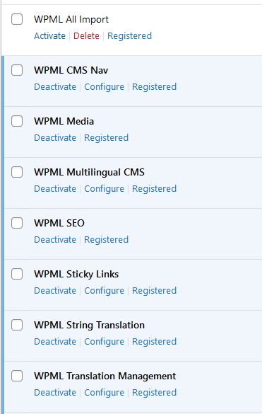

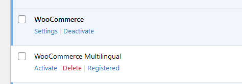

June 19, 2021 at 8:54 am #9030267
donaldc-5
see attached for info
