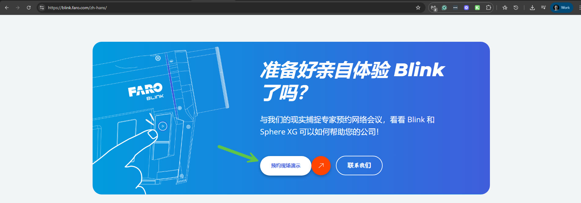

I am trying to translate a split test CTA button text on a Header layout using WPML on my site hidden link.
The Divi header layout translation is not working.
The text on Chinese did not translated. It still showing on English.

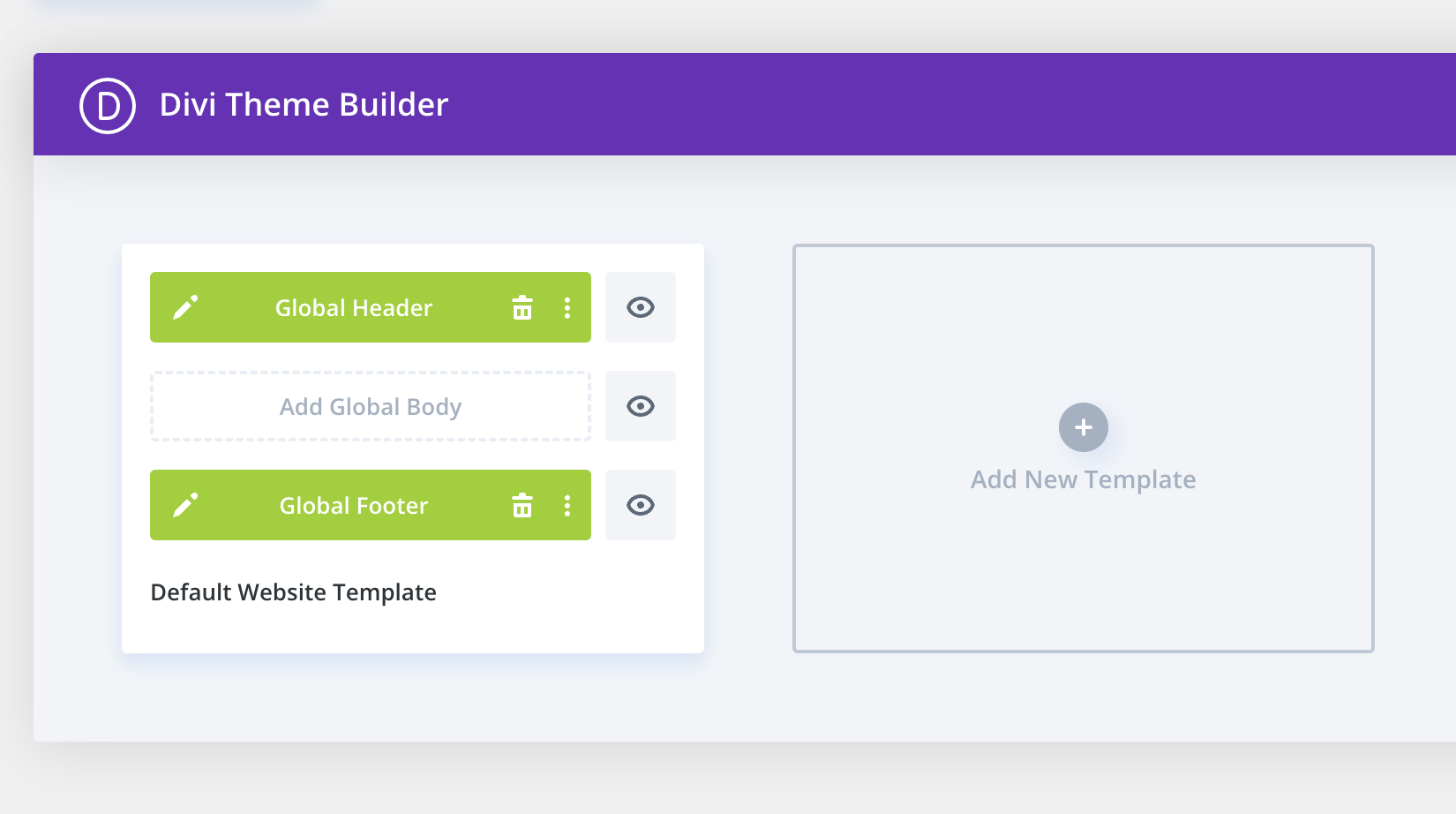

First, there is an issue with the client site, as when you navigate to Divi > Theme Builder, you will only see the Global Header and Global Footer layouts. Please see the attached screenshot global-layout.png.
However, upon checking the database, wp_posts includes multiple et_header_layout and et_footer_layout posts that are not displaying on the Divi > Theme Builder page.

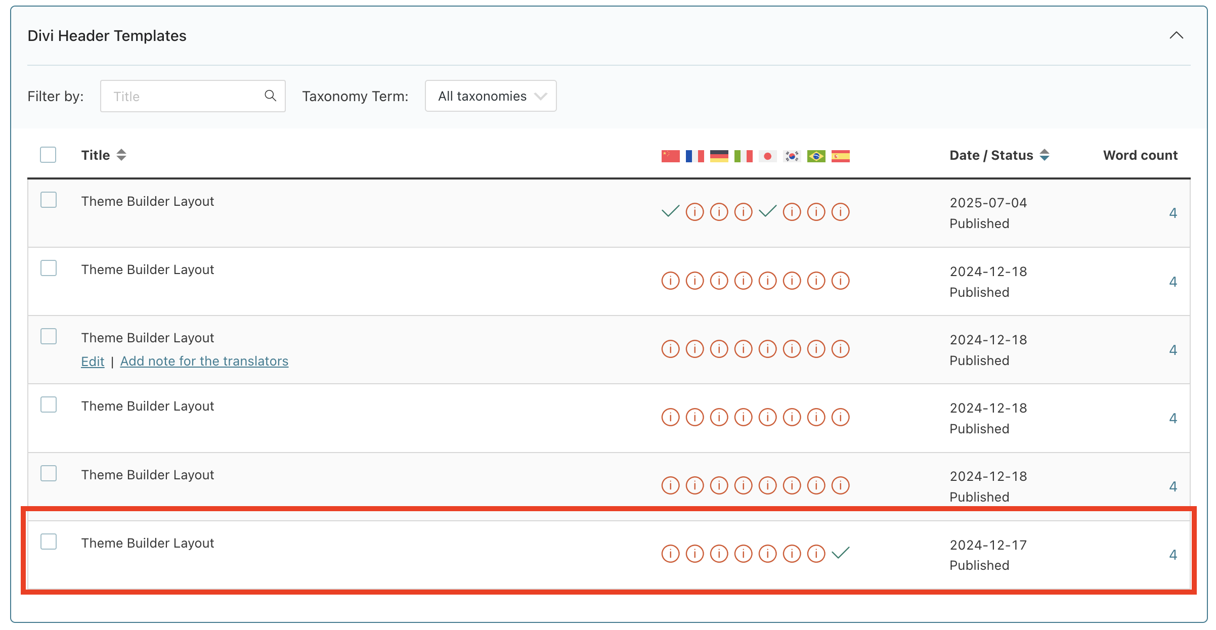

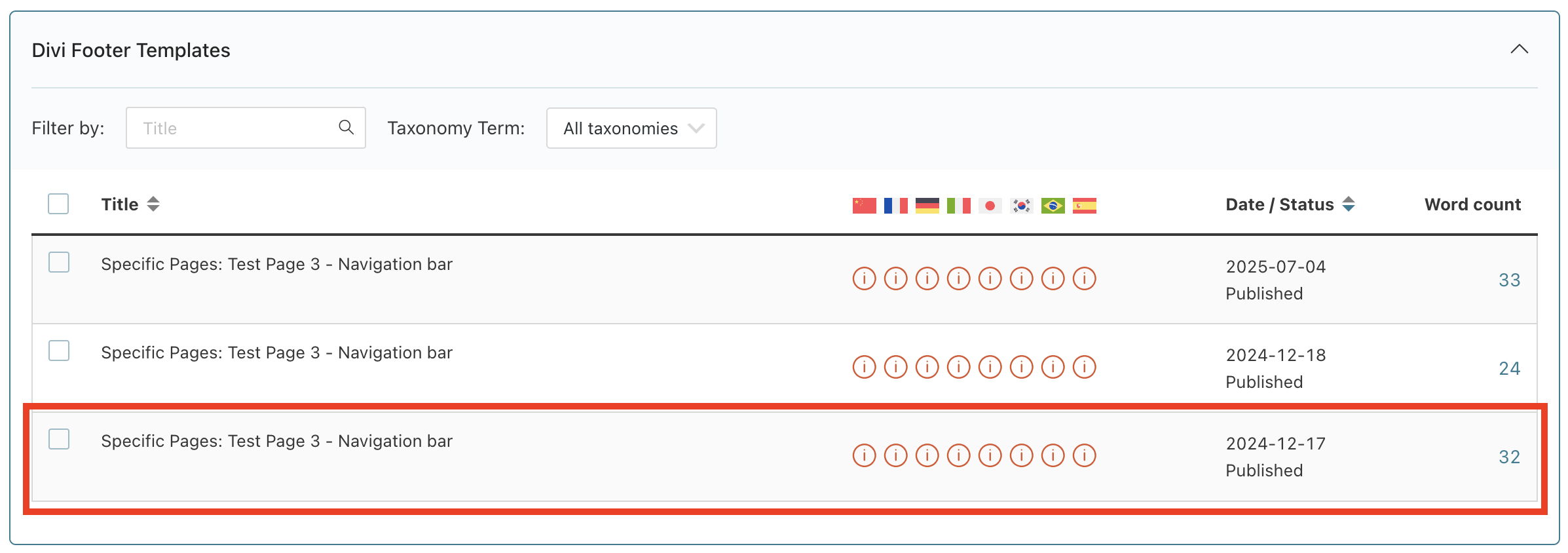

I suggest that the client delete them from the database because they appear to be corrupted and are likely not in use. (Please double check this.) The post IDs of the ghost header layouts are: 4957, 135, 134, 132, 130. The IDs of the ghost footer layouts are 4958, 131.
The actual header and footer layouts have IDs 29 and 30 respectively.

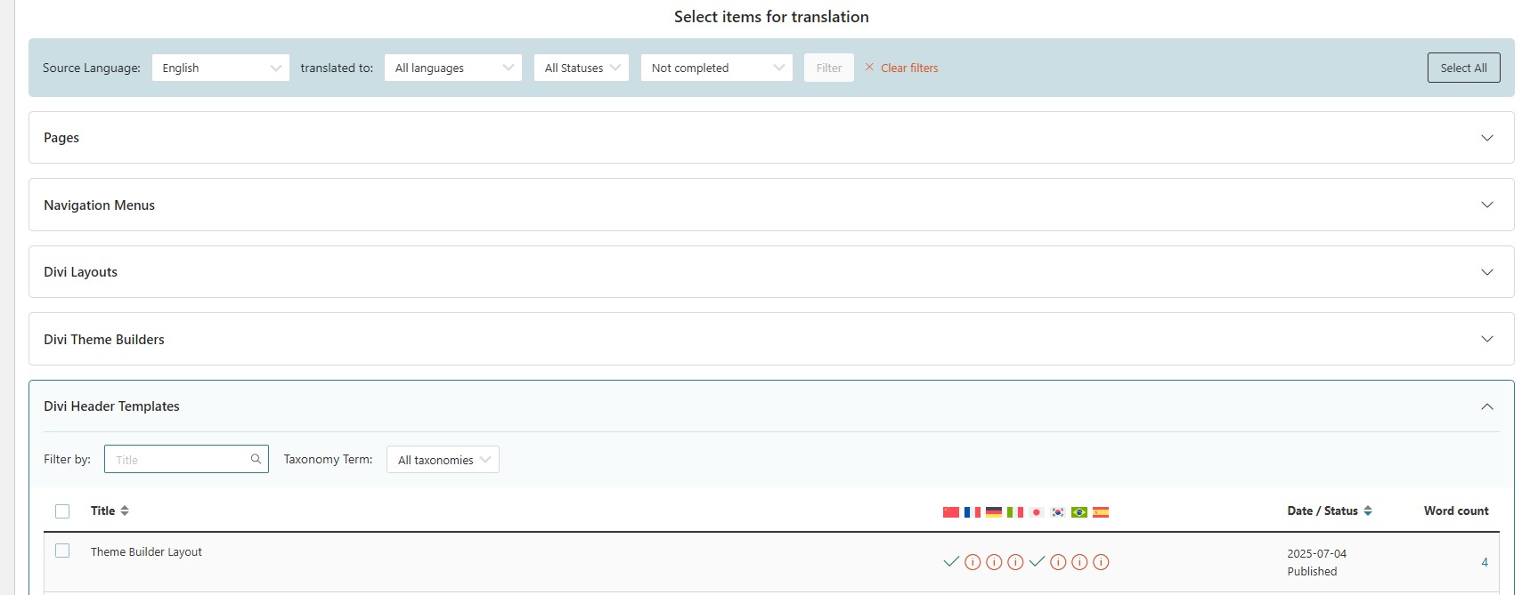

From the Translation Management page, hovering over the edit links confirms which ones actually work and need translation. Please see the attached screenshot divi-header-template.png and divi-footer-template.png.
Translating other templates won't have any effect because they are not in use.
You can see in the screenshot of the Header templates that I have translated that one to Spanish.

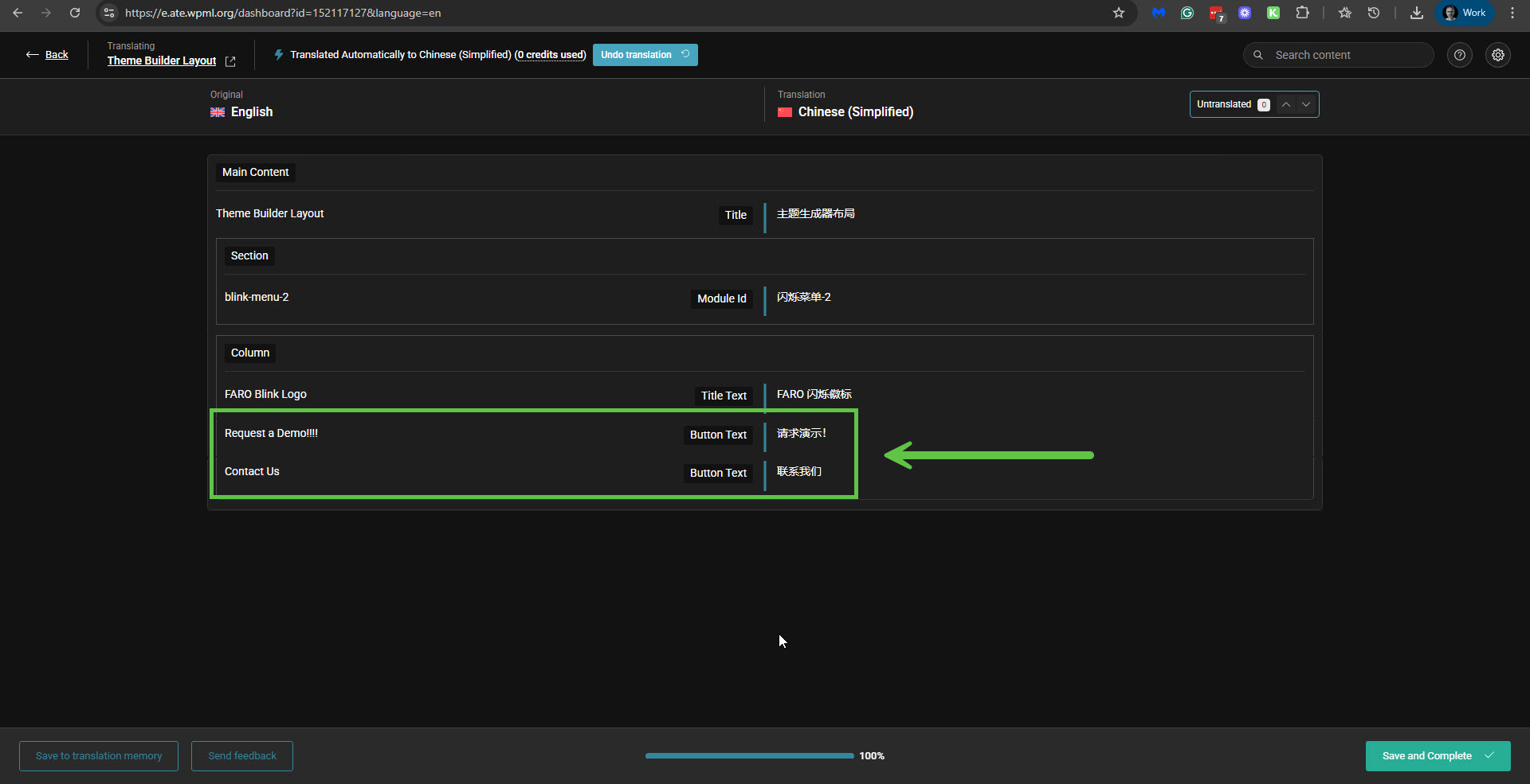

In summary: You must translate the correct header template (with ID 29), and you will have the option to translate the CTA button text: "REQUEST A DEMO" and "CONTACT US". Please see the attached screenshot ok-in-ate.jpg.
