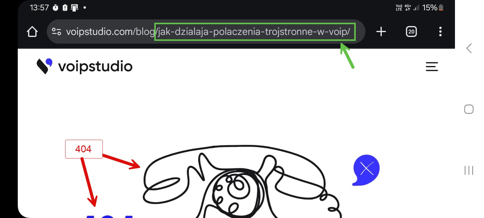

This is not the case on my end. I still get a 404 for the above link as well as for the two other examples you provided:
1. hidden link
2. hidden link
To ensure it wasn't just my IP address, I cleared my cookies and checked it on my cellular phone using the cellular network (a different IP address). Also, in this case, I get a 404 page. Please see the attached screenshot 404.jpeg. As far as I can tell, your site's DNS configuration is still the same as when we chatted.

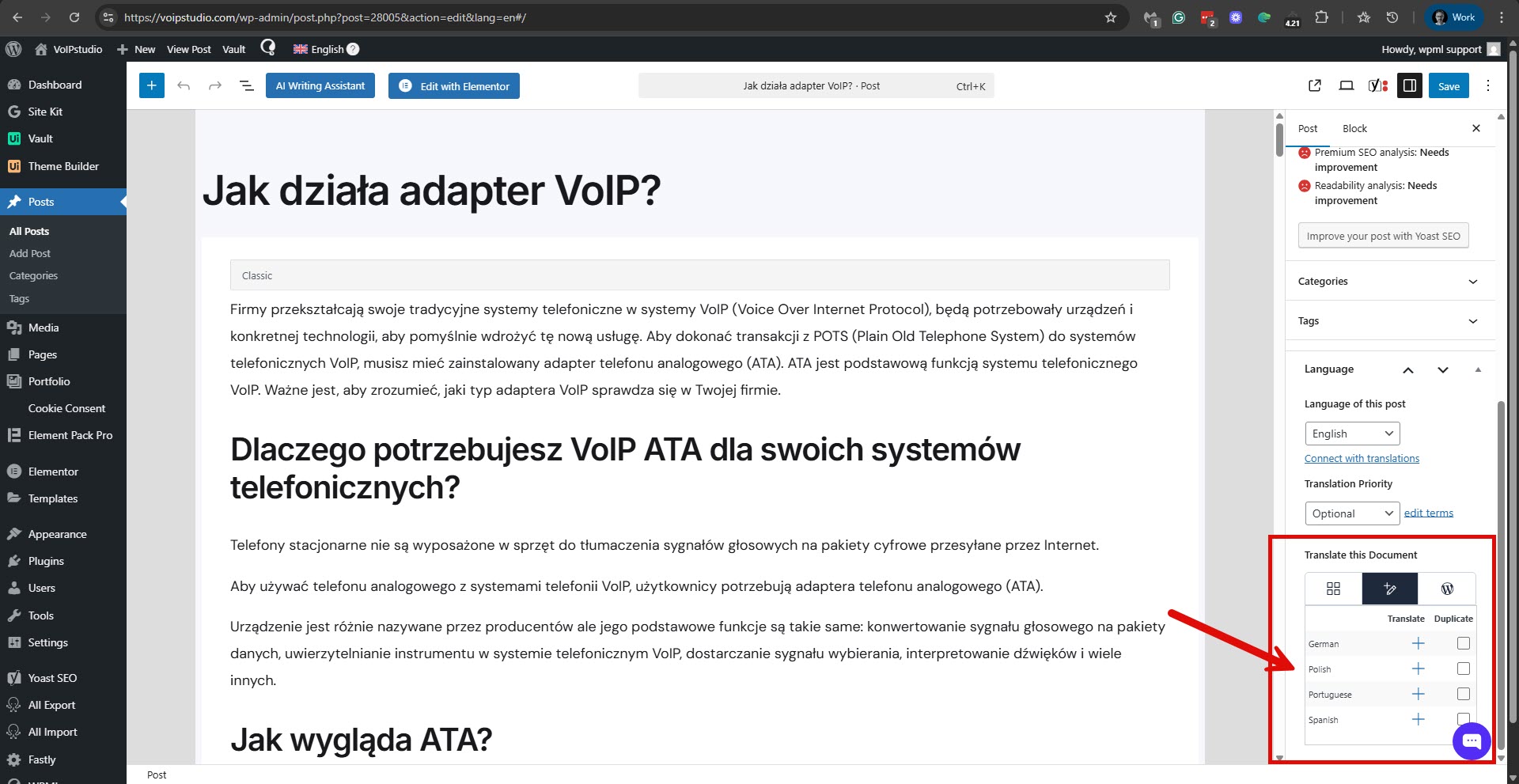

Furthermore, I can find the editing screens for the above examples on your site when I check them against a copy of your site on my local server. In the same order as above, please use the links below to get to those posts.
1. hidden link
2. hidden link
Please note that these are standalone posts in English. They do not have translations into any of the languages. Please see the attached screenshot no-trans.jpg. So if this is the case, you are safe to delete them.
